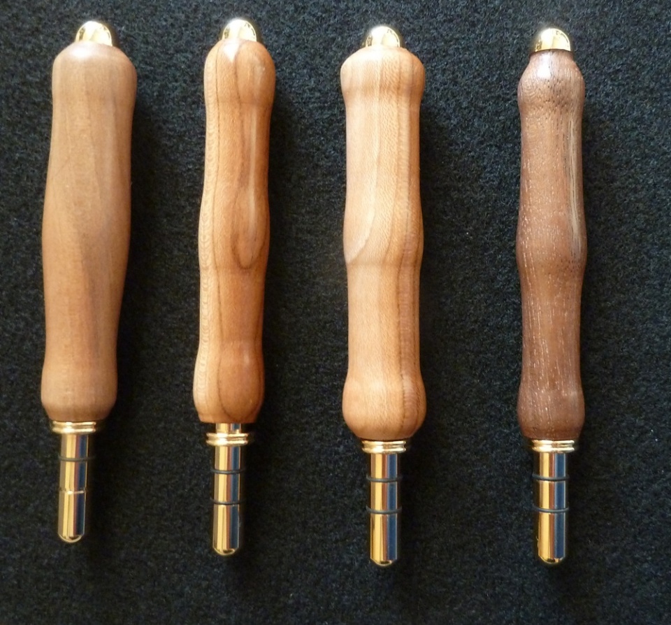

Here's the results of the kits with "o" rings. I'm not real happy with the results and 1 o-ring broke. It was difficult for me to slide them from the brass tube onto the blade holder. I'm going back to the other type if I do anymore.

Those rippers all sold at our annual church boutique. I tried a double ended one that uses the spring clip, from PSI. I like that style better than the o rings. PSI does sell replacement knife assemblies.
