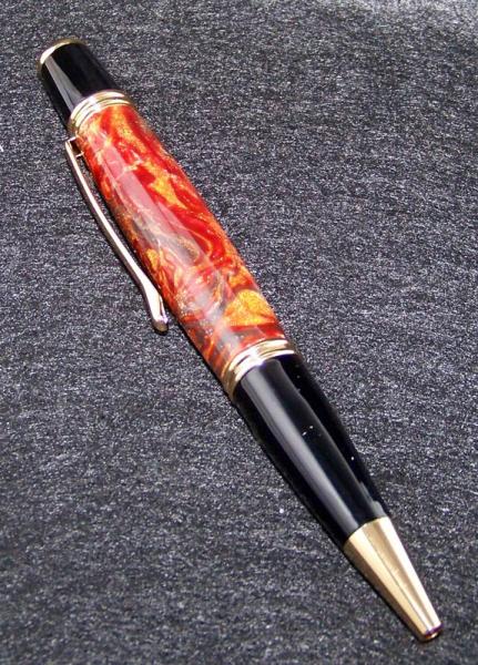

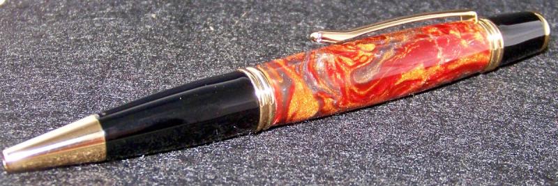

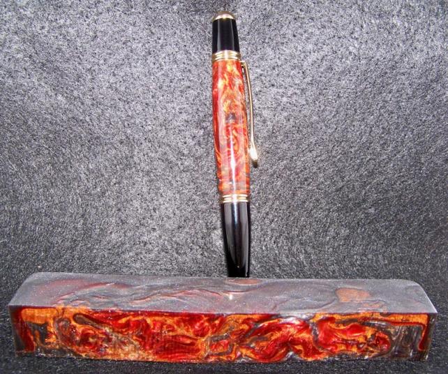

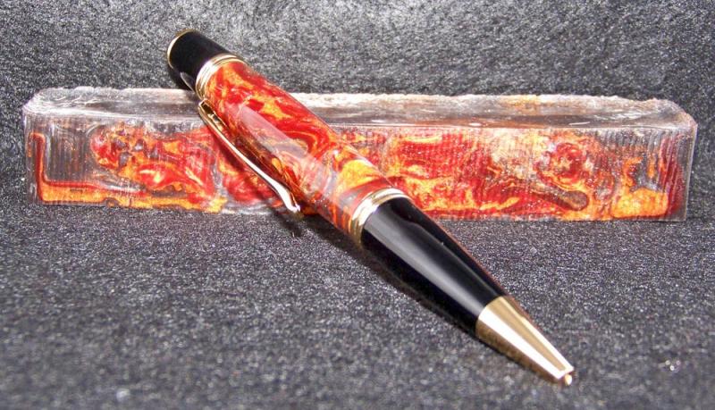

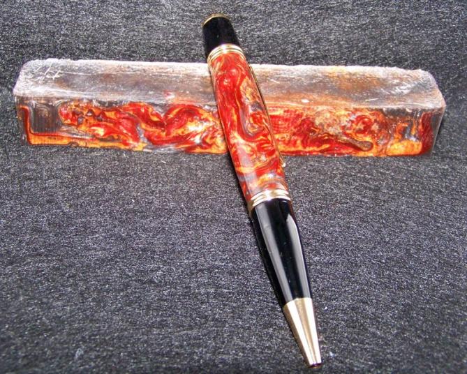

Another recent cast I did. Working on the flame look. I'm happy with what turned out :wink:. Put this one on a Gatsby, MM 12000, buffed with tripoli and white diamond, PlastX polish, and a coat of Ren wax. As always any comments/questions appreciated!

Thanks everyone! I'm excited that my work is being shown some love :biggrin:. The resin I'm using is the Castin' Craft PR that you can find at hobby stores. I'm looking into switching to simlar 41 bc I'm thinking of doing bigger groups of casting to put into the classifieds and the price per gallon is much better. Again, thank you to everyone for the kind words on not only my blanks, but my pens as well!

That darn thing looks like the inside of a volcano!! Great work.
