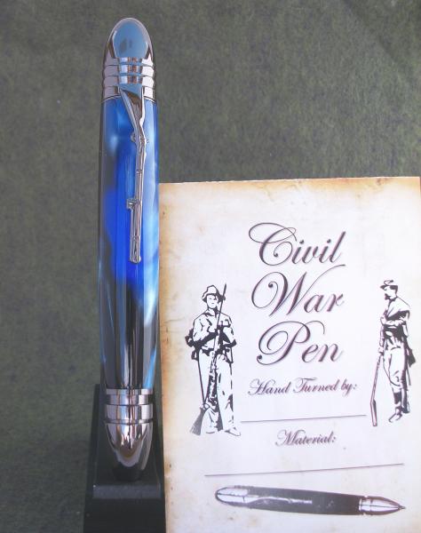

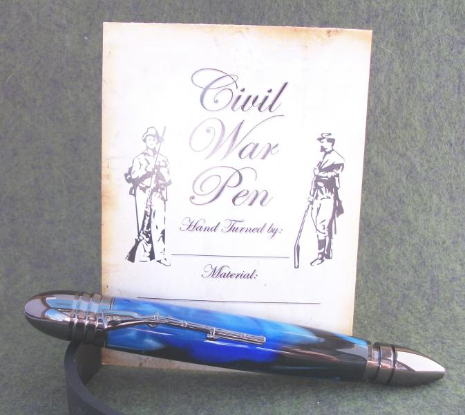

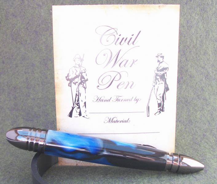

This is PSI's new Civil War Pen, The cap end is a "58 Caliber Minie' Ball" replica. The tip is a "44 Caliber 1860 Colt Army Revolver Bullet" replica. The clip a "Model 1861 Springfield Rifle Musket". The plating is Black Ti and the blank is Black/Blue PR it has been wet sanded to 1500 and MM to 12k and finished with plastic polish. This is for my brothers birthday on the 23rd, he loves firearms and black powder shooting. :biggrin:

It was straight forward Super Easy If you have ever done a Polaris it is pretty much the same kit. It takes a 3/8 drill bit, but it is a long blank to drill just go slow and clear chips a lot. I drilled mine on the lathe.:biggrin::biggrin:

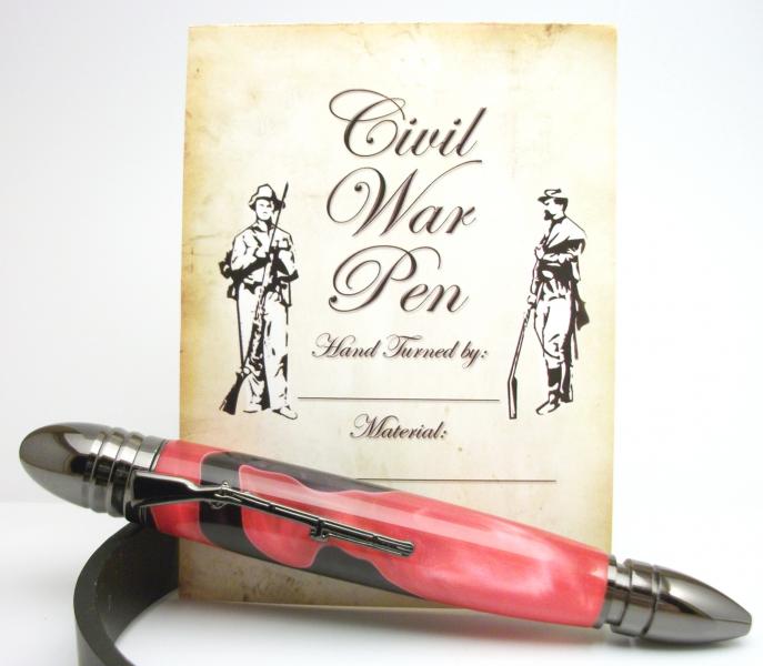

So, are you going to cast a red/gray blank for the southern folks? :)
I think I have a couple of red/grey blanks from Jeff in Indiana that I got in a swap... soon as it warms up (I'm a wuss about cold:rolleyes:), have to go out to the shop and check... might have to try one of those.
Funny you mention that, That is what I was looking for first but did not have one only had red a green. But I have another kit for some casting.:rolleyes:
