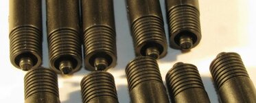

As they say, "A picture or ten is worth a thousand words", so I will endeavor to do that.
The short version: how does a 40 tpi screw fit into a 28 tpi nut? Or, in this case, front section housing?

I'm not trying to "nitpick" your words, Roy, I knew what you meant.
Here is the problem: You were in the auto industry, what happens when you take a national coarse nut and try to insert a National fine bolt thread?
It destroys the fine thread, if you force it, and it leaves "crud" in the coarse nut threads!!
I think the picture is easily interpreted:

Try taking your rollerball converters out of the holders and see what they ACTUALLY look like.
You mean like this.
Brand new one on the left, one that I have shown in the photo above on the right. Sorry the photo took so long, these hold a lot of ink and had to flush it out to keep from making a mess.:eek:
Sorry "Mate" but I fail to see the torn threads as you so improperly suggest.

well mike, you did not convince me here.
the pics are so out of focus here that the quality of the threads is not visible.
And if you are able to cross thread two different types of thread like this and not have them be buggered up without using an actual thread chaser or tap, then you should patent your process because it would make conventional fastening systems obsolete.
Sorry mike, but I have to say something does not jive with those pics, at least as how they can be seen.
btw, did you wet down the threads to make them appear to be shiny and clean?
They are bone dry. As stated in the previous post the one that has been being used on a daily basis had to be flushed out to keep it from leaving ink all over our photo stand and set up. If you must know after cleaning the converter out it was sat on the counter while we let our dogs out - each one at a time for about 5 minutes or so a piece. Then each of them got a good toweling off since we are getting thunderstorms here in Indy. They love a good toweling and since they are quite big that took a few minutes each. Grabbed fresh sodas, took a phone call from one of our kids and then came back up to take the photos.
Set the new one to the left and mine to the right. I'm pretty certain that you can see the lint pieces on mine, while the one on the LEFT is nice and shiny and clean - as you put it. I'm not a professional photographer by any means but the photos look pretty good on this side, can't do much to improve them on your end.
The threads are in great shape and I've had this in and out of my pen several times. I have done nothing additional to this piece to make it work in my pen - I simply screwed it into the pen and it worked.
As far as the rest of this comment, I have no need to respond to it. You can either believe me or not - that is your choice. I am simply stating what is working for us. Apparently these are also working for a great many other people as well. As Richard Greenwald wrote in his very detailed note about this product - which he reports he has been selling for years - these do work in the Jr. series pen kits. As Roy stated it is working in his pen .. These are two other individuals who have stated THIS WORKS -
Additionally, we have sold a couple hundred of these since we got them in about three weeks ago and have not had any serious issues reported with them. The one person who wrote us asking about having any difficulty had a Jr. kit that had "burrs in the metal threads of their Jr. kit" which was NOT a CSUSA kit. We believe that was probably causing the difficulty that person was having.
There is really no need to respond to my post - I believe I have answered everything you asked me to, I have posted photos showing that there is NO damage to the unit. My suggestion at this point is that you give it an honest try for yourself and see how it works. Experience is often the best teacher.

Someone pm'd me and asked that I look at the Jr. Gents we have in stock. I did pull ten at random and take out the nib. All those nibs were the same, shown below.
