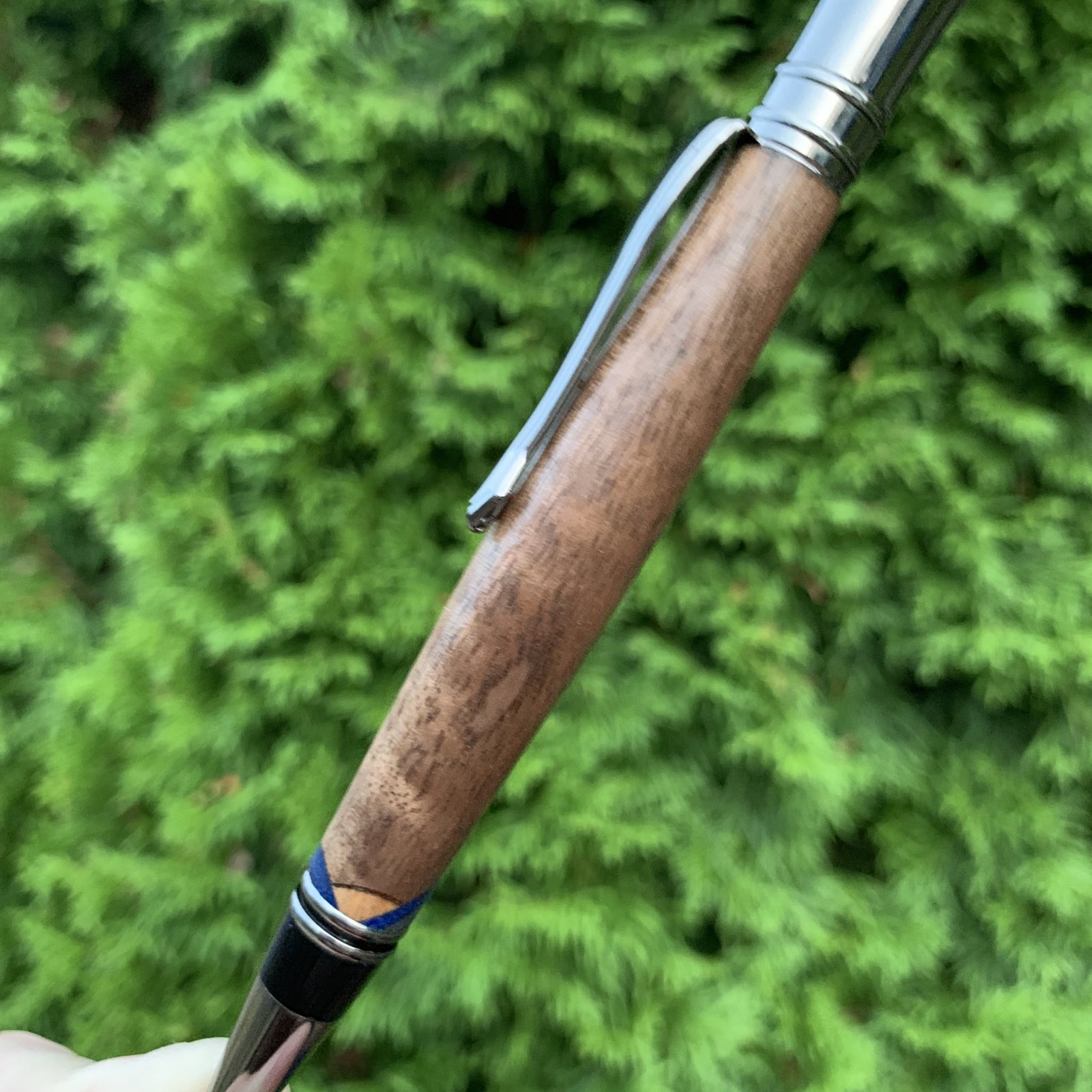

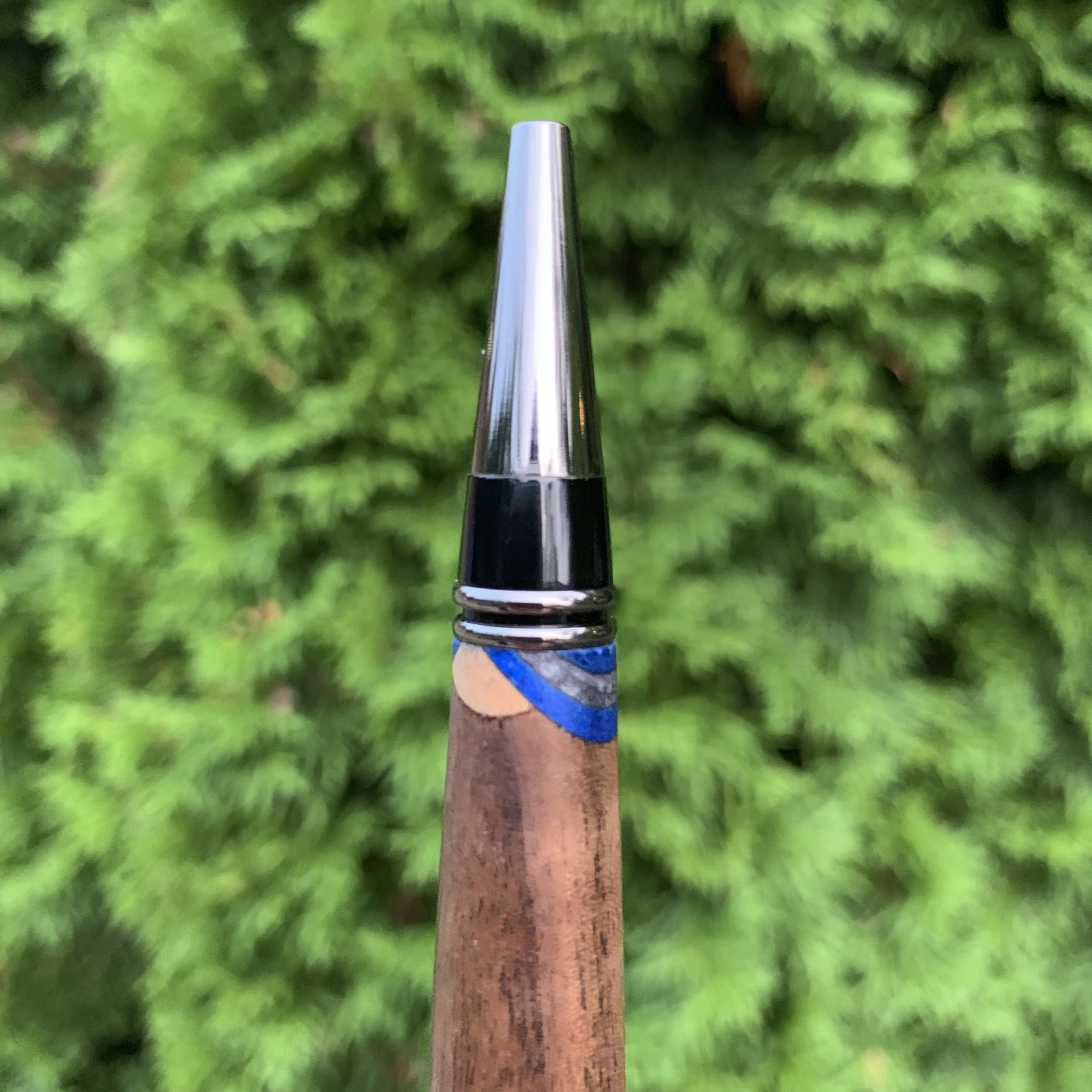

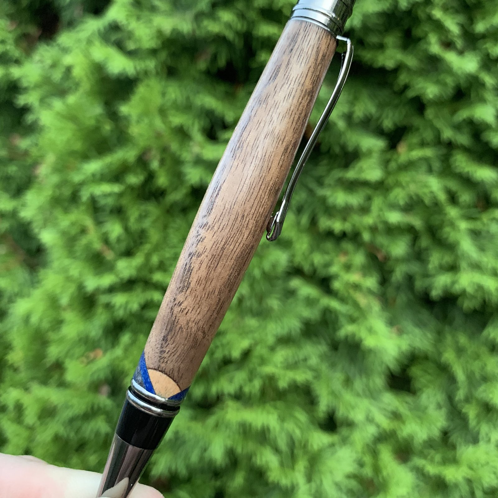

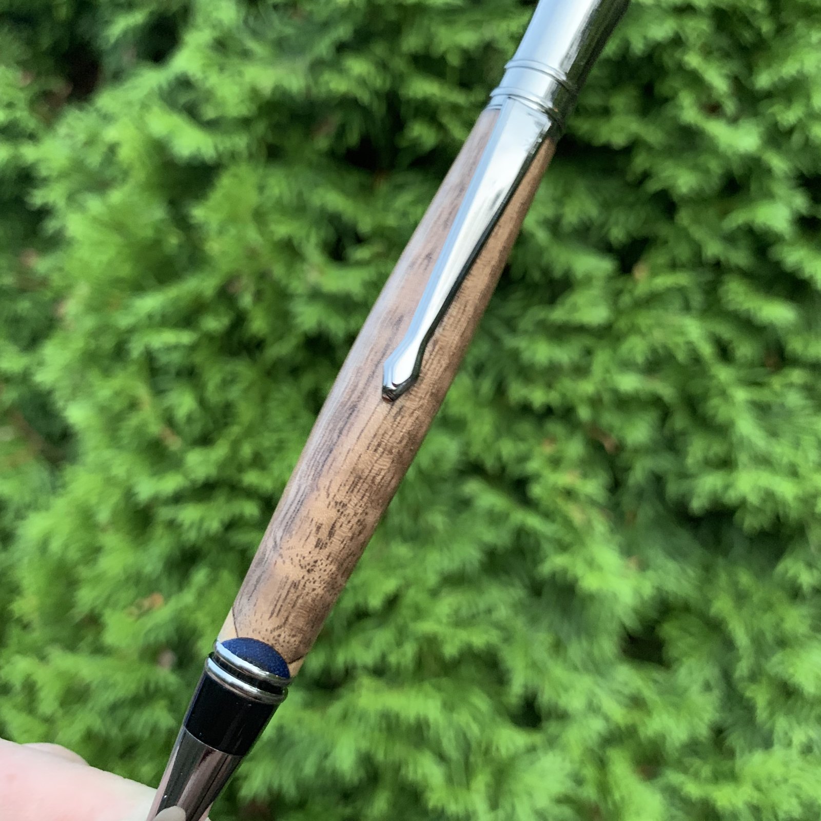

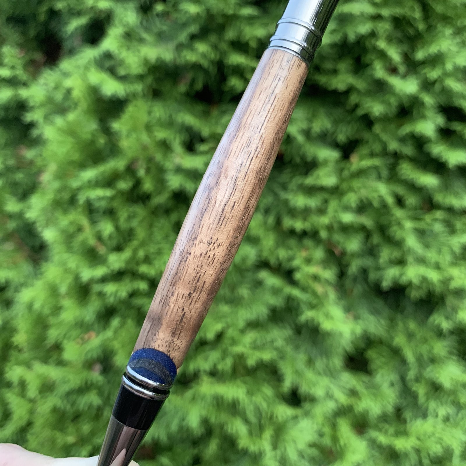

This is my first attempt at a scalloped blank. I need to find a way to make more precise cuts.

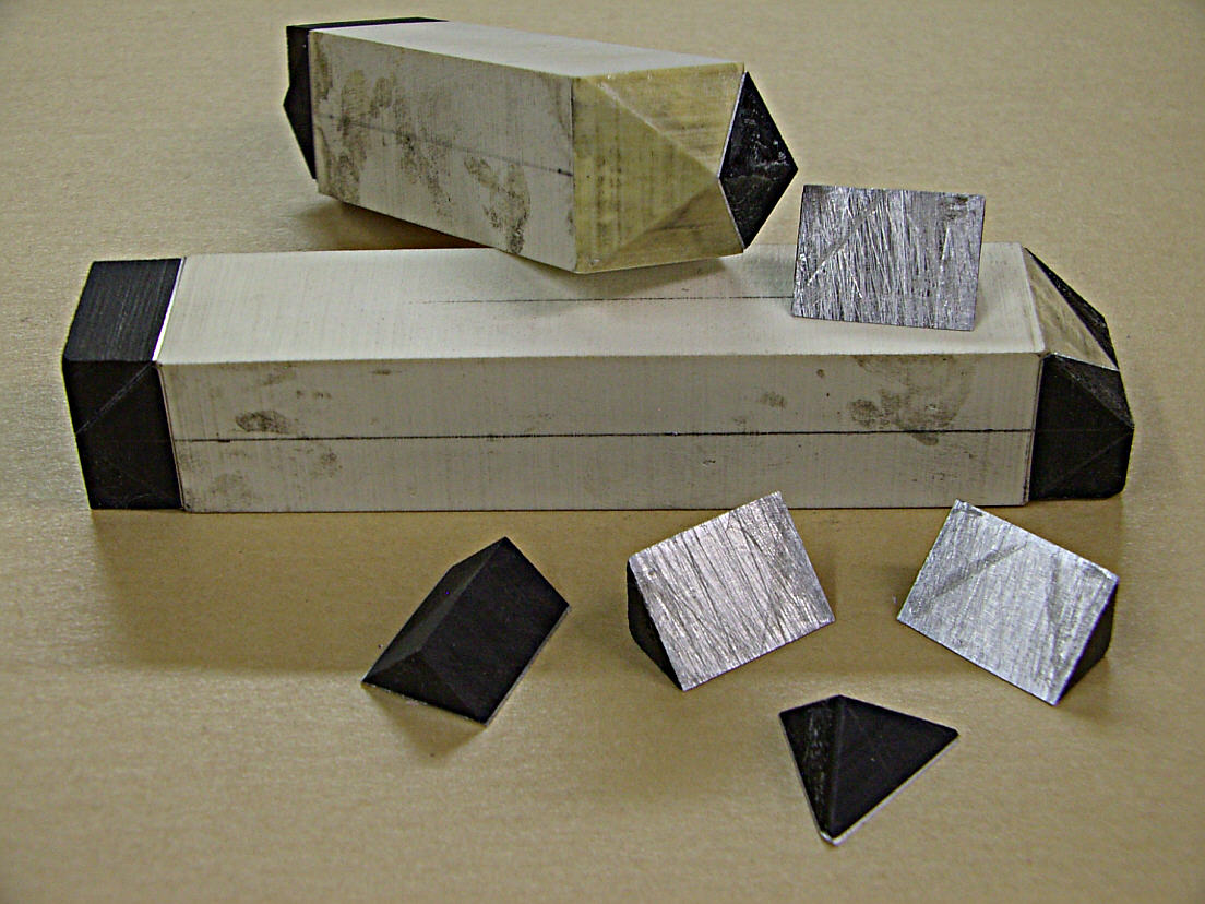

Here is one that was going to be pretty when done but I made the drastic mistake of using CA. I may revisit this one at some later date. Even you would have liked this one Skip. Done on a tablesaw. Would have more design also but never got it far enough.
