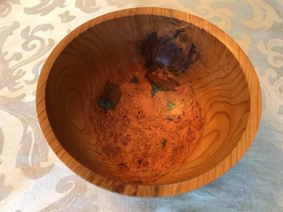

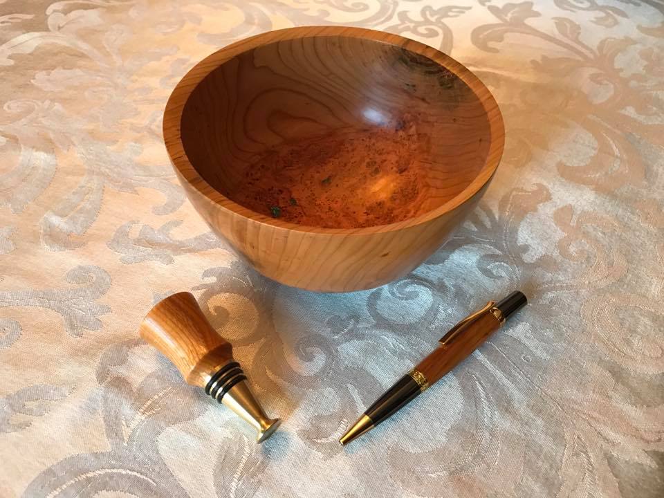

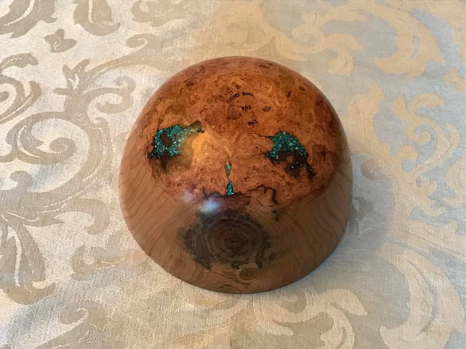

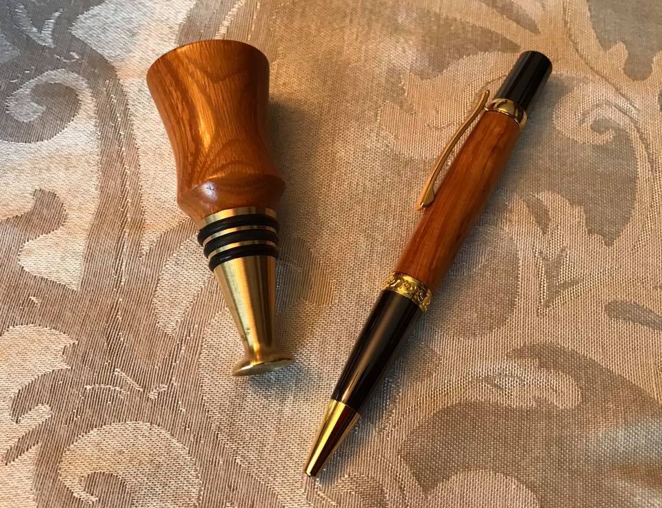

Hey all,
I love making things from wood that came from trees lost to a storm or disease. Here are some things for a client that lost a Cherry tree and removed some Buckthorn from their property.
The bowl is Cherry and has some burl in it. The inclusions were filled with epoxy and Chrysocolla (a mineral similar to Turquoise). It's about 8" across. The pen and bottle stopper were both made with Buckthorn.
Enjoy!
