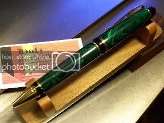

Tru-stone is nothing, I used a Nice sharp Skew and no troubles what so ever.
Banded Malachite on gold
Now Sanding and polishing took it all the way through every MM pad I had.
