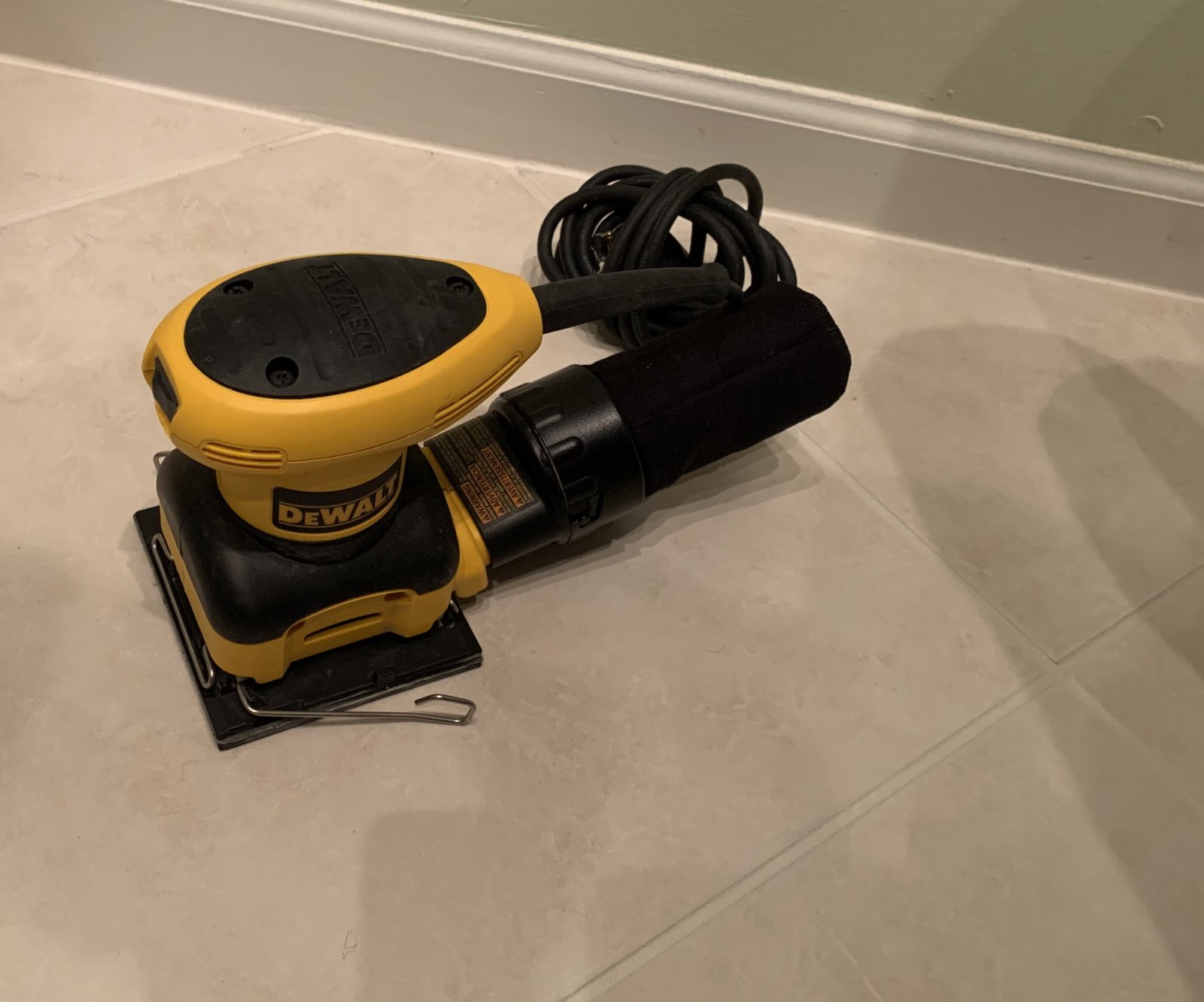

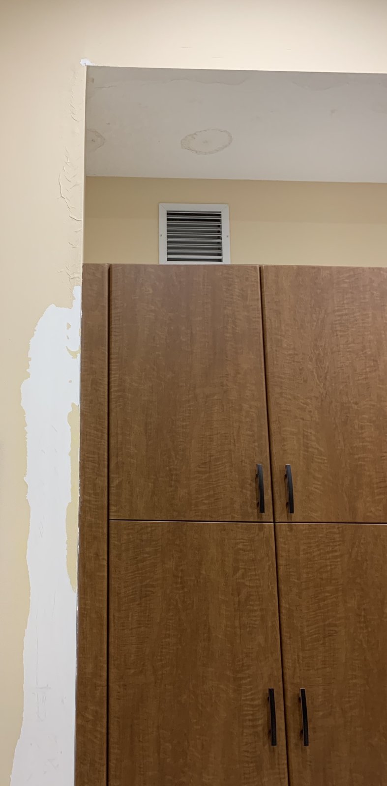

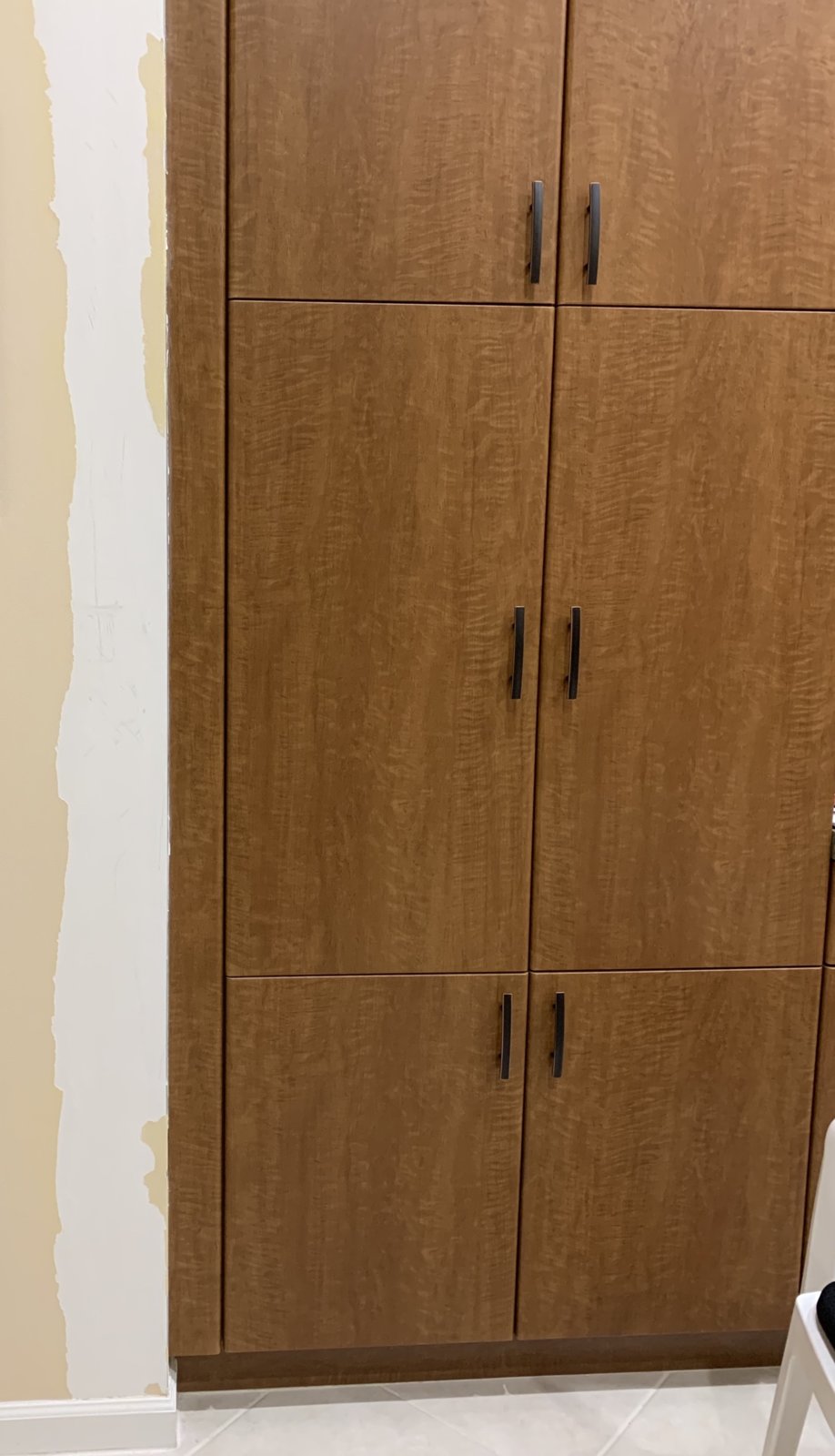

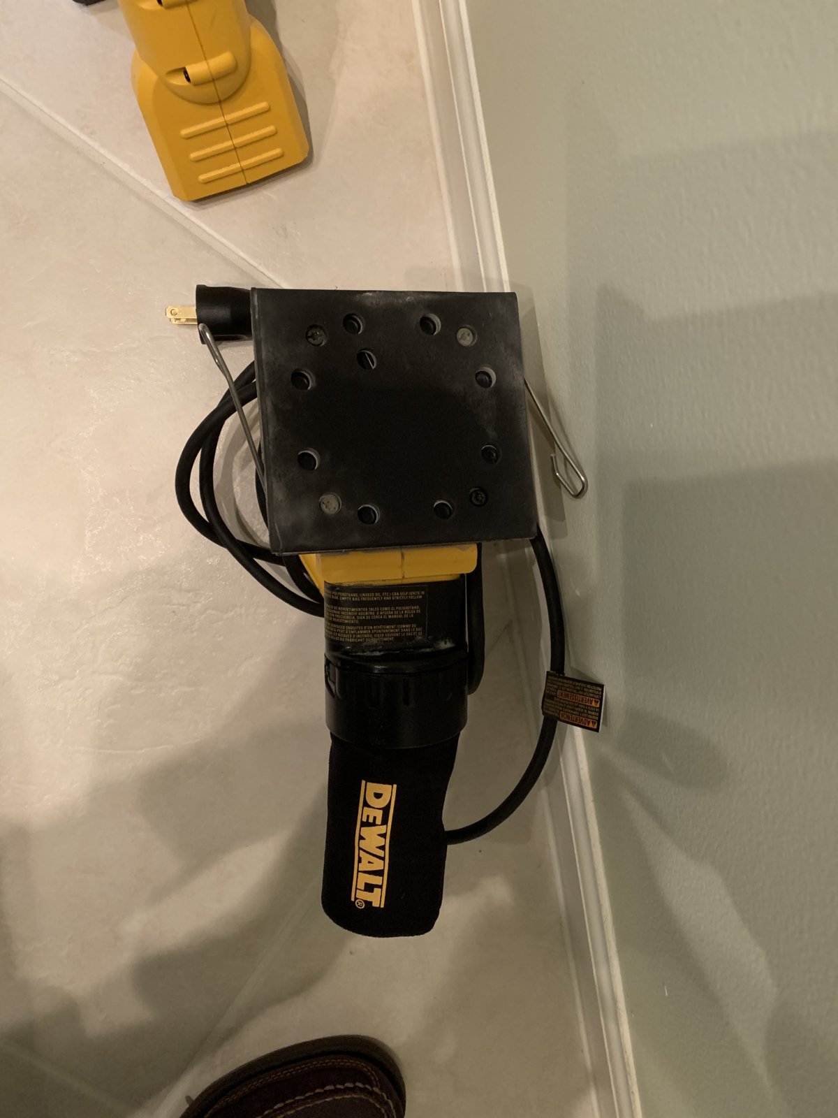

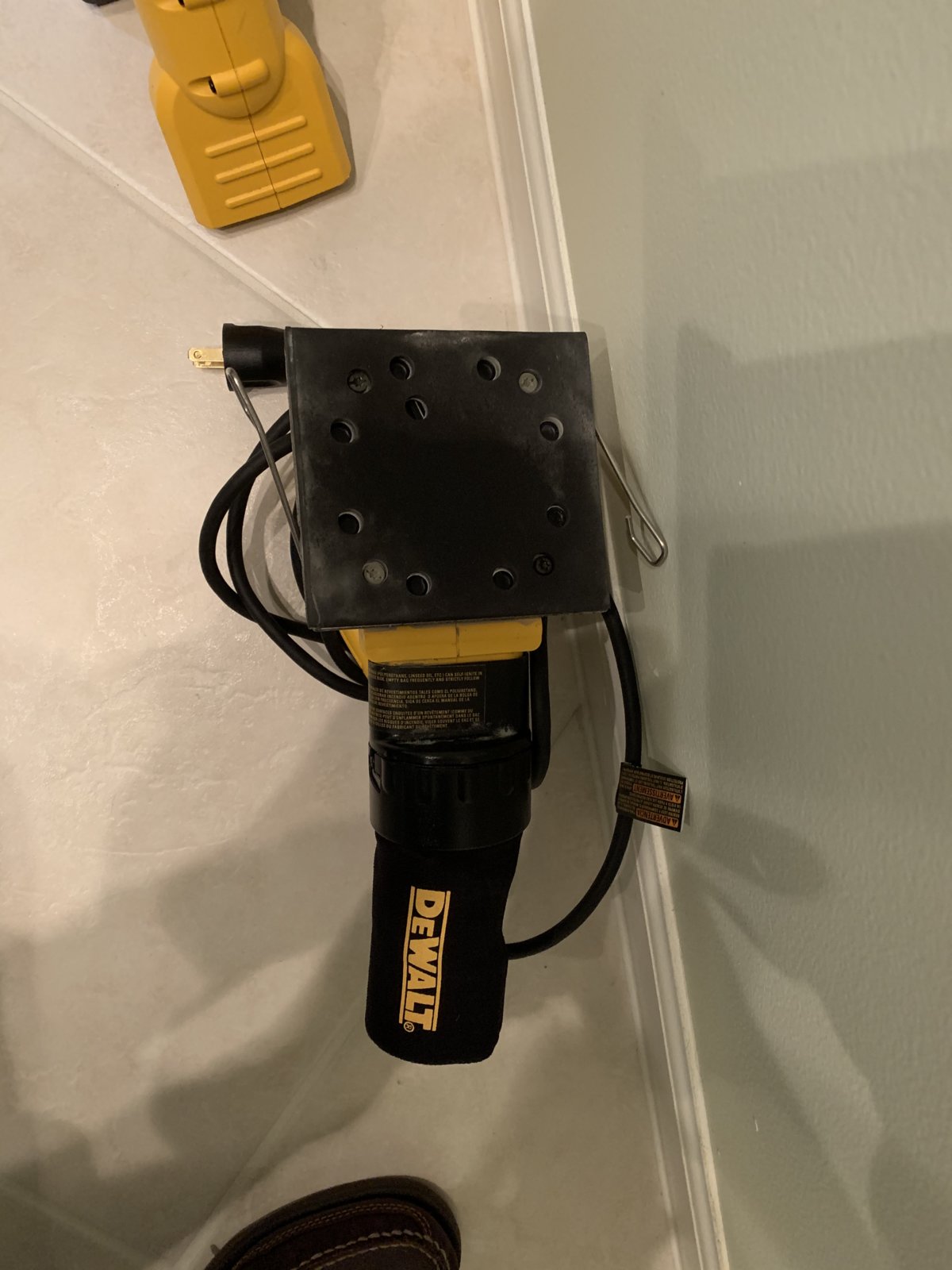

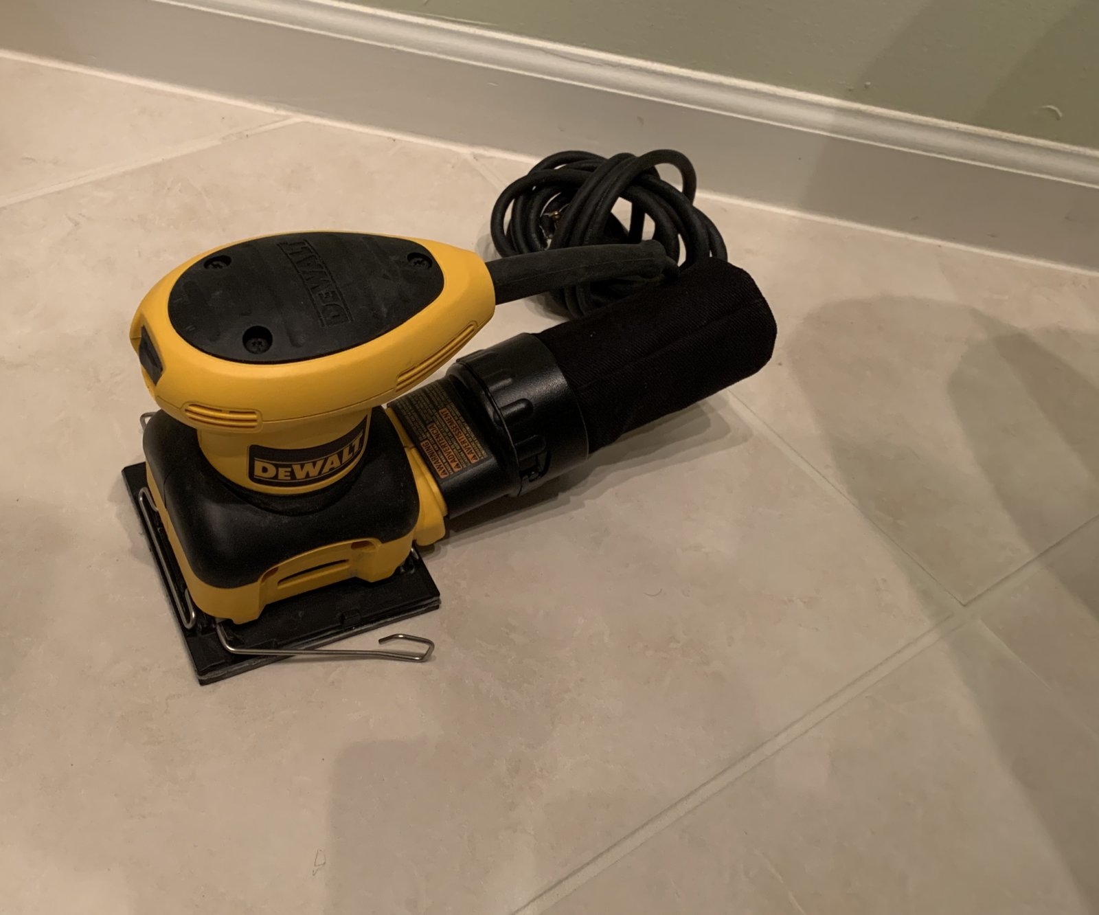

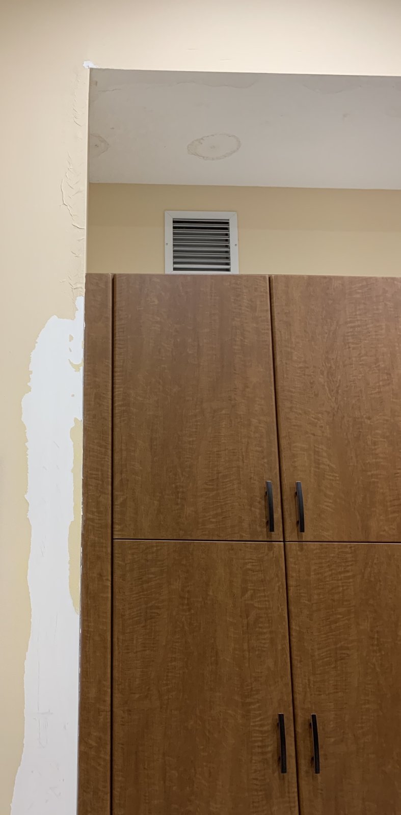

News flash. I have a DeWalt palm sander with Dust collector hook up. Forgot I had it. Might use a sanding screen or 220 paper. Here's the project. Not a lot of filling.... mostly sanding. Had water run down wall. Wall is dry.... not powdery.

My goodness, want to buy all that expensive equipment for that. :) That is a 10minute job. I wish all my drywall jobs were that easy. That sander will not catch that dust. It will some and just clean up the rest. I voiced my opinion as to what to use and stick with it even more so seeing that. Good luck. See you have some overhead work too. If that is just painting, make sure you use a stain killer. I like Kiltz.
11minute job at my age. I move like snail with airbrakes. The paint is thick and has a edge that needs to blend in. Also blistered and needs to come off in some areas. Looks simple but looks can kill. The sander takes 8 hole paper and has provisions for a vac. Why will it not catch dust? That's in the plan. The ceiling needs some minor work also. It has the knockdown finish. Whoever designed that finish should be hung by their ????'s. Come over and help out...donuts and coffee are on me if we can cut the job down to 9 minutes.....otherwise bring your own.
The reason those sanders are not that efficient is because they rely on those holes in the pad and paper and you need to have those lined up pretty well and it does not have a shroud around the edges of the sander to contain the dust within. The bag is so small to capture dust. You may have a better chance with a vac attached but I would not bet on it. Good luck with the project. I would knock off all loose stuff and then hit with a nice smooth finish coat or two. A proper blade would get this done easily. Use the blue lid compound. Will sand easier and is light weight. (Home Depot, pre mixed)
Sander update. Total waste. Too loud. Too much vibration. I'd recommend it for a small piece of balsa. Goes back on the shelf for 10 years
Drywall sanding is not the concern. It's trying to blend the paint line to the exposed drywall. The wall has been painted multiple times and is thick. Think I'll use a heavy grit to even out the paint edge/line....will apply a thin spread joint compound and go from there. Looks like a bit of hand sanding and taking my time. Does not have to finished in one day. As for hand sanding blocks. The Hyde is junk but upscale junk. The hose is a real POS. I keep looking at the Festool hand sander. Buy the time I select the sandpaper the clocks will Spring forward. If you ever looked at Festool sandpaper choices you'll find it's easier to sell the house than to buy from their website. And at $39 for 50 sheets I'm speechless.
