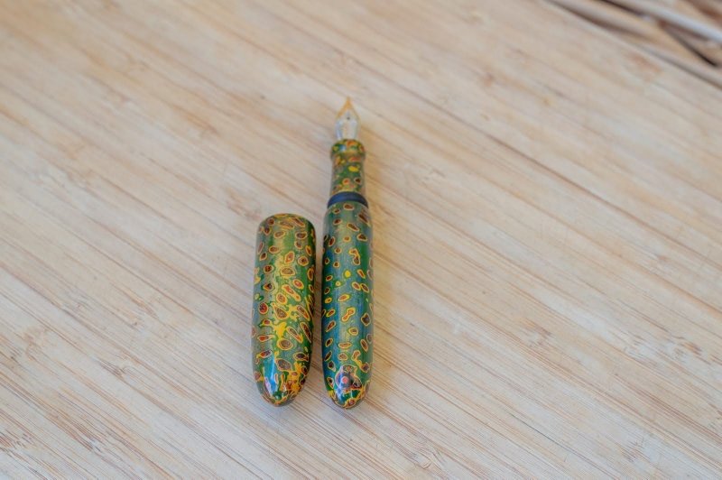

How Everyone,
I hope you all spending a nice weekend.
After another eternity I'm close to finishing this pen, Kara-nuri process. He has 4 distinctive colours and golden powder. Some details left to do, lacquer the screw and the interior lip of the cap.
Enjoy the rest of your weekend.
Teo
