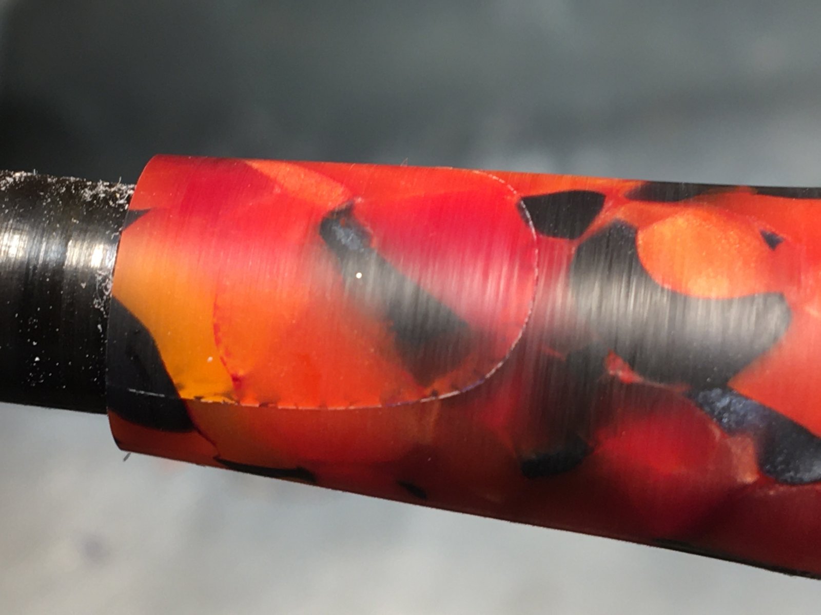

The kit is a round top European. After cutting the 5" blank to appropriate lengths I used a scratch awl to put a dimple in each end for drilling - won't be doing that again! And of course I hit it too hard causing a nasty split - thought I could recover it by gluing up with epoxy. You can see in the photo that this is NOT going well. :confused: Any suggestions on salvaging this, or should I just put it in my scrap box & chalk it up to learning? It is fitted with 7 mm brass tubes.
Would appreciate any & all suggestions/comments.

You could salvage by cutting off the "bad" end and replacing with a black (or red ?) "oops" band.
Black would be my personal preference, and I think it would look OK at either the nib end or the finial end, but probably not at the center.

The thin CA is worth a try. Then use Mal's option as plan B. You still have a lot of meat on the blank to make a band look great.
