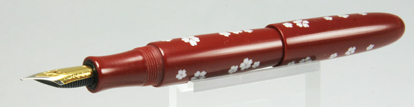

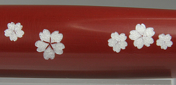

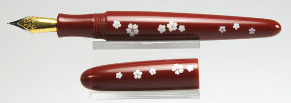

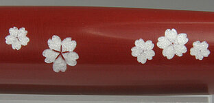

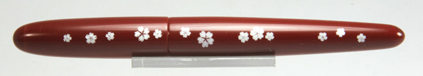

It's been a while since last post. I've been experimenting with cheap Chinese laser engraver to achieve Maki-e like finish without Urush lacquer. I think it came out pretty good. Thanks for looking and c&c welcome. - Yoshi
Materials:Alumilite, Epoxy, Pearl ex
Nib: JoWo #6
Nib size: M
Ink system: Cartridge/converter
Size (approximate.)
Maximum diameter: 15 mm
Capped length: 138 mm
Uncapped length: 128 mm
Posted length: 148 mm
Weight with converter (approximate.)
Capped: 15.7g
Uncapped: 12.4g

That's beautiful, the shape, color and engraving all compliment each other perfectly.
Thanks for sharing Yoshi! Very beautiful work and it seems like a high level of skill is involved. Great job. :smile:
A Glorious Pen, Yoshi.
Beautiful Blank, enhanced with Subtle Laser engraving.
Gorgeous Profile, Proportions & Lines.
Superb Fit and Finish.
A pleasure to see a Kit less Pen, where the Profile both closed and posted are equally brilliant.
Congratulations.
Brian.
Thank you all for kind words!
Pen-Archer, the rotary attachment won't fit on my laser. I arranged flowers within 7-8 mm to minimize distortion. You don't need rotary attachment within that range.
