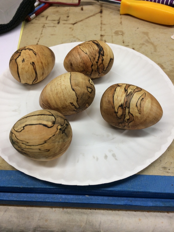

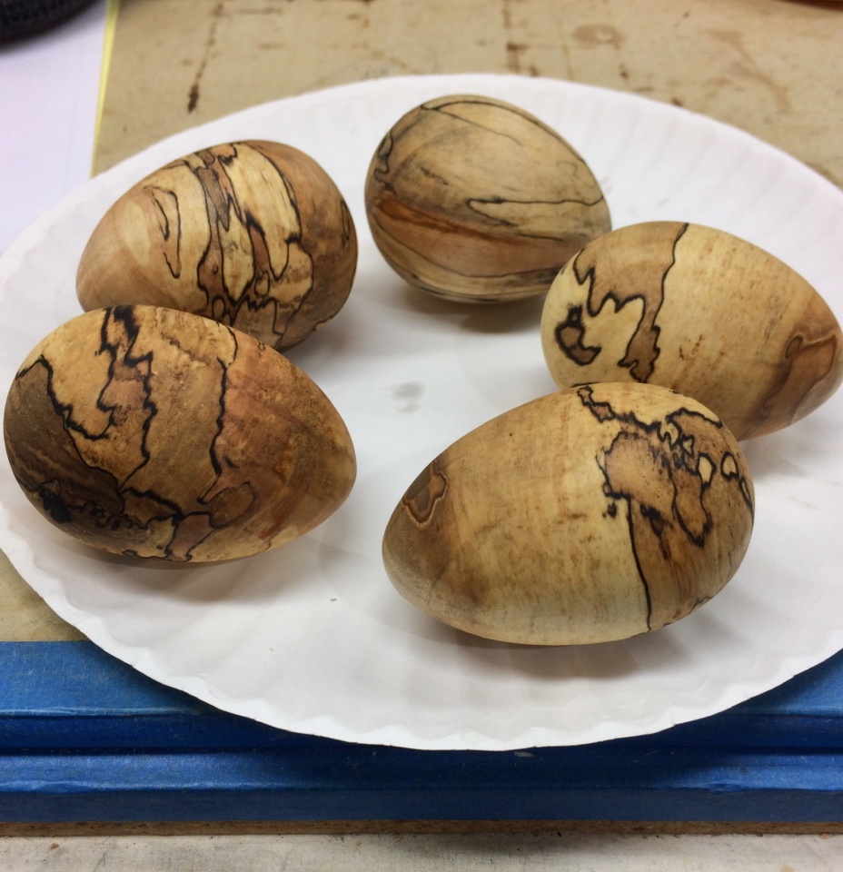

Here are some spalted maple eggs I turned yesterday. One is in traditional spindle orientation and the others are all turned in cross grain mode.
All turned between centers, nubs sawed off a tad long, carved off with knife and then hand sanded to 400.
I only have one coat of MO (mineral oil) on them at the time of the pic last night.
I like the figuring on the cross grain eggs best. Will recoat and buff when dry.

Thanks everyone! These were quick and easy.
While I was at school helping the bowl Turner, I turned these there. Since I already had chips on the floor, the shop teacher said I could stay and turn these.
It also gave some of the students a chance to see something besides pens.
Note that when turning these in cross grain orientation I use a bowl gouge and only do pull cuts...cutting down hill towards the center/apex of the egg.

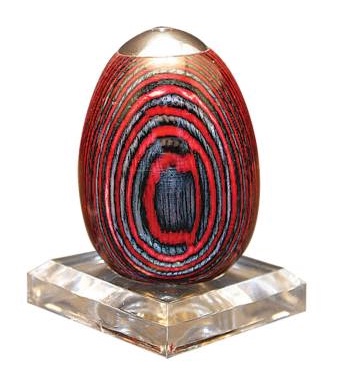

We are gearing up to make Easter Eggs at the center again this year. Several turners want to make spectraply eggs. They ought to be really pretty. Thanks, Edgar!
Can't wait to see them. Spectraply eggs & tops are on my to do list as well.

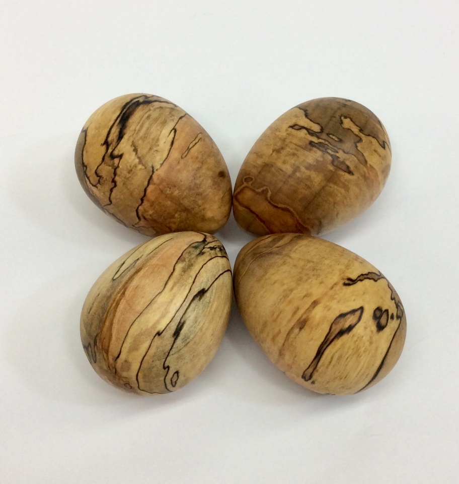

Final got around to getting a pic of the finished eggs I used several coats of Mineral Oil, let dry and lightly buffed. I wasn't going for a high shine...just a soft luster.
