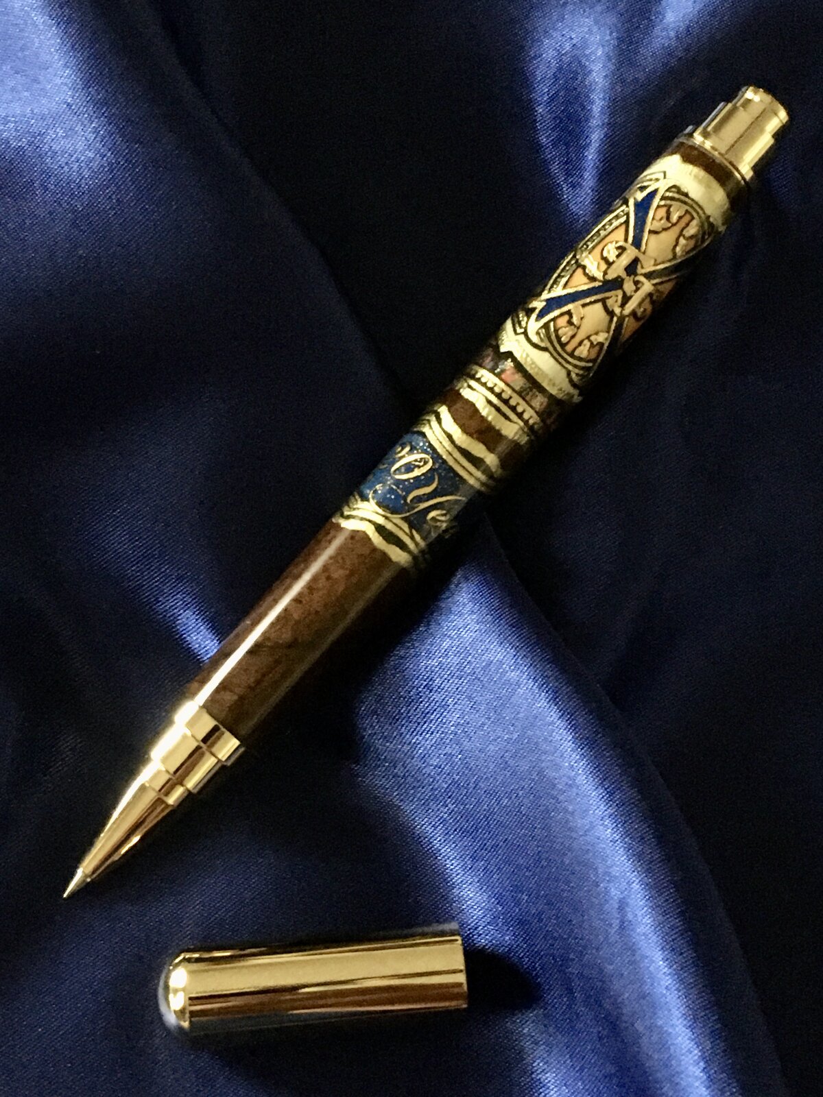

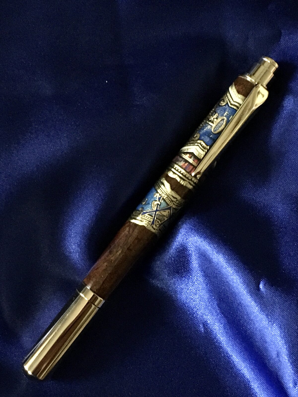

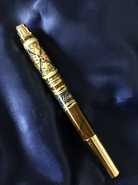

A couple of weeks ago I asked the IAP about a small rollerball kit with a snap on cap. This kit was suggested so I looked into it and saw that it was cheap enough I'd by a few of them. I just finished this up and so far I like the feel of it. Although I like the slimlines they are a thin pen and my big hands don't get along so well at times. The Rollester is a larger diameter barrel but not as big as the regular rollerballs and not as long. This will be my new carry pen so we'll se how well it holds up. Thanks again to those who responded to my earlier thread and questions and comments welcome.

Thanks and Yes I cast the blank. I haven't tried to light one but I'd assume it might be tough. I'm not a smoker but I like the looks of the tobacco and the labels.

nice looking pen. my only complaint about the rollester is that as the cap mechanism wears out the cap tends to sit kind of crooked (sometimes they are this way right out of the box). Functionally it is fine, its just kind of annoying how it looks. I tried using a punch to press the mechanism into the cap a little, but went to far and the cap wouldn't click on unless I threaded the tip out about 1/2 turn. Given the price, its probably not a big deal to just buy another kit and just replace the cap.

Good point Sam. I guess I'll find out dinner or later. I haven't tried looking to see what or how it works. I see your in Houston. I'll be heading that way tomorrow to visit my son. He's on the southwest corner of town.

I'm not sure if anyone has really come up with a good solution. I believe the problem is due to the plastic insert not being pressed in far enough. However, there is a very small sweet spot, if it's pressed in too far then it won't snap on and there's no way to pull it back out (that I'm aware of). I just used a hammer and a center punch, but maybe an arbor press or something like that would be more controlled. I do really like the kit for my own personal use - fits in my front pocket nice and is comfortable in my hand, it's a really nice size for a rollerball. Yours looks really nice, I hope it doesn't develop the crooked cap syndrome 😉.
