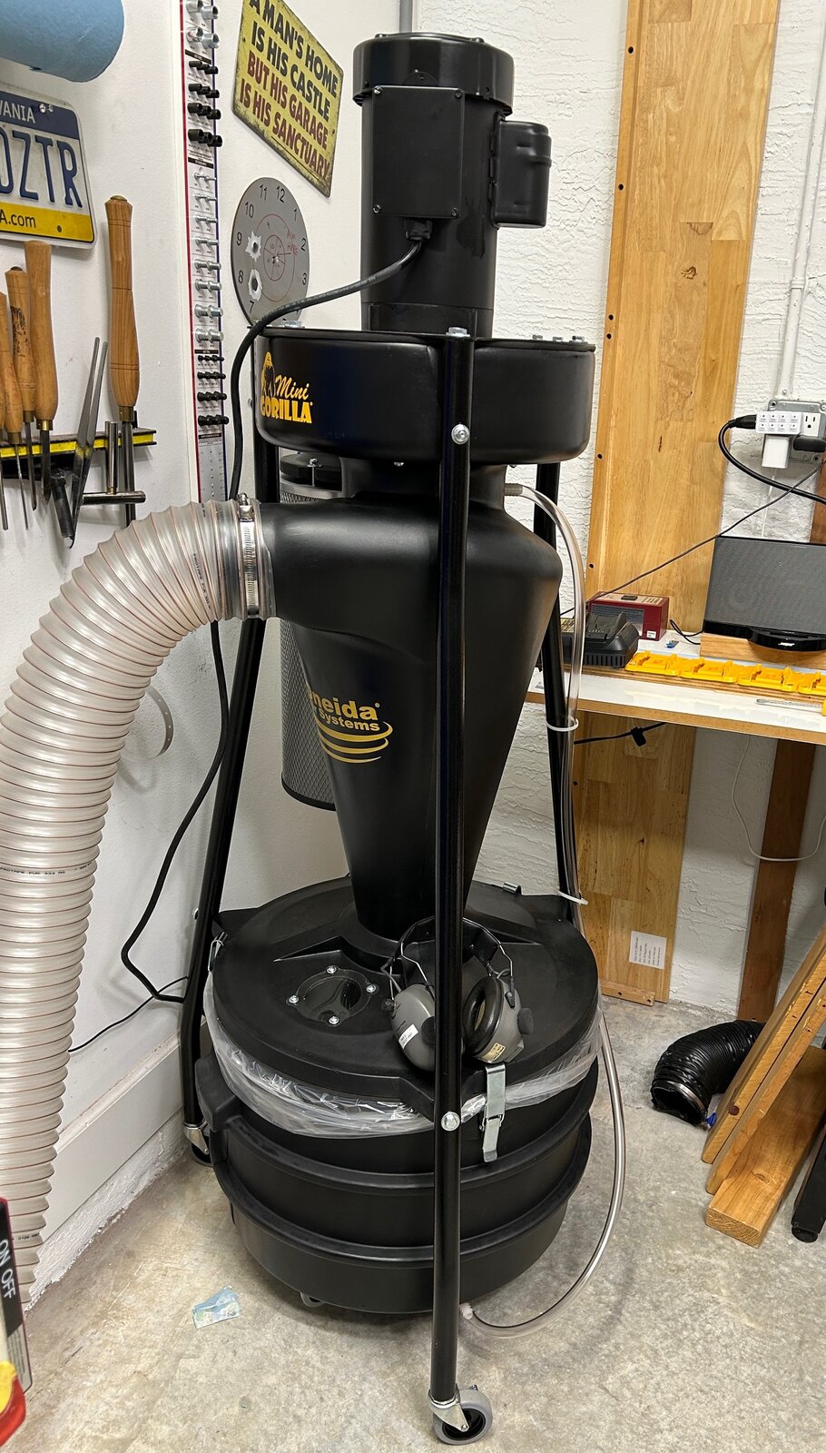

Sexy ain't it. True shop porn

Sweet! How do you like it??
Not fully set up... need a curved adaptor to fit 5" hose to (4") PSI intake chute. Might have to improvise. It was fun setting it up. Was shipped in 3 boxes. I could not lift the motor. We had furniture deliver this morning. I asked driver/helper if they would help out for 60 seconds... they said sure. I gave them a nice thank you.
Good luck with the curved adaptor.
I remember when I hung the 2 HP motor/fan assembly on my garage wall. Good thing my son was home from college, there is no way I could have done it myself.

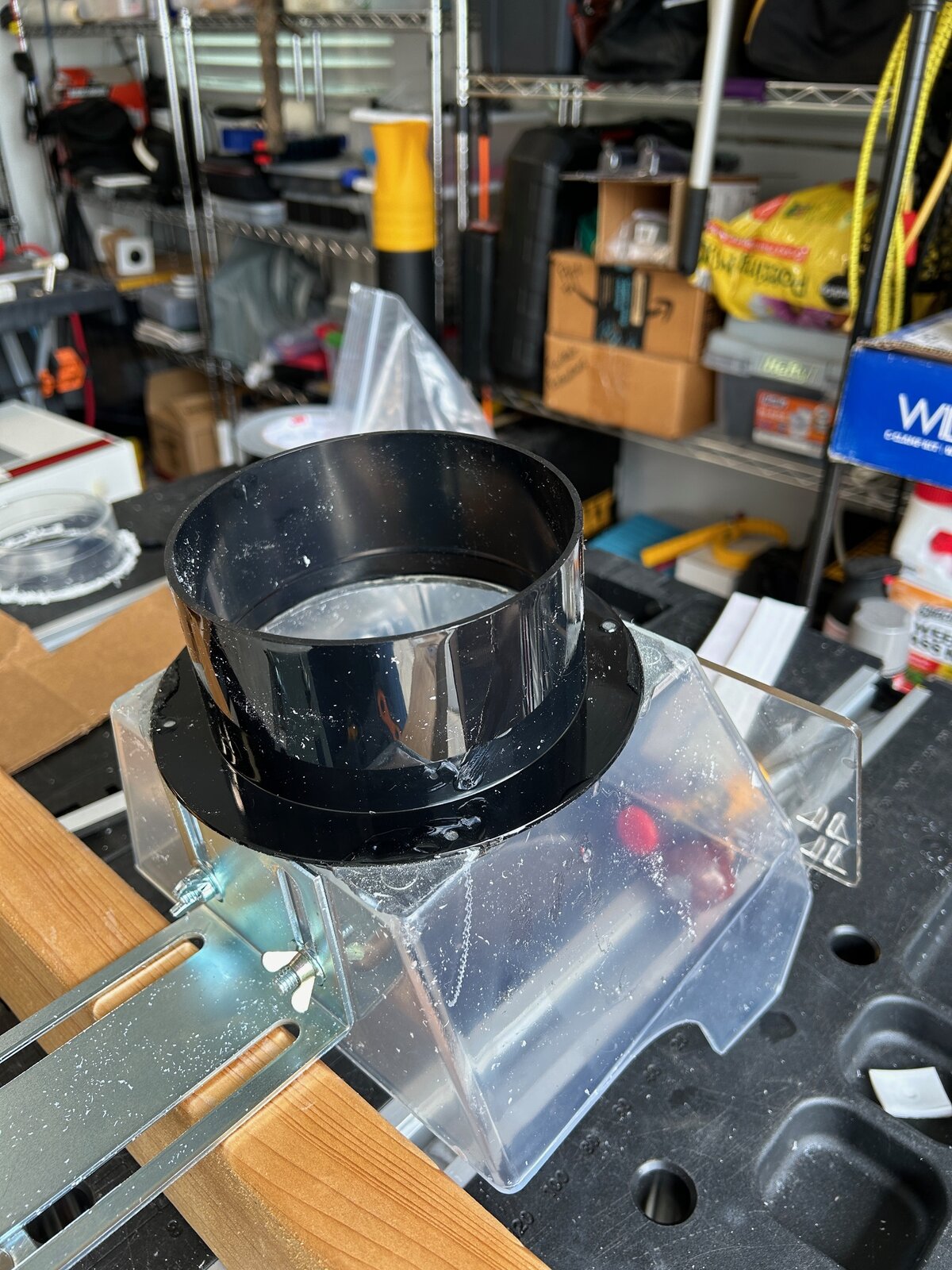

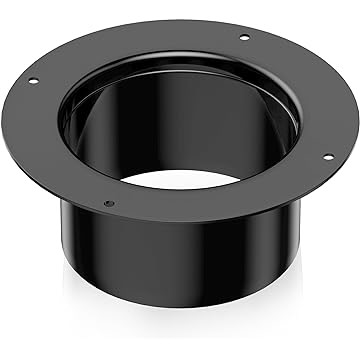

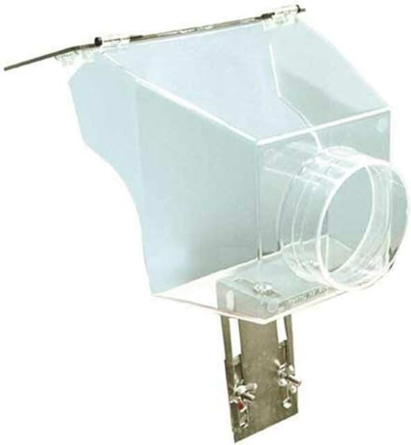

I think I can improvise and stay at 5". I'll mount the flange to the dust chute and enlarge the hole... should work.
What adhesive works best plastic to plastic. Prefer not use CA. I'm considering something like Goop. Taking suggestions. Thanks.
If you scuff the both up good, epoxy works well. This will be permanent.
Or, use silicone with nuts and bolts. This could be undone with some effort.

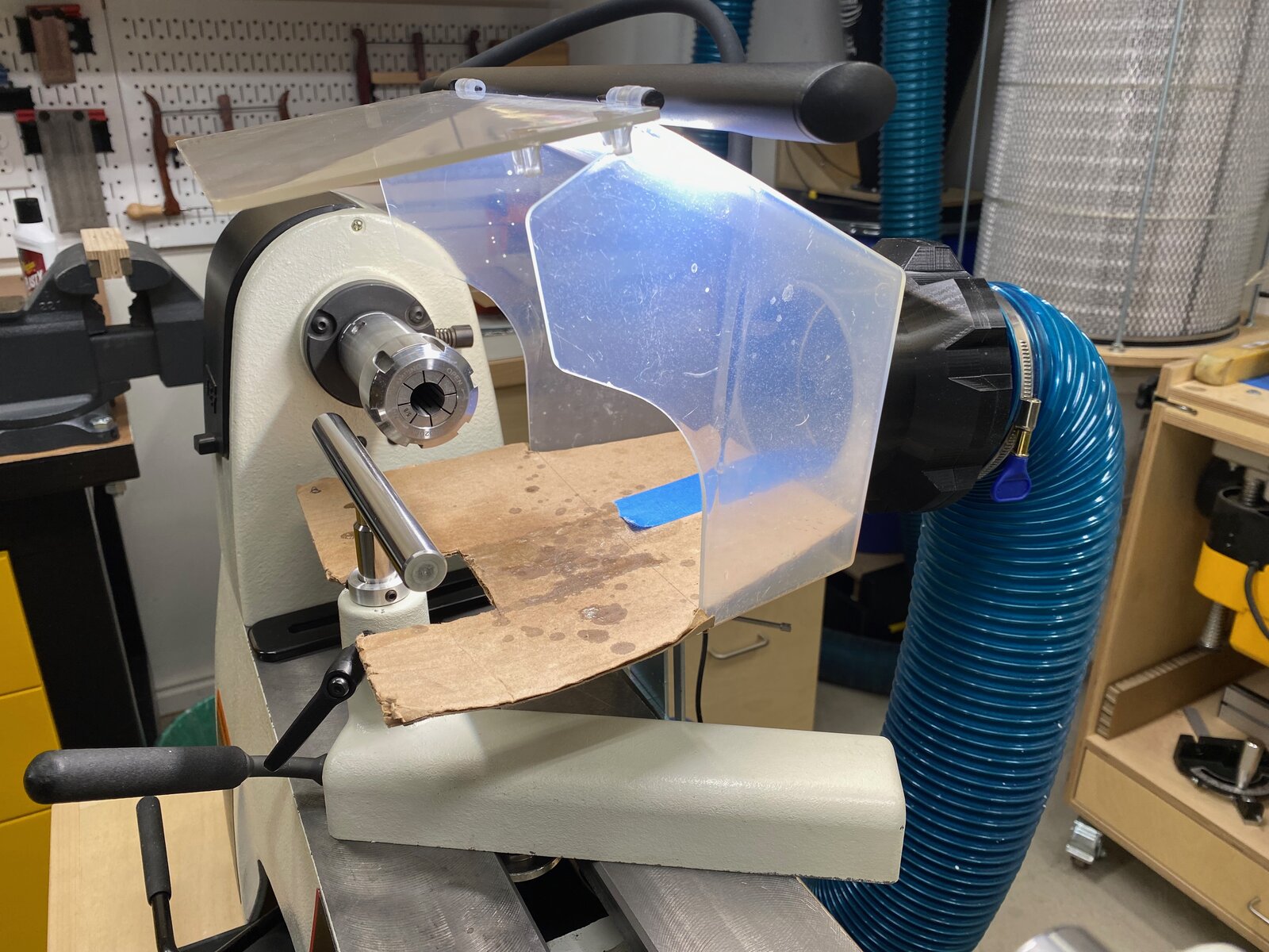

I use the same clear plastic dust hood from PSI and really like it. I started with the smaller one from Rockler that connects to a Shop Vac, but the combination didn't move enough air.

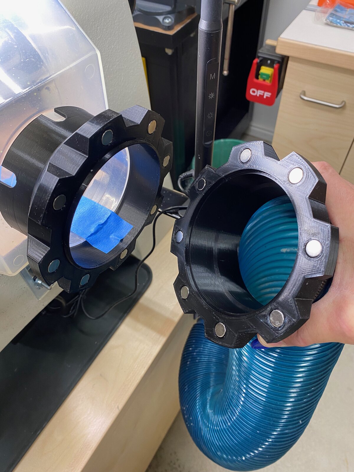

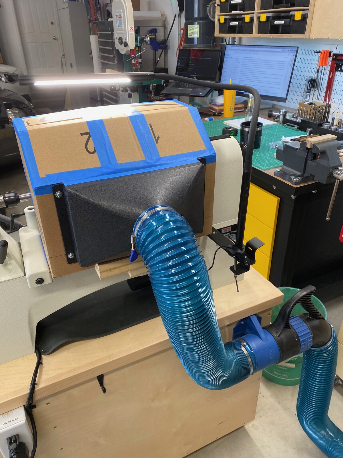

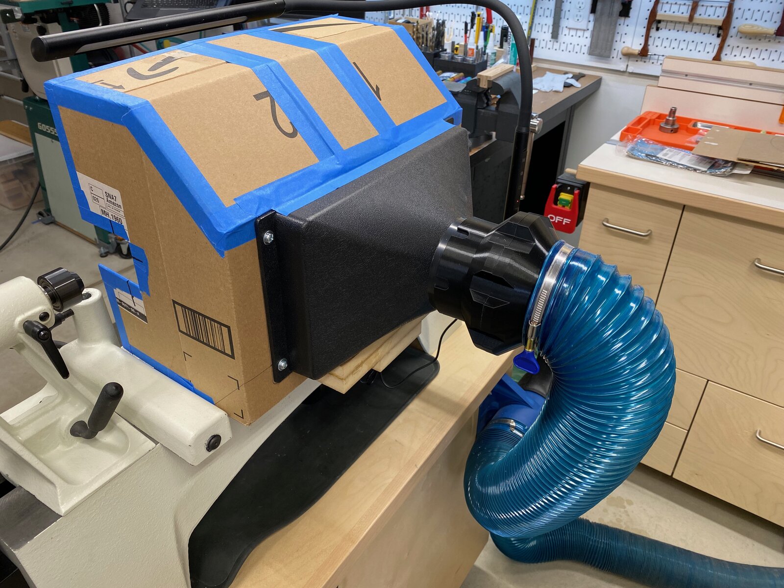

If you are interested in what I'm up to with my lathe dust collection, then read on...

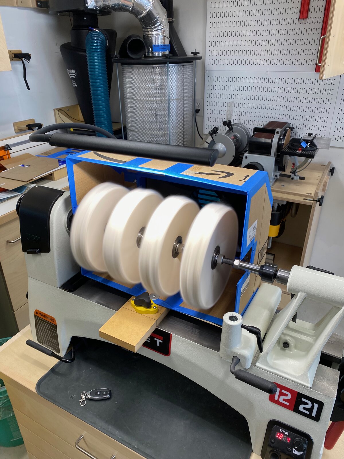

I recently made a 4 x 8" wheel buffing setup (@TonyL design from the resources) and designed a hood for it. I didn't want to built the final product until I tested it so I mocked it up with some of the parts I will use, but cardboard for most of the enclosure. Because I still want to use the PSI hood for more localized air movement when turning, I needed a way to easily switch up the 4" dust collection hose. When I was building the cart/cabinet my lathe is on (Jet 1221VS), I anchored one of the Rockler DustRight 4" to 4" connectors to the back and then have just a short section of 4" hose from that to the PSI hood (you can see it clearly in a couple of the pictures below). So, I needed an easy way to switch from the PSI hood to the one I will use for buffing. 3D printer to the rescue. I didn't design these, I just found them on Thingiverse, printed them, and epoxied the neodymium magnets into them. There are two 10mm x 3mm magnets stacked in each spot, it is strong enough that the design has a gear tooth look so you can connect them with the magnets offset and then rotate the magnets into contact. Disconnect is the opposite, rotate and pull. I have used it with the PSI hood, but haven't tried the buffing rig and hood yet. I'm excited to give that a try and then build the final version.
Here are a few pictures.

I do also really like things like this buffing hood, the whole process of defining the problem/project, engineering a solution, design, mockup, final fabrication is a lot of fun. I especially like it when I can cross between design, woodworking, 3D printing, etc...

Not sure if we should be on the same page together. You are way too neat/organized. My shop is perfect for "Before" pictures. I really like your buffing wheel hood. Those wheels are brutal after some wear. I used 3 & 4" rag wheels in the dental lab with pumice or plastic polish. I'm thankful I can still breathe. Also used a shop vac... thankful I can still hear. Thanks again for posting the pictures. Good/proper set ups are inspiring. No substitute for good work habits.
LOL, thanks Frank.
Well, I try to keep it neat, but my shop shares space with my car and that means that I have to at least put things back to get the car back in the garage each night :cool:.
I used the buffing wheels/hood for the first time yesterday and holy smokes, I forgot how much new wheels shed. The hood did a pretty good job of containing the mess. With it the dust collector seemed to do a good job of keeping a good airflow across the wheels and into the hood. I'll use if a few more times before building the final version. I'm trying to decide if I want to make the hood a bit wider to allow me to add a fifth wheel. If I do, may have to remove the banjo from the lathe to use the buffing rig. Decisions, decisions, right?
