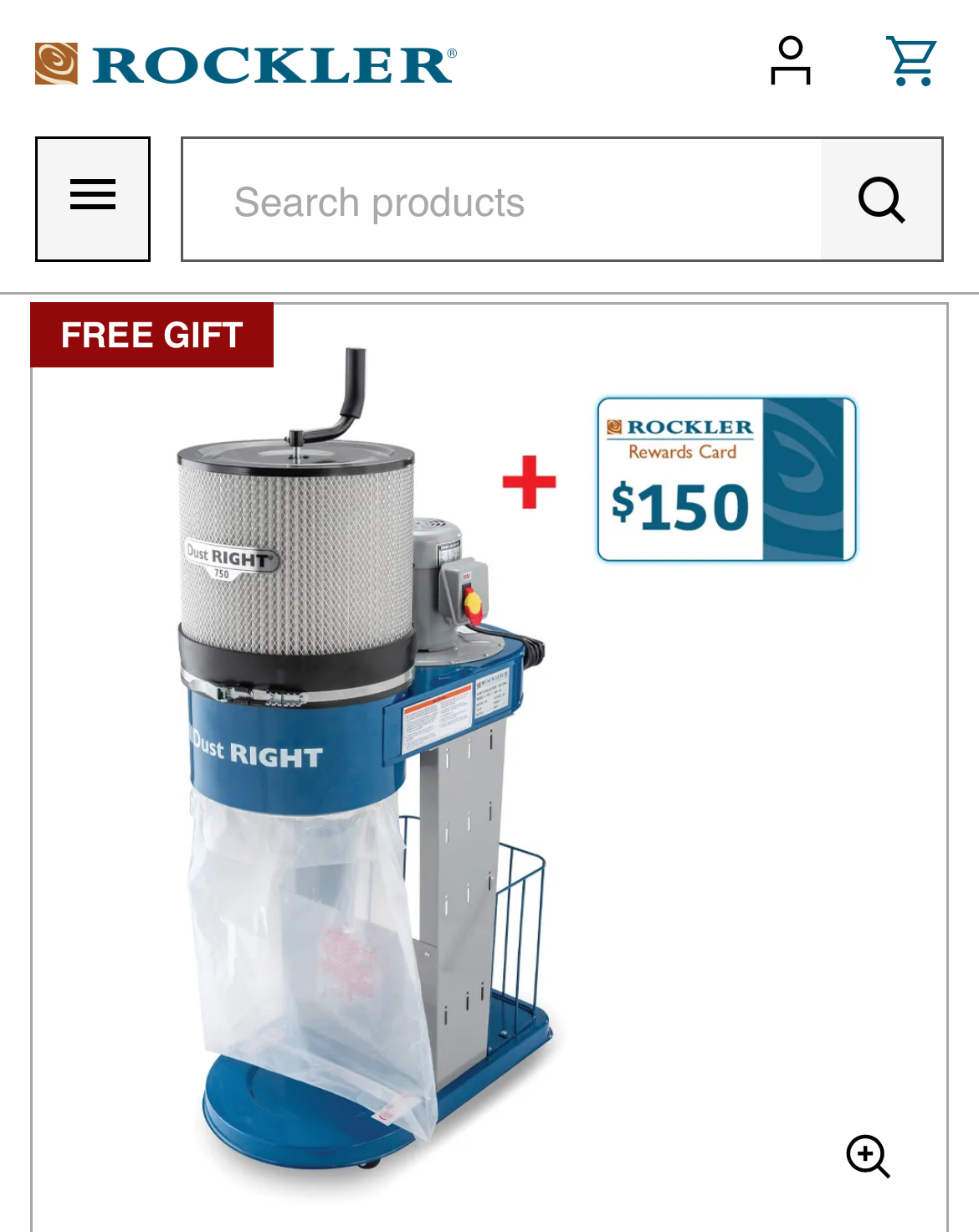

Anyone have this. I'm looking to upgraded from the PSI collector. Giving this thought. Comments please.

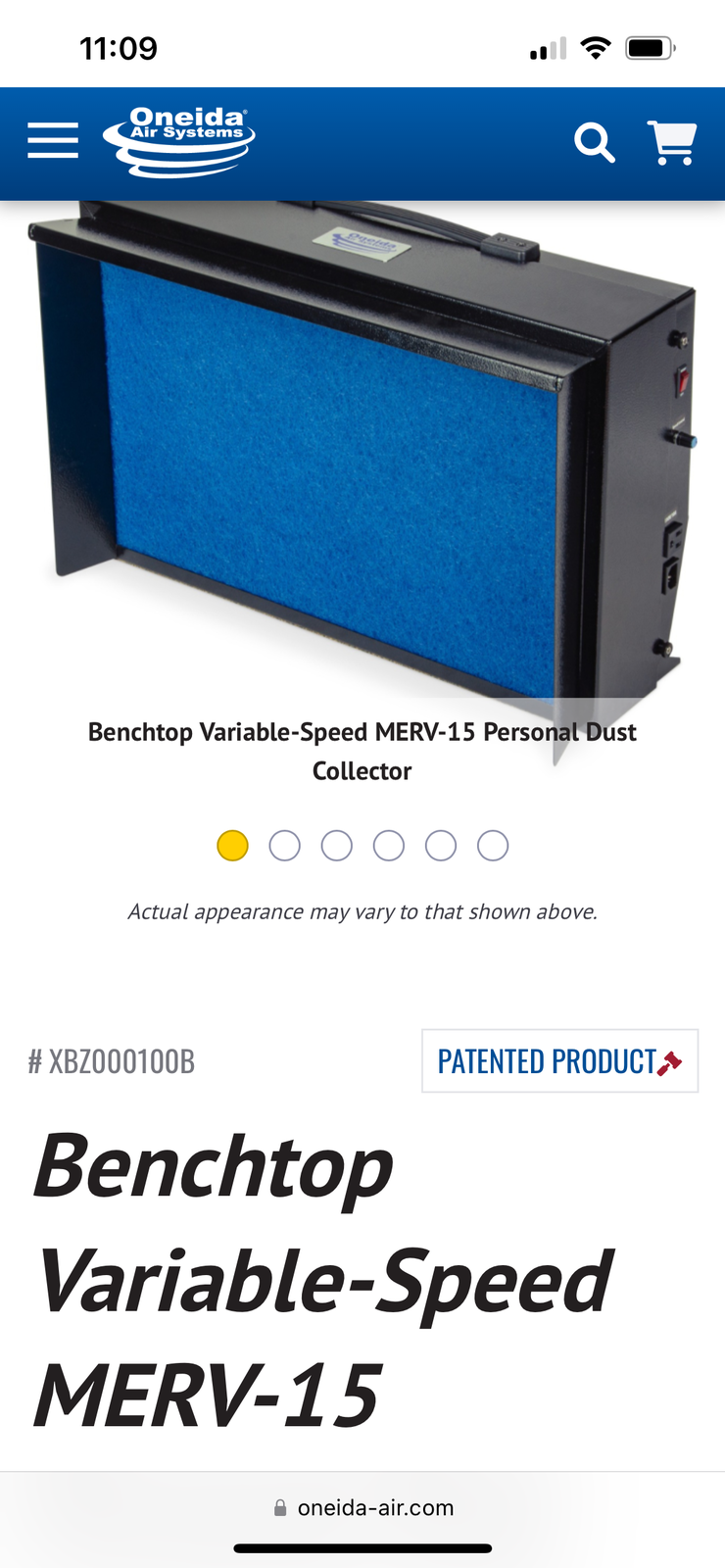

+1 on @RGABEL 's post. I have one of the MERV 15 filters from Wynn Environmental.
Mated it up with a Super Dust Deputy cyclone by Oneida and the 2 HP Harbor Freight Dust Collector (only using the fan portion of it). I just upgraded the impeller in the HF unit to the 11 3/4" impeller from Rikon, and now it is in Beast Mode!
Not sure if I expressed myself properly… I'm considering buying the Rocker unit not just the filter
I understand what you are saying and believe that @RGABEL did as well.
I have no personal experience with the Rockler Dust Right system you are considering. I am using the Rockler Dust Right 4" hose and quick connects and like them fine.
What I am saying is that if you are interested in the possibility, a considerably less expensive option might be to add a MERV 15 filter (from Wynn Environmental) to your existing unit.
The Rockler unit you are looking at does seem to be a nice relatively compact and mobile option. I'm sure there are multiple YouTube video reviews of that product.
Rockler is my focus but all options open.
I watched a few videos. I like the size of the unit and more. Is 75 decibels typical for collectors?
I measured mine recently at 78 dBA. I also measured my 16 Gal Rigid shop vac and it was 72 dBA. It is important to understand that the dBA scale is not linear, in fact, each 3 dBA increment is double the volume.
BUT... the pitch is very different. The pitch of the dust collector (mine anyway) is lower and to me, much less objectionable than the higher pitch of the shop vac, even though the measurement indicates that the dust collector is significantly louder.
Either way, wear hearing protection when you run it.

Thanks.... Will use the Dustright with the Jet lathe only... no saws, planers, sanders, etc. Overkill or no such thing? I do have a Festool midi but I think it will fill too quickly. Thoughts?
I don't know much about the Festool Midi, but assume that it is a low volume high pressure (suction) system like shop vacs and extractors.
The difference you will notice with a dust collector is that they are high volume low pressure (suction). The move a lot of air and when set up properly on the lathe, that air moving across the turning, will pull in much more material than the shop vac/extractor types that are low volume high pressure.
Low Volume High Pressure works great on smaller tools like sanders and even a track saw, but for tools that generate a lot of dust/chips/shavings like a lathe, table saw, planner, jointer, they simply can't keep up, not to mention they will fill up quickly. That is where dust collectors shine!
Hope this helps.
How good is a 1micron bag vs a cartridge. Both good?
I'm having a rough time ordering the Rockler 750. Way over a $100 for shipping. The best feature is the height or I'd go for a Jet

I took a quick look and didn't see any specs on the canister filter on that Rocker, so I can't comment on it specifically, however, in general, the bags don't filter as small a size particles at least in part because if they did, they would restrict the flow way too much. It is a matter of square feet of filter media. The bag has only its surface area, while the canister is a pleated filter with a lot of surface area, so it can be made of material that will filter out smaller particles, but still flow enough air to not restrict the flow to the point where the dust collector isn't effective.
i used the 1 micro bag on my dc for 7 years. the top filter (grizzly) that i bought performs significantly better - less airborne dust in the shop, but at a significant initial cost. at the end, who knows?
My cousin has stage 1 you know what. No idea if turning contributed.
I do know a Shop Vac with the standard filter is worthless... (directed to Shop Vac users)
SO...The $100 shipping is holding me up. It comes with a $150 gift card.... but the $100 is making me sweat.

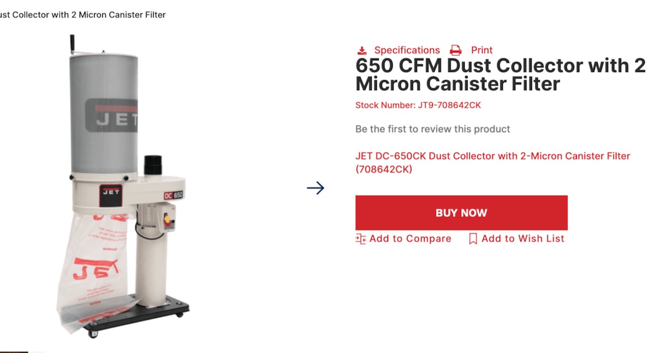

This a little too high... Prefer a compact... however giving it thought. Why does it come with a 2 micron not a 1. What is the logic. Does 1 filter substantially better.

I have that exact unit. It works well. It is quite tall so keep that in mind for your workflow. I parked mine behind my jointer and made a chip separator out of a 30gal. brute trash can and it keeps up with 8inch wide passes on the jointer just fine. For lathe work a nice wide chute and you're good to go. I do find it much more tolerable than a shop vac noise wise.
Go with the best filter you can afford. 2 Micron is nothing special. It is the smaller stuff that is the most problematic.
As for bench top units, I'm not sure what you are referring to. Not sure I've seen any bench top dust collectors.
This would be used with a taig pool cue lathe…. The more I look at it I'm going to pass.

Next question ...is there a big difference between 1 & 1.5 HP. The Rockler is 1hp.. The 4" hoses won't be longer than 10 feet.
Focus on how much air they move, not the horse power. It will be rated in Cubic Feet per Minute (CFM). Yes, it takes more HP to move more CFM, but since you want more CFM, look at that rating.
Rocker says Flow Rate 750CFM
Other says actual 583 AT 2"SP ??

The 583 @2" SP is saying that it moves 583 Cubic Feet/Minute of air at a Static Pressure of 2" of water. This is a more qualified specification than the simple 750 CFM for the Rockler. Are you able to locate a more detailed spec on the Rockler?
The other tricky thing here is how/where are they measured. Both at the inlet of where you would connect a hose? Unfortunately, I don't think that there is an industry standard for this on Dust Collectors.
What I can tell you is that I recently swapped the stock 10" impeller on my Harbor Freight dust collector out for a 11 3/4" impeller commonly used in Rikon 2HP units and the difference in the amount of air that it moves is significant.
