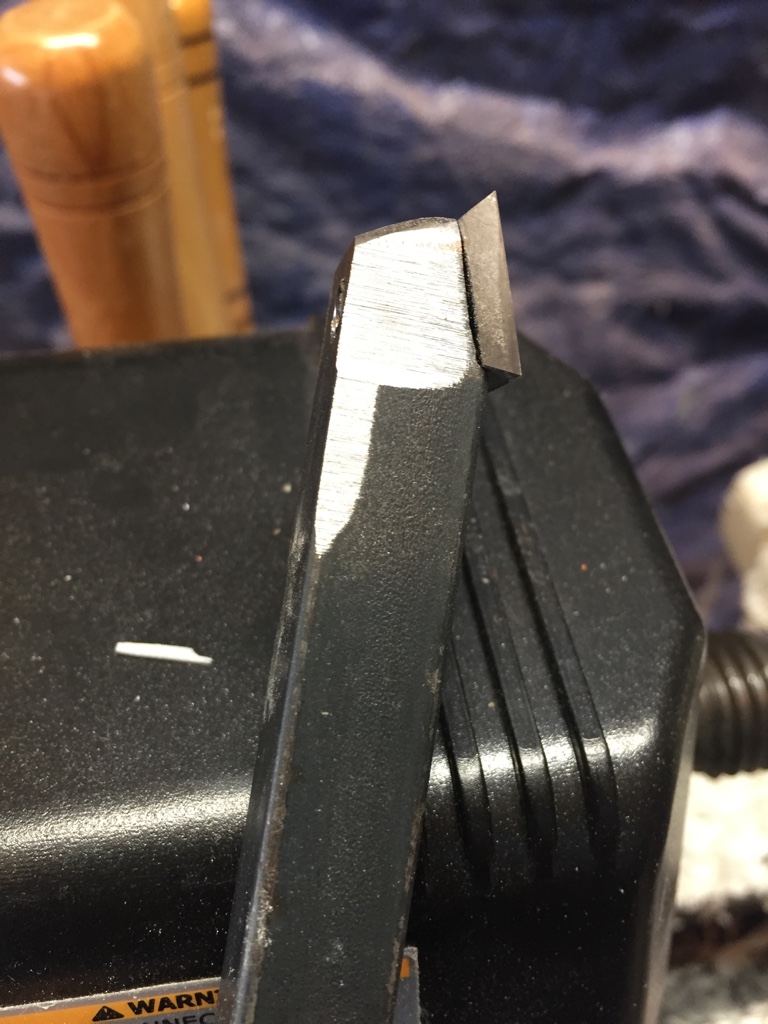

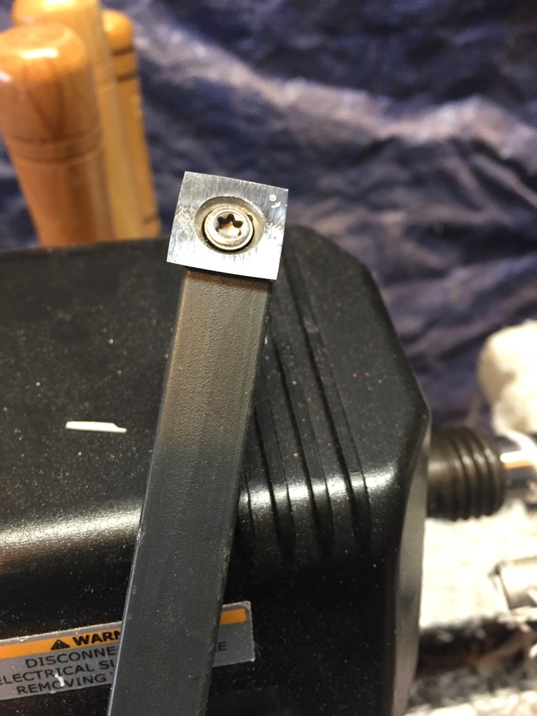

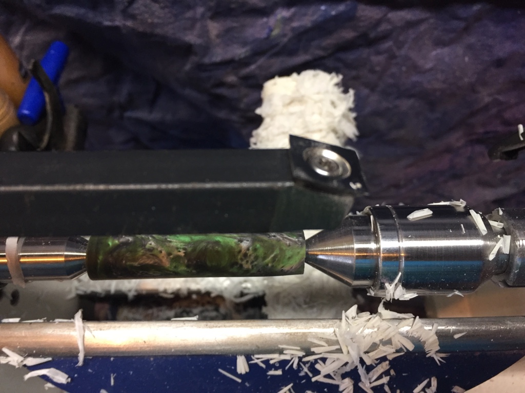

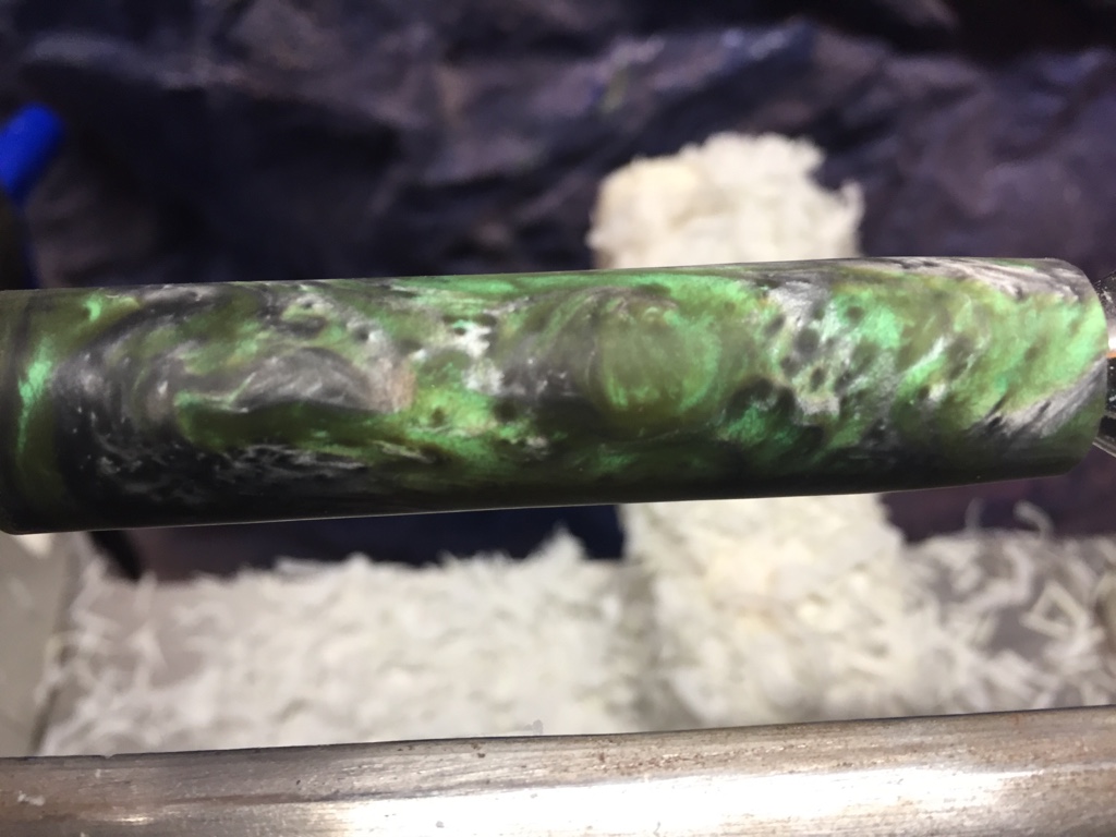

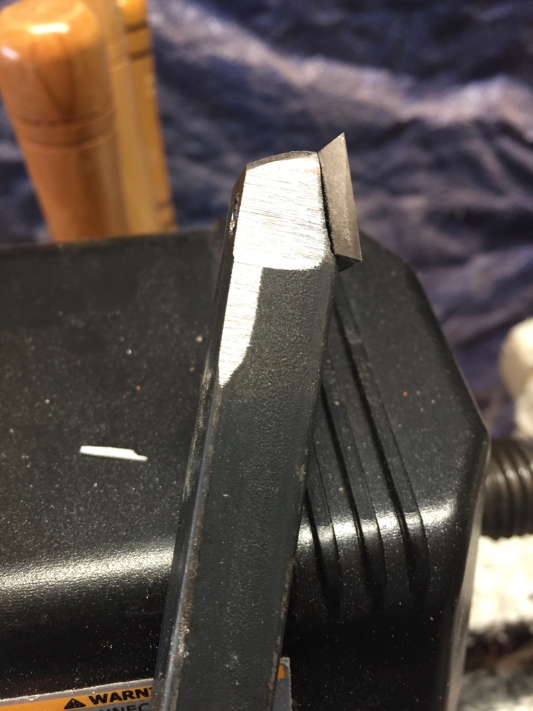

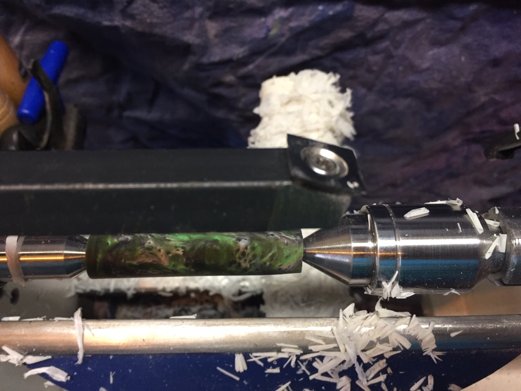

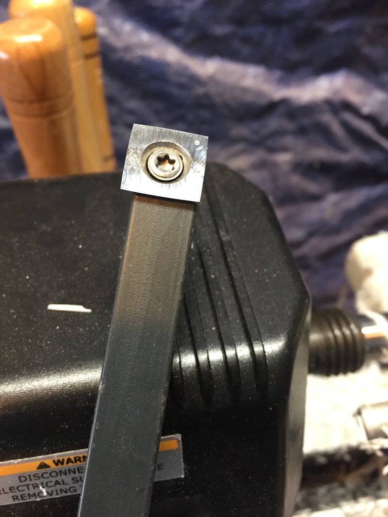

I made a tool where I mounted a regular carbide cutter at a 20 degree negative rake. I turned some inlace acrylester and the finish was close to final without sanding. The carbide insert was $2.

Thats actually something I would have never though of.....did you have a hard time grinding the 20 degree angle? Also, is the screw hole also at a 20 degree angle or is it still straight?
I bought some 1/2" square rod and ground the angled flat on my belt sander. I marked both sides with a 20 deg angle and ground to the line. I then mounted the rod in a drill press vise so the ground surface was flat and 90 degrees to the drill bit in the drill press. Drilled and tapped to match the screw. I have an aluminum handle that can accept the square profile of the rod with some slight fitting.
Someone pointed out you could just lift the handle to 20 deg. with a raised tool rest and get the same effect.

Great idea. Since the carbide insert is a normal, flat one, you can re-sharpen it with a diamond hone to get more life out of it. It would be tricky to re-sharpen an insert with a negative rake.
Two reasons I made my tool was to be able to sharpen the tool and to be able to get inserts for less than $15 while benefiting from the finish of a negative rake cutter.
