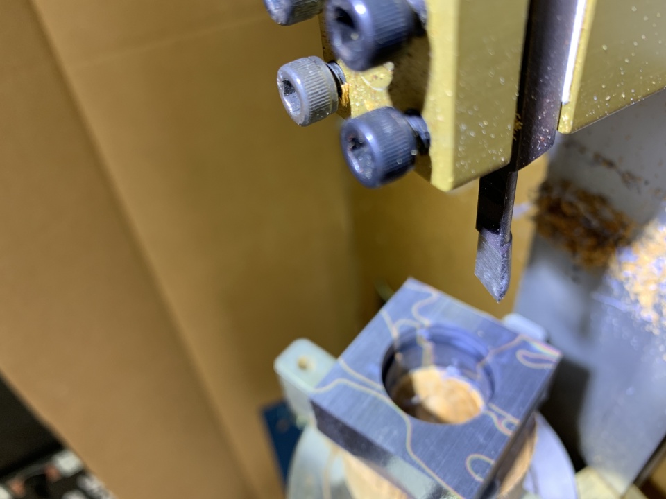

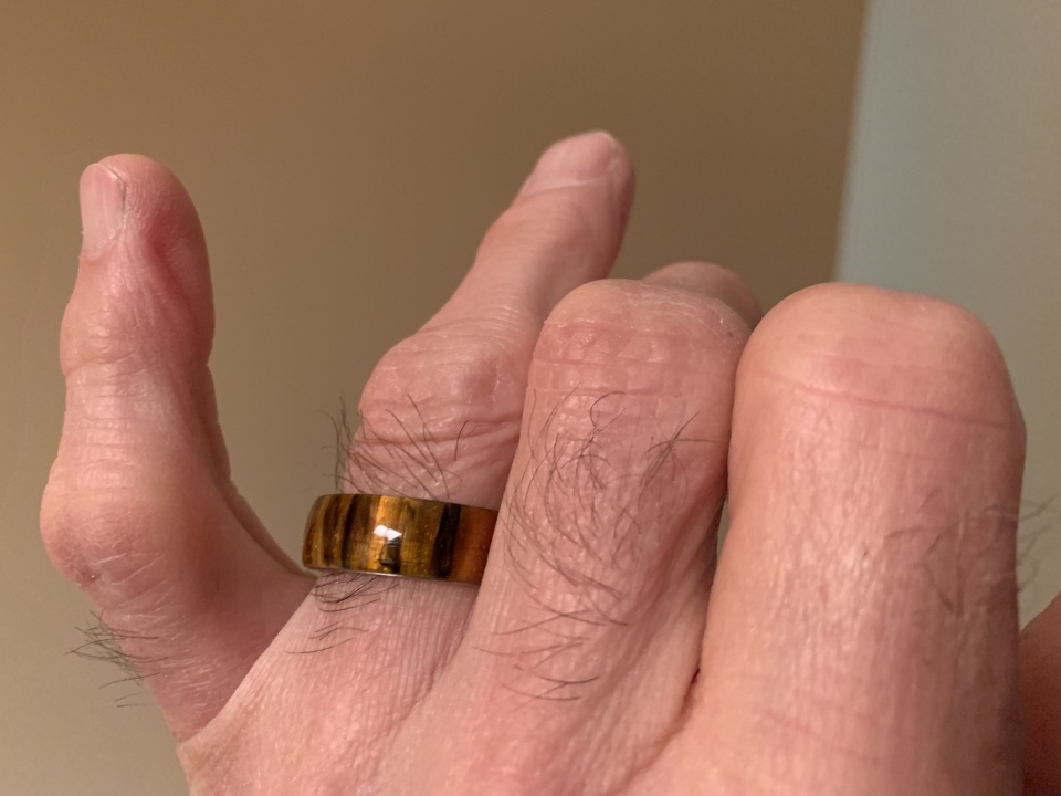

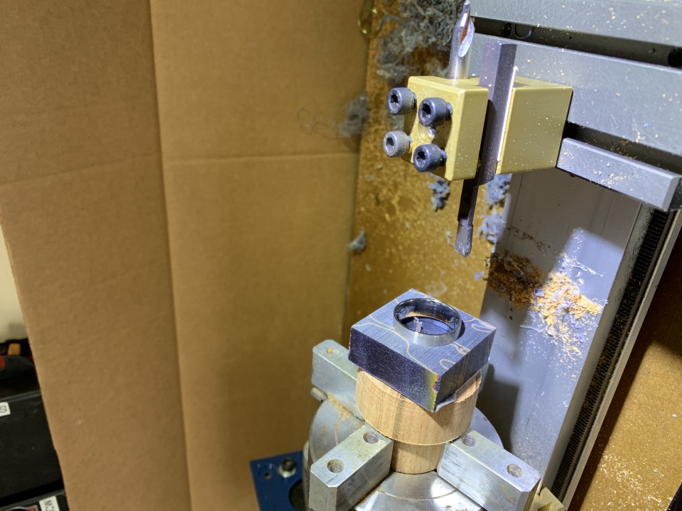

Hi and thanks. I will contact you. I'm not a fan of the double sided tape system. That has to go. Aside from
that I used the Taig lathe on the second turning
using a boring bar. Got a really nice clean hole. I know it'll get better. My first ring. Has flaws and metal needs some polishing.

JDG at CraftSupply, is JD Gautier. He supplies other accessories for ring making, that aren't carried by CS. Some really cool blanks as well as a boring bar setp for a morse taper.
https://ringsupplies.com/collections/ring-making-supplies
Thank you. How does that boring bar work on a spindle lathe.
Nice ring, Frank! - keep it out of the lake.
Thanks...Bob...It'll be ok....I used acrylic.

Using acrylic for now. I enjoy working with it. Wood finishes beautifully but a mess to turn. With acrylic I can wet sand the core if scuffed.

I have not actually used the head, I used to make rings, so I still get his notifications. I believe the end of the boring head moves horizontally. He appears to be sold out right now, but if you contact him, he'll be able to tell you when they will be available again.
Hi everyone. Sorry to get mushy. Sorry to get emotional... but I love you guys. A few weeks ago I was ready to quit (rather quit than give up) ring turning. As fast as I started that's how fast I was going to quit. But y'all encouraged and supported me so I hung on. Just finished ring # 4 and it's getting better. Another one or two and I'll be a pro. The Taig lathe with a boring makes a difference. Rings are fun. All being gifted. Making for friends. The close one's. Thanks again for your help. It's people like you(IAP Members) make the difference.
