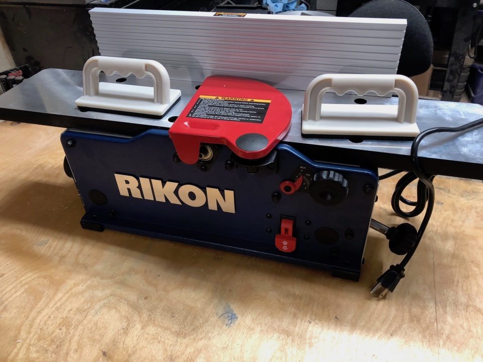

I recently purchased the Rikon 6" Bench Top Jointer. I bought it from Rockler while it was on sale as part of the Black Friday specials. I plan to use this to help with my box making and segmenting work. I hope to streamline my process a little from what I have done in the past.
If you own this product, what are your top tips for setup and use? I am most curious about how you set the fence angle and how well it has held the angle over time. Did you set and do you use the hard stops at 90 and 135 degrees?

Not a fan of a bench top jointer but that is a story for another time.
I do not know this jointer but like all other jointers there are basic rules and things to check for. I do not know if this is a 2 blade, 3blade or helical head but no matter what first thing is to make sure the blades are secured tightly before starting. Not sure if they use jib screws or something else but make sure blades are bottomed out and seated properly and tight. Make sure the blades are facing the same way. The motor spins toward the infeed table so blades are top up in the back of the holder.
Next make sure the infeed and outfeed are coplaner in that they are flat and match front to back and side to side. To do this raise the infeed table level to the outfeed table and lay a straight edge rule or piece of aluminum across both tables and all points should touch all the way across. There are screws for adjustment somewhere on the tool and you need to read instructions to do this. As I said these are basic setup rules. Now lower the infeed table and make sure the table lowers equally and the same space is equal throughout the table. Yo do not want a dip in front or rear of the table or it will cause snipe.
Next you mention preset stops. Take a square and lay on the table and adjust the fence to the square and set your stops. I never trust them when doing exact work. I always check even though the stops are preset.
Now if all is setup right the blades should be set evenly across the table. There are tools to use to test this and to set blades if changing. But a simple test is a straight stick of wood. and some magnets. I have a couple jigs but there are many of these type videos on the net for simple jigs. Here is one.
www.youtube.com/watch?v=pxKgFSEtSxc
Other notes:
- Never take too much off in one pass.
-Slow even doward pressure and keep flat against fence and keep feed rate constant and no stopping
-Apply pressure to infeed table and switch to pressure to outfeed table when you get board pass the blades.
-Always use push pads and do not let hands travel over blades
-Make sure the blade guard works properly
- All wood will have grain and you will notice if you plane one way you may get chip out and if you reverse the feed you will get a smooth cut. Gets tricky with burl and wild grain woods so it may come to a trial and error thing.
-Most tables come with machine marks in them and I always find this helpful in that it slows the feed rate and yes a bit more drag but I work with that to may liking. Some people will wax the tables and make them slick. If you do be careful of wax used so it does not contaminate the wood and also does not make to slick.
-Be careful when using these type tools because they have tendency to move. yes they have rubber feet but they are so light weight they will move. Would be wise to anchor to a table or have stop blocks set up around the tool to keep it from moving.
-Also they will tip and this is one reason I do not like them so do not lean on edge of tables to make them unsturdy.
_Good luck and work safely.

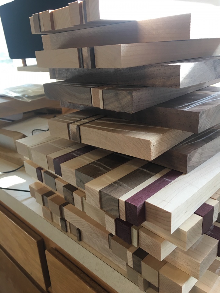

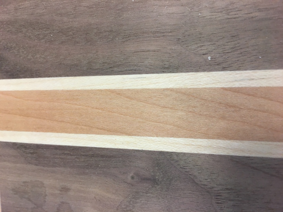

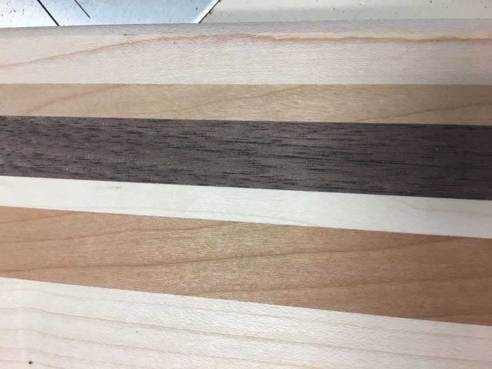

Photos (bad since the sun peaked out)
Shown in the photos are seven 12"x11" cutting boards and eight 9"x6" cheese cutter boards. Each has many strips. Each was jointed in both sides after cutting them to size. Glue and clamping is next.
The shop made push stick is shown too. The next one will be 12" long and the same height which clears the tall fence. Note the thin (1/8") nub that will not slip as the piece is pushed forward. The large dowel handle gives both forward and downward pressure.

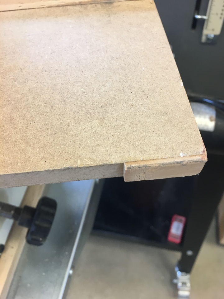

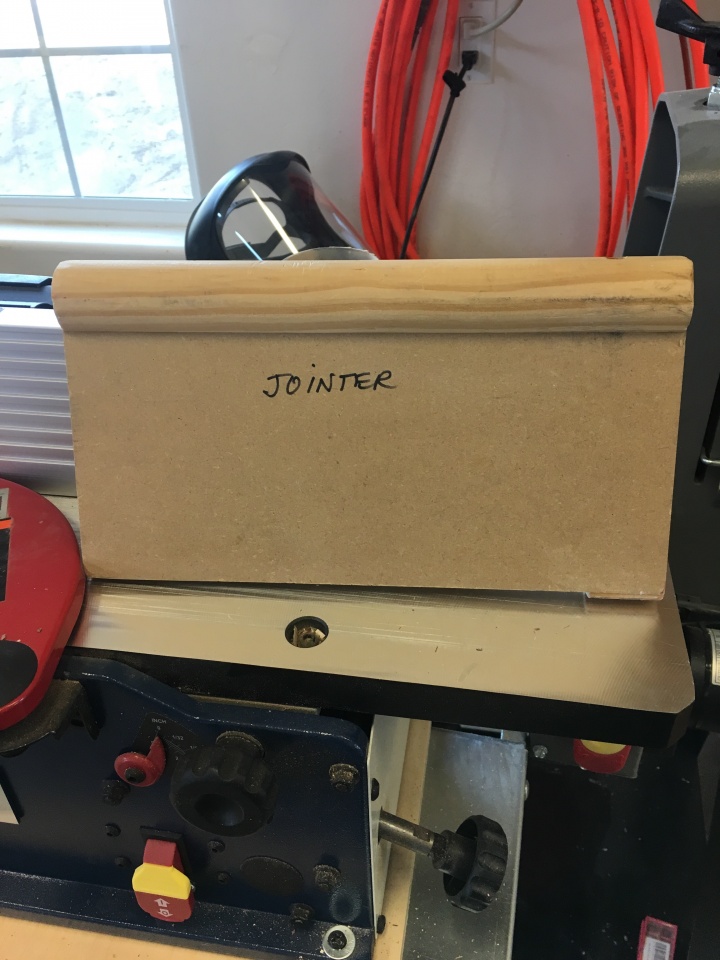

I have recently acquired the exact model jointer, but have not used it yet. I just want to add this one tip from previous shop work experience, which I might employ, depending on future results. At the cabinet shop where I was employed, we built mid-grade custom cabinets. The somewhat under equipped shop had a humble 4 Inch jointer, with fairly short beds. Short beds will not yield a straight jointed edge on long stock that starts out being a bit curved. Even after multiple passes, the curve will still be present. That is one of the reasons larger, more expensive jointers are 'long-bed' units. The solution at this shop was to build an extension on to the outfeed bed, since that is a fixed bed. I envision securing a 10~12 inch extension to the outfeed bed of my jointer, if I experience any persistent curved edge problems. You may want to try this if you are working with longer stock. There are other techniques to eliminate the curved edge, but a longer bed jointer will take care of it.
I bet you lost more wood that way because the infeed table the board was hanging over. I think either ripping on a table saw or skil saw would work better with a straight edge. :smile::smile::smile:
I bet you lost more wood that way because the infeed table the board was hanging over. I think either ripping on a table saw or skil saw would work better with a straight edge. :smile::smile::smile:[/QUOTE]
That could happen to an inexperienced user of the tool, and is something to be aware of. I was just suggesting a simple mod to a small tool that would enhance its effectiveness. I would typically take multiple quick partial cuts right on the jointer to get the stock to the point that the short bed would handle it and yield a straight edge. There are numerous techniques that are quick, and work. Making a living at woodworking only works with high productivity accompanying high quality. During six decades of fine woodworking, one learns many small techniques that work...quickly. :wink:
