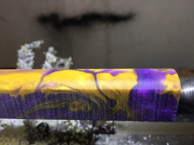

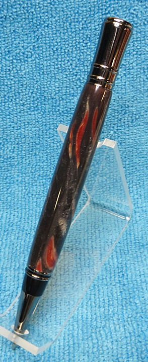

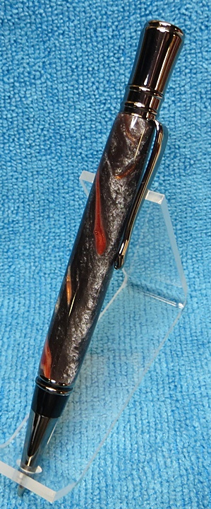

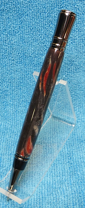

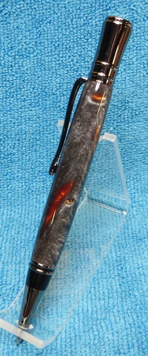

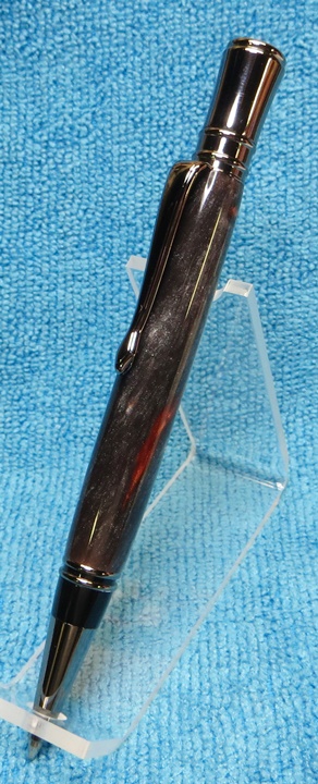

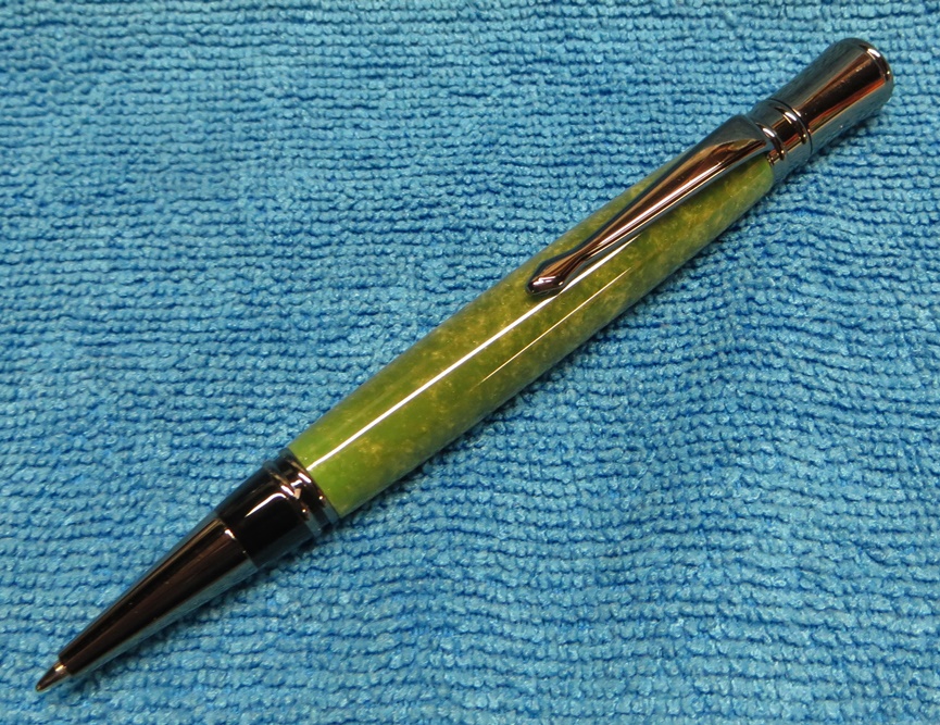

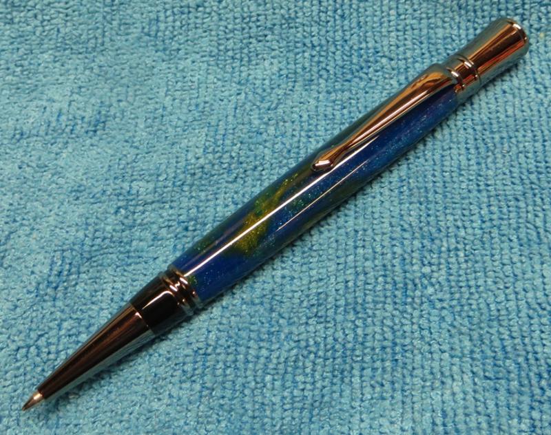

I've turned both, and find them both challenging. I trim the corners off with the bandsaw before turning, which seems to help. I find inlace to be more "chippy" than rhino. So much so, that I refuse to turn inlace anymore. The blank in the photos is a rhino.
Trimming is a great assist. Both are challenging, and both turn to a wonderful shine. Very nice final blank.

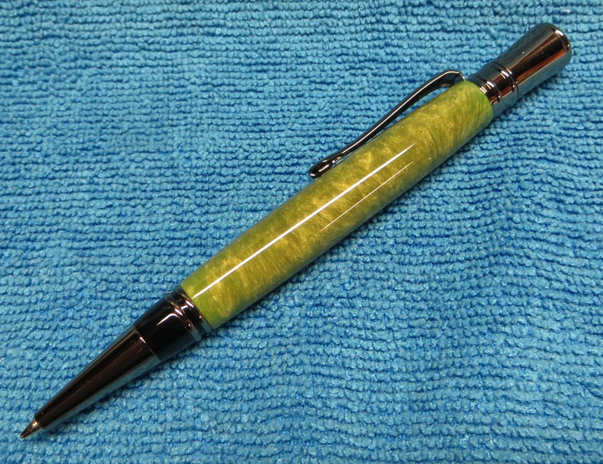

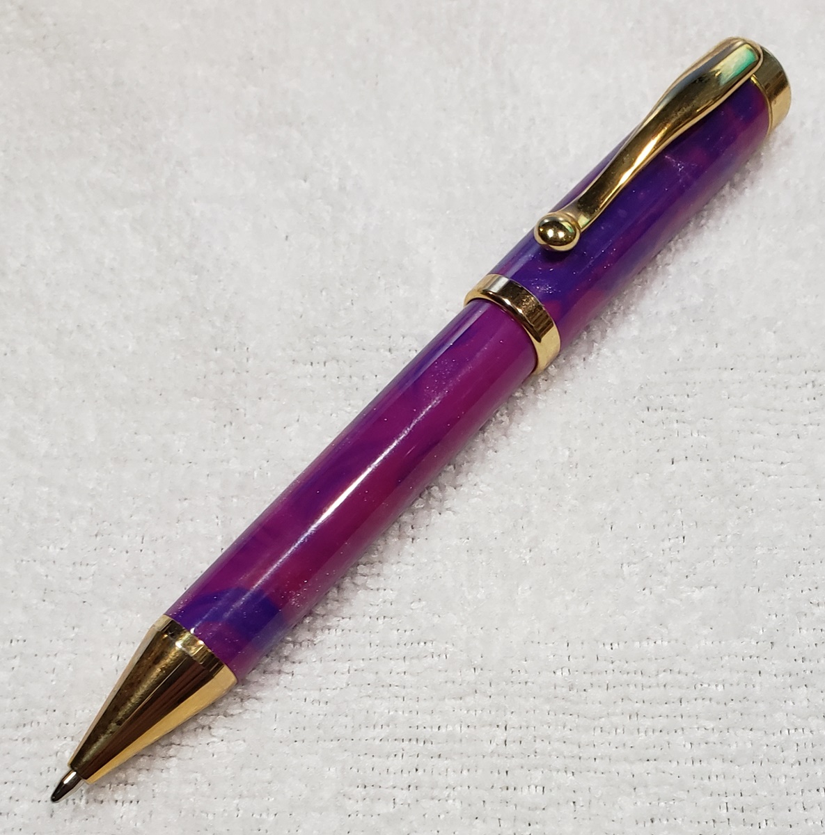

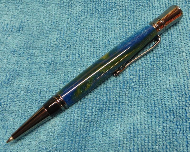

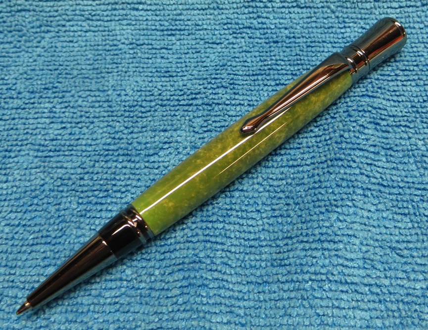

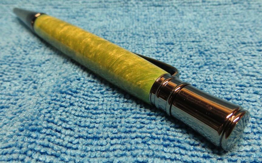

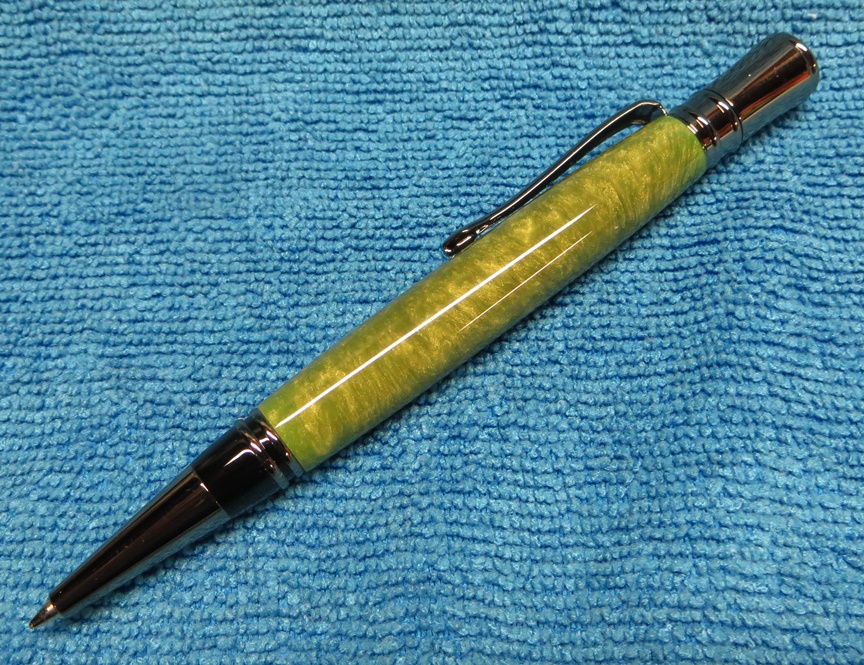

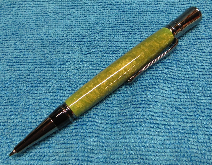

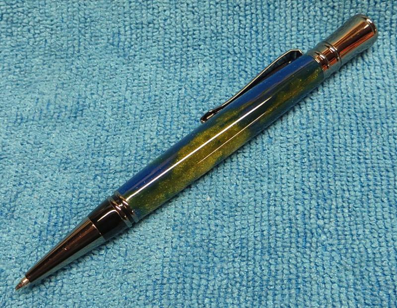

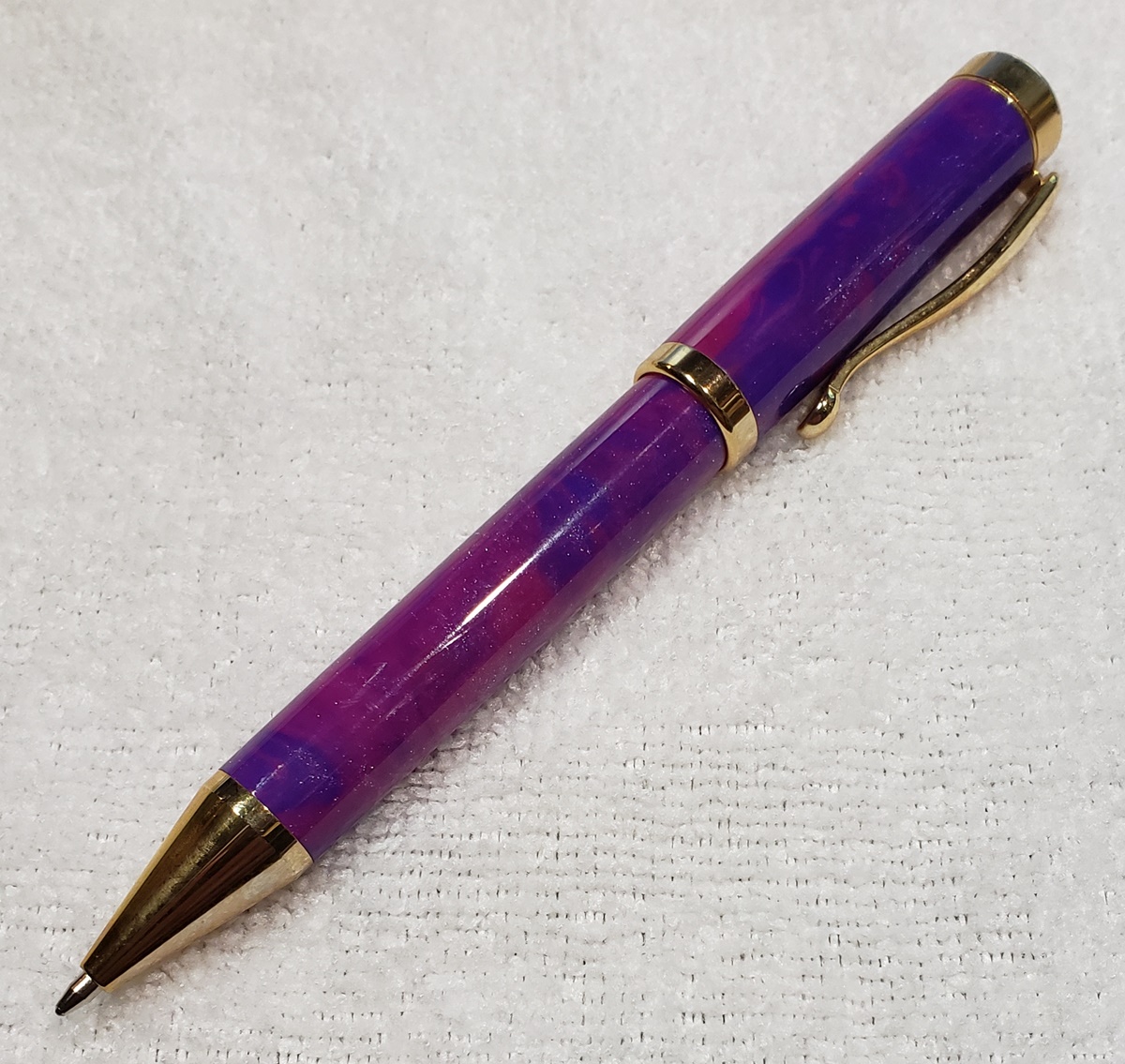

One of my favorite blanks is Rhino Parrot Bay. Like many Rhino blanks, it has an underlying sparkle that I really like. Like others, I do knock the corners off, and go slow, but do not have many problems. Try some.
My own turning experience pov - I have found acrylester to be more brittle than Rhino. I love both materials.
Parrot Bay is a nice one.

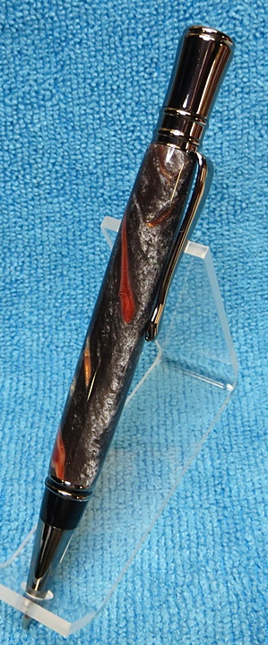

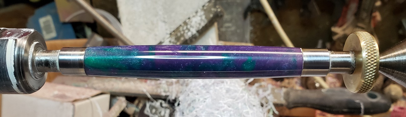

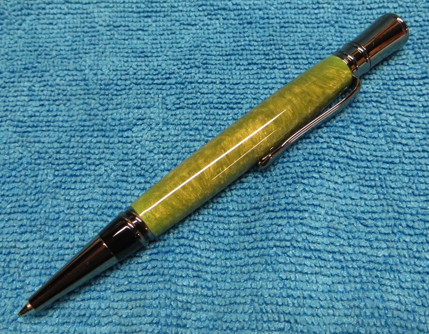

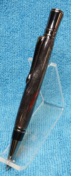

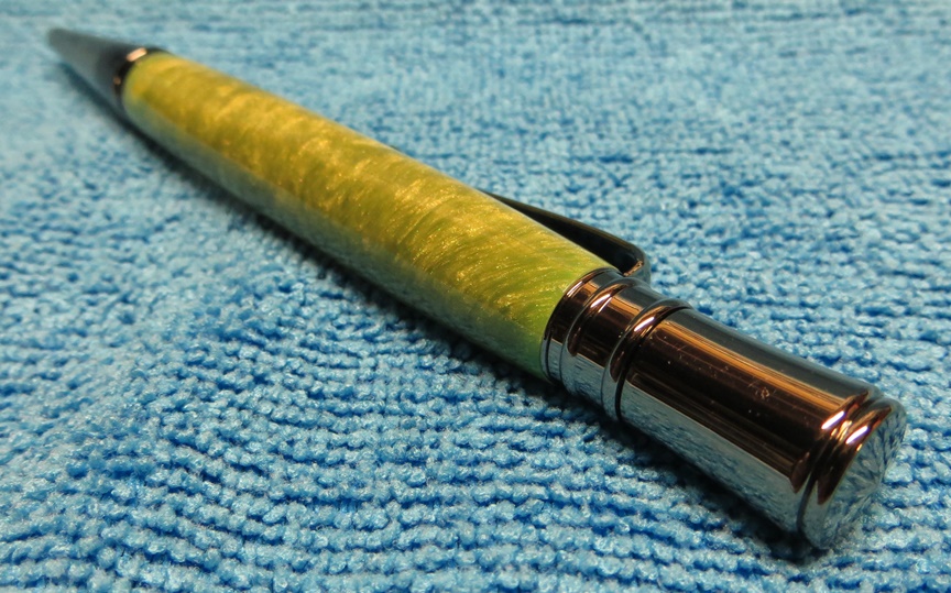

Wasabi Peas is one of the few Rhino blanks I wasn't very impressed with. But I do like the name. LOL

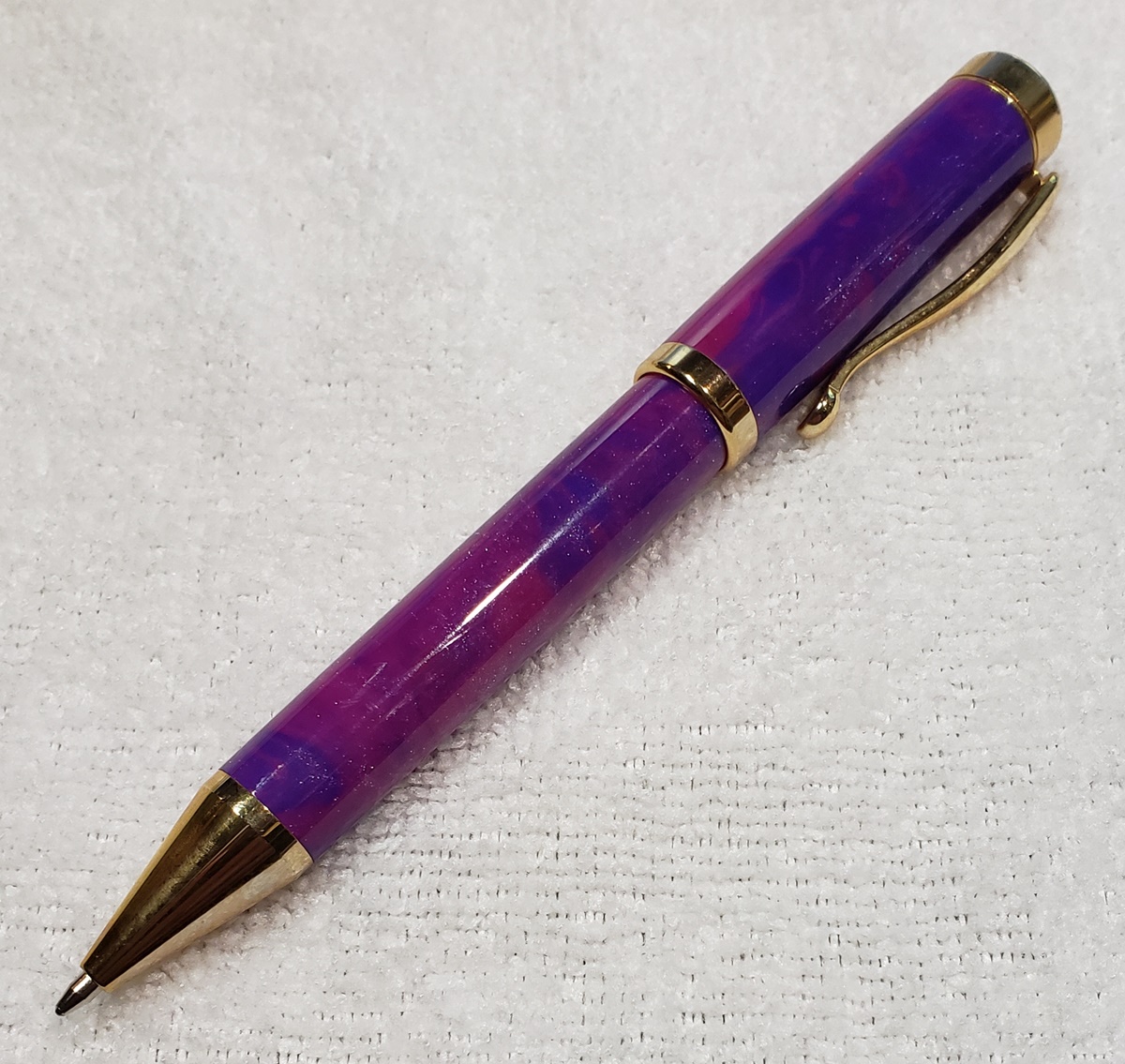

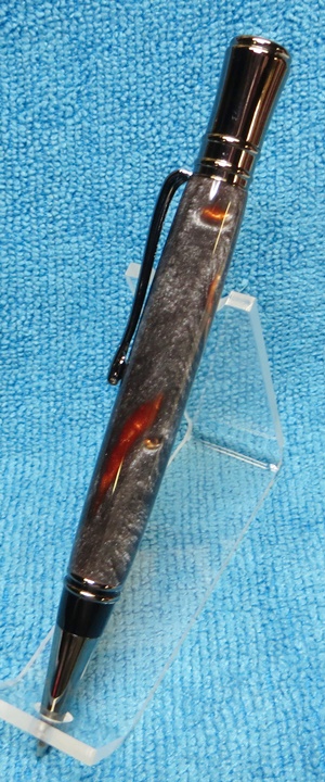

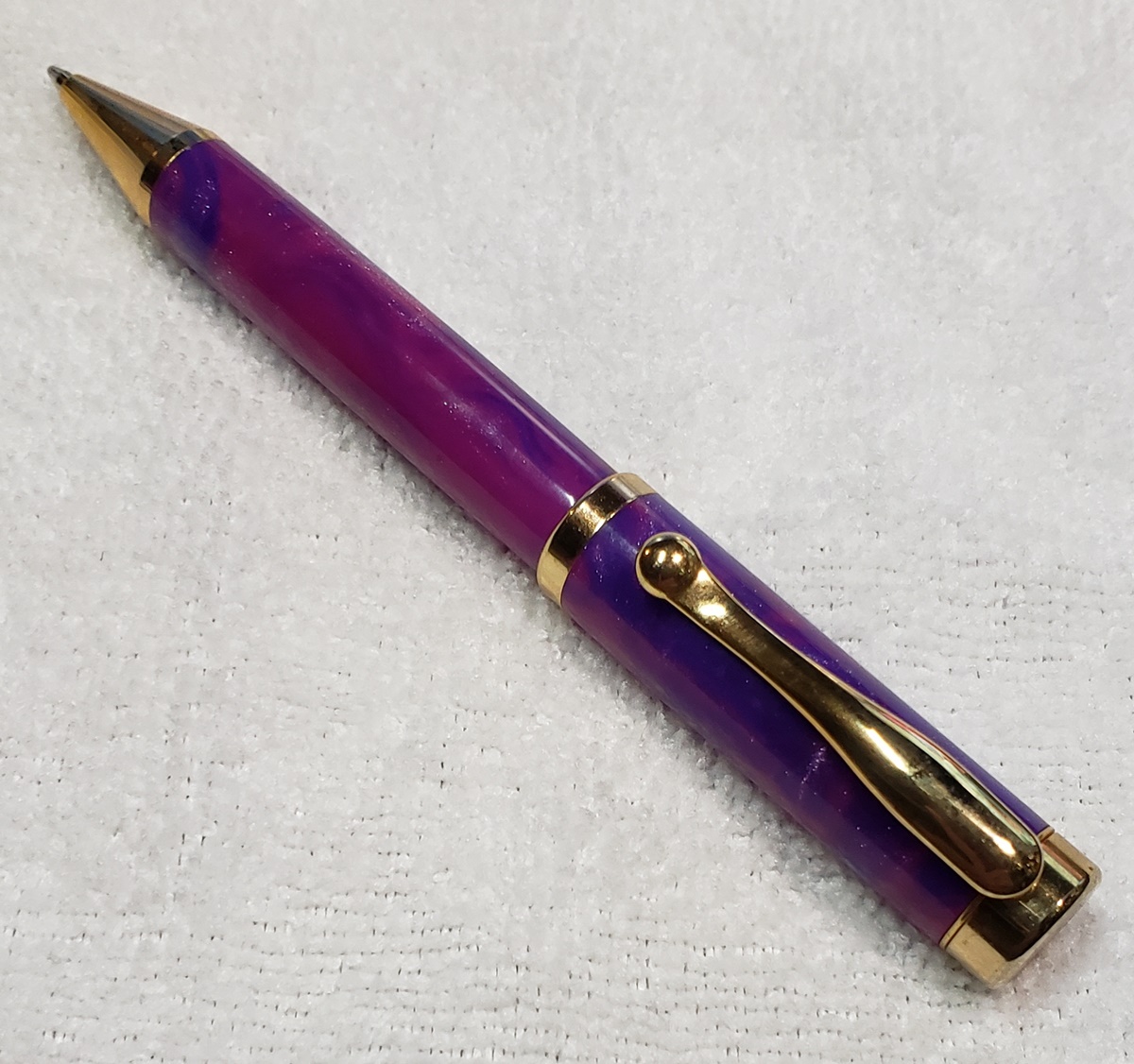

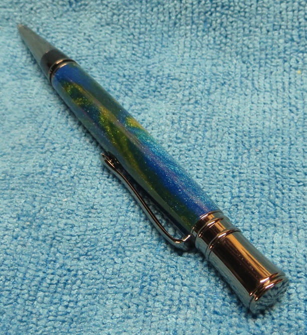

Earths Core is one of my favorites.

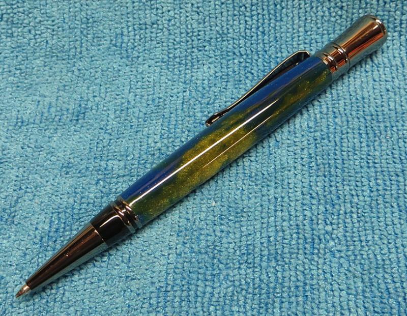

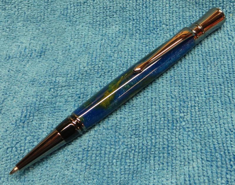

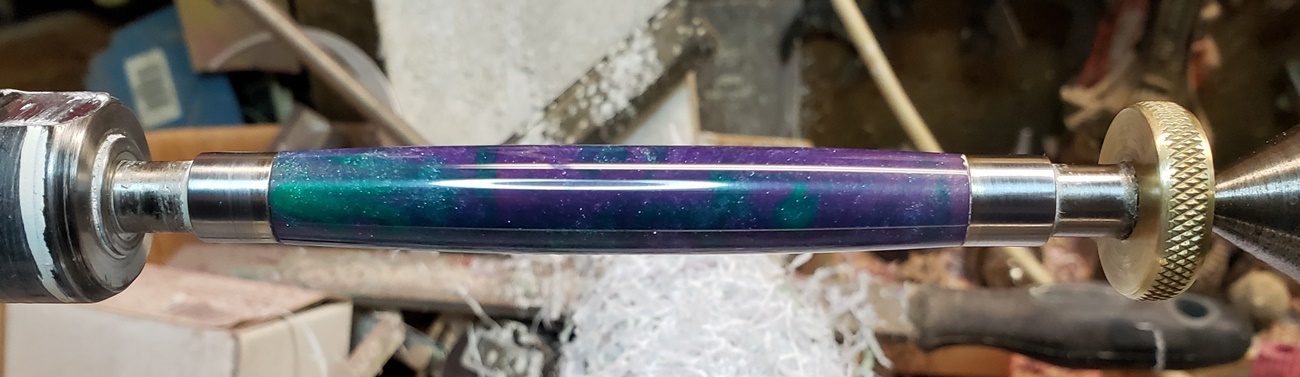

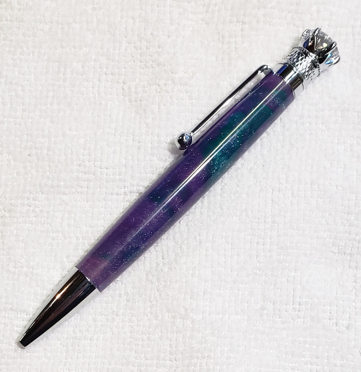

One of the most beautiful pens I have ever made came from a Rhino blank called northern lights. I wish I still had a picture. I do find image to be more chippy than Rhino as well but I typically don't have a problem with either one once they are round
Sent from my SM-S727VL using Tapatalk
One of the most beautiful pens I have ever made came from a Rhino blank called northern lights. I wish I still had a picture. I do find image to be more chippy than Rhino as well but I typically don't have a problem with either one once they are round.
That's one I haven't tried. My daughter-in-law would love that.

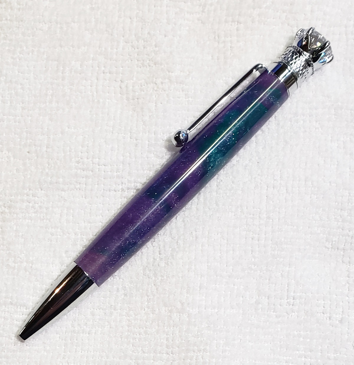

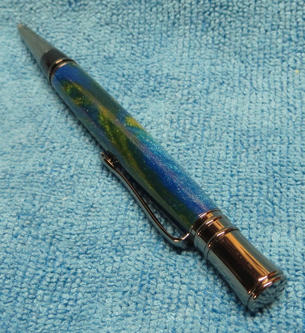

I guess I have tried Northern Lights after all.

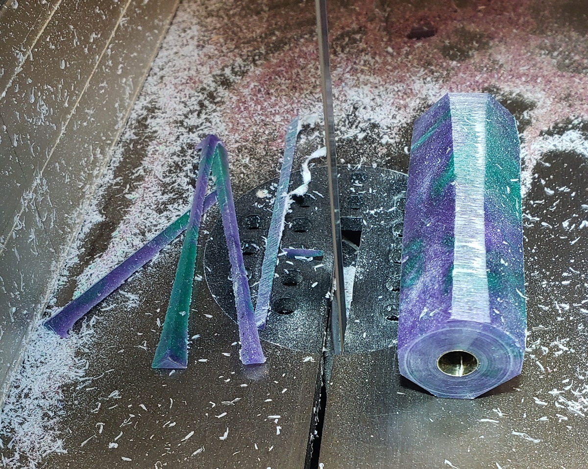

For larger, 1-1/2" x 1-1/2" blanks, I trim the corners with a small band saw, which also works great. Taking care to not overheat the material.
