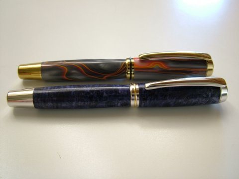

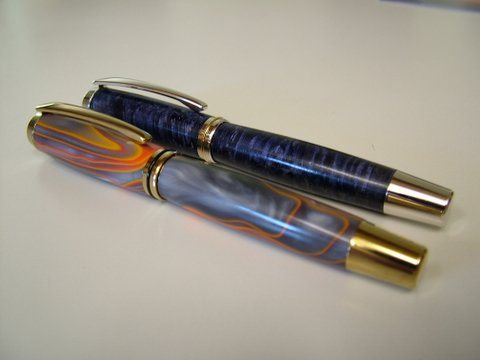

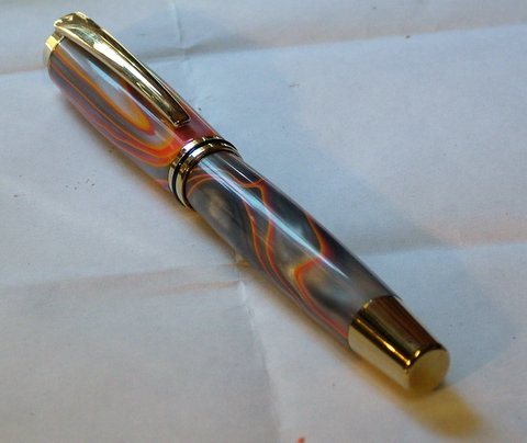

I haven't had time to do much turning lately so my son and I went out to the shop yesterday and turned a couple of Jr. Gent pens. OK- so I turned the pens and he built shapes out of pen blanks, but you get the picture (he's 3). He picked out the first blank- Orange celluloid (sanded to 12,000, no finish) and I picked the second one (non-stabilized Box Elder Burl). The Box Elder was very dry and white but had great figure to it so I sanded to 400, dyed it black, cut it back with 400 again, dyed it blue, sanded through 12,000 then dyed it blue again. Finished with Master's Magic Spray Lacquer, of course :) No time for segmented work on these ones. Comments are welcome.
You can see a cut of the original blank on top of the spindle- pretty white stuff, great for dyes.

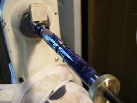

Is there drying time between dye coats, Nils? Or do you sand to generate heat to dry?
Nice results, no matter the technique-just wondering.
nilsatcraft
Feb 4, 2005
503
Provo, UT, USA.
Thanks for the comments. I was curious to see which pen people would like more. As for the dyed blank, I used Chestnut Spirit Stain, which I picked up from our Clearance Sale this past Wednesday. I used Black and Royal Blue. After stabilizing the blank with some superglue I used a skew to get it down to size and then sanded with with 320 and 400 grit paper. I applied black dye and then sanded at 400 until about half of the black was gone. It had a really cool pattern at that point but looked really grey. Then I dyed it blue (I just put some dye on a cloth and rub it onto the blank with the lathe off) and sanded from 600 to 12,000 Micro Mesh. From there, I dyed it one last time, using the dye that was still on the cloth. That last dye really helped. I sprayed it with lacquer and then (for the first time) attempted to sand the lacquer after it had set. It seemed to help a little but I think I'll buff it to smooth it all the way out.
