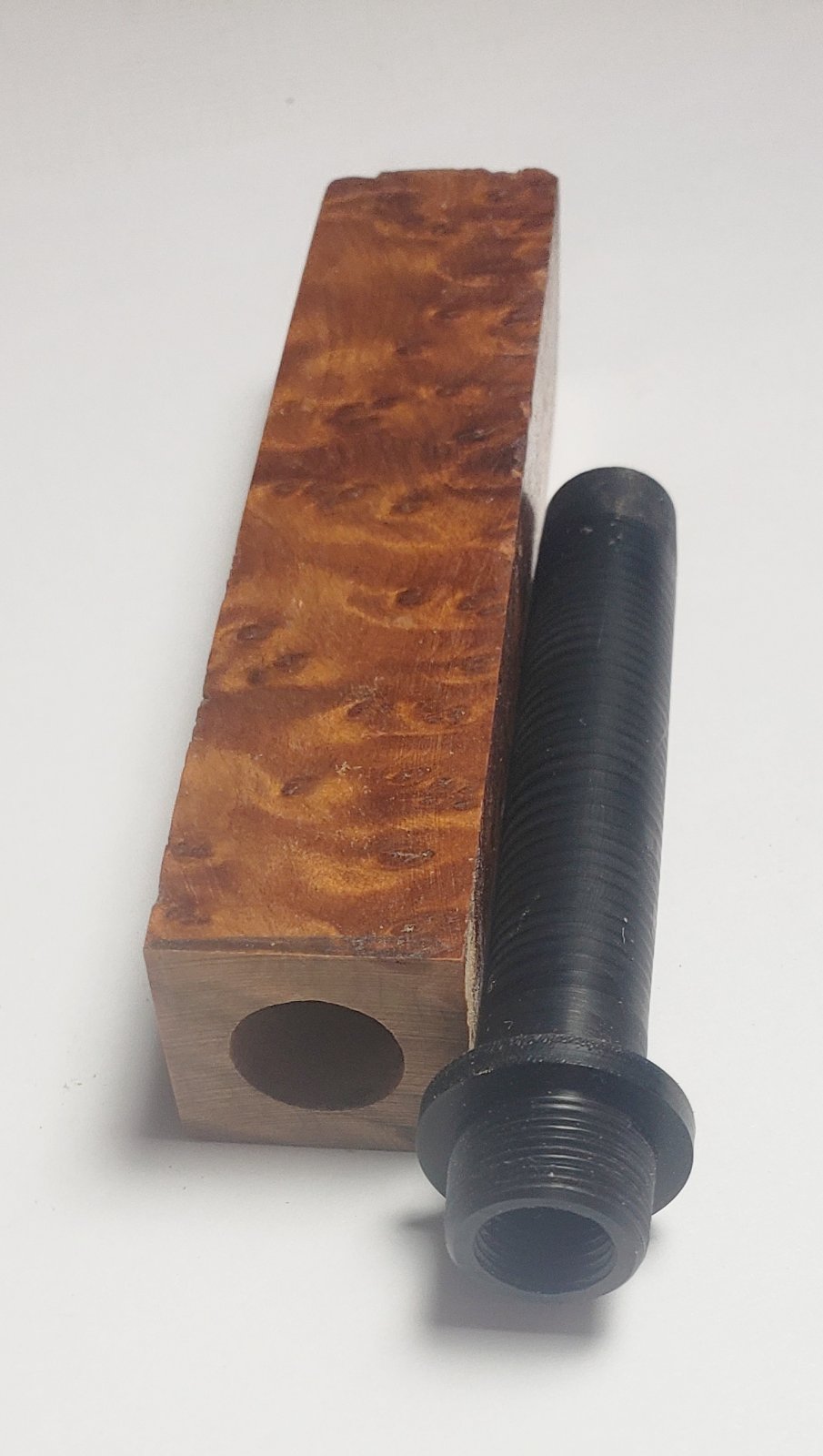

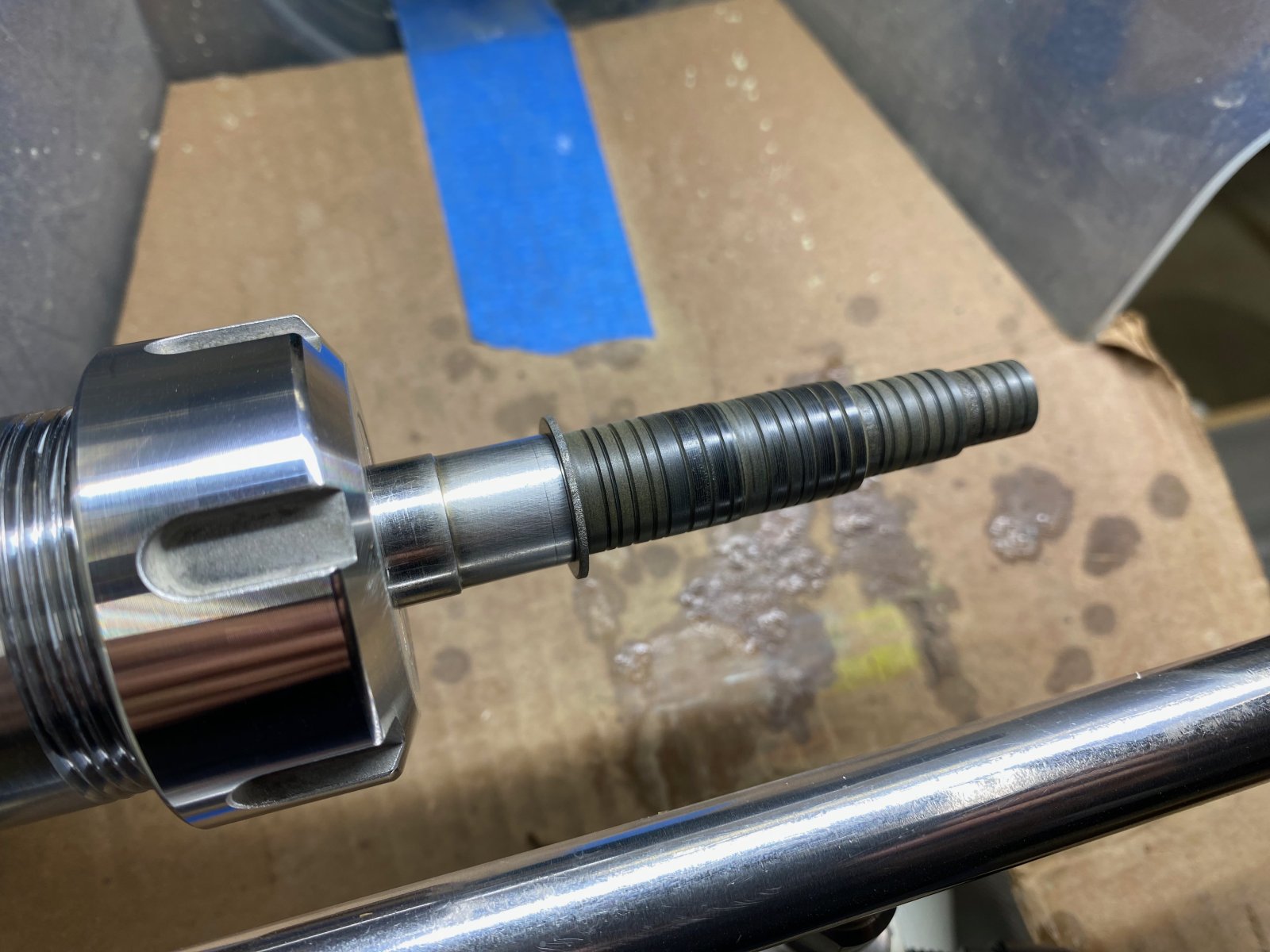

FYI... I always machine groves into my sleeves before using epoxy to glue them into the wood blank. Epoxy is a mechanical bond and needs something to hold on to.

What kind of groves? Vertical groves? Do you have a picture u could share? I just scuff em but i have made just one, so i am not an expert on this.cheers

As for the other materials, I have never cut grooves in my sleeves. I make sure it's not shiny, so at most I scuff them with sand paper. I've never had a problem.
