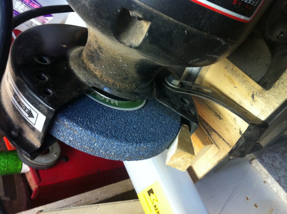

Yep, but it works. It doesn't take much. The cast part, not the tool rest. The wheels just need a good snug, not cranked tight. The nuts are right hand-left hand towards tightening as the grinder runs.
I am trying to imagine how that is going to look. If it isn't a big bother, can you send a pic? I will send you my email address if you decide to send a pic. Thanks either way. I am sure I will figure it out.

Those nuts do not need to be super tight. They tighten with rotation. I would just hold the opposite wheel with a gloved hand and tighten the nut. When they tell you to use a wedge they tell you to place it between the toolrest and the wheel not the guard. Never put pressure on the side of any wheel. You run the risk of cracking them. If you ever drop one just throw it away and never use it even if it looks good. Internal crack and you will have flying debris and chance of serious injury.

Pic
Here's a pic
