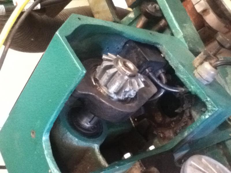

As you've seen the pictures of, I've got a Grizzly G5979 lathe, with broken pulleys. My dad and I pulled the first with a gear puller, but the second one won't budge. We've tried pulling, WD-40ing, hammer & chiseling, blow torching (the grease will catch on fire), drilling, and Dremeling.
We've lost a drill bit, a Dremel attachment, and about four hours. Is there
ANY advice you can give? this thing won't budge at all. I've looked for disassembly guides, but they all say, "Remove the left and right pulleys..."
Thanks,
Ryan
By the way, the pulleys are the ones that move with the speed shifting lever, not those that move from the motor alone.

Ed, there's got to be a set screw. I pulled on it some more. I was eccstatic that it was moving so much! Too bad the black box behind it followed. Do you have any idea where I could find it? I've seen several of these little tabs on it (pictures coming), but they don't seem to do anything.

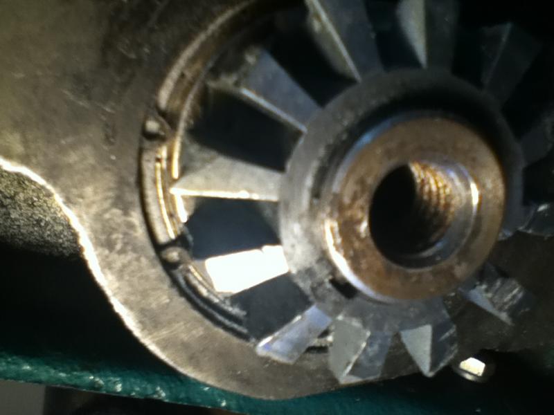

The second picture shows a couple of these tabs.

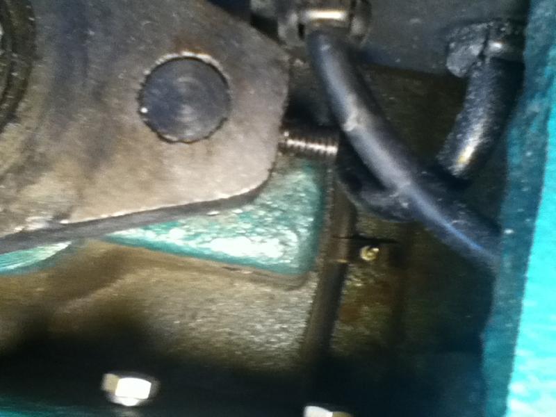

The third picture is a nut that looks in need of removal, but I have NO clue.

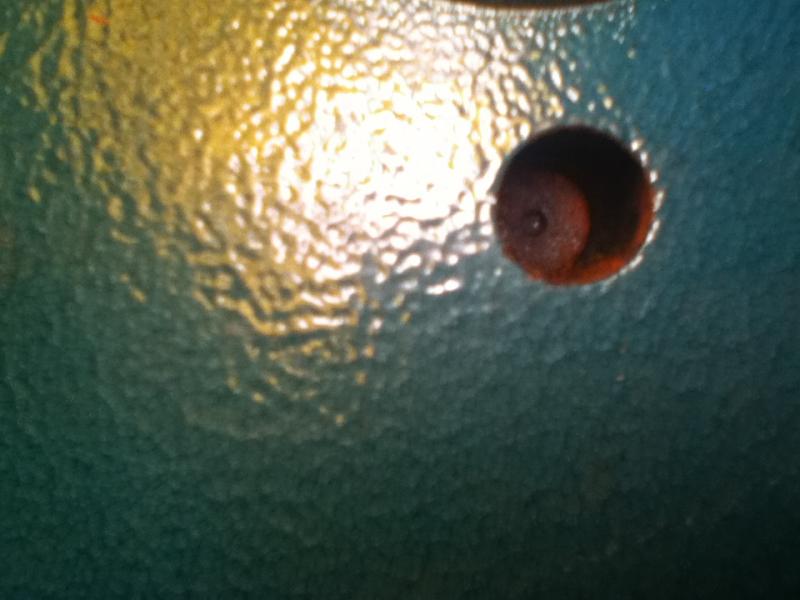

The fourth is the back of the headstock, it's just a round hole, not a screw.
