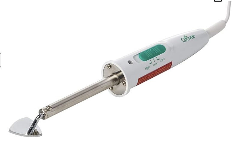

Ok thanks. I will experiment on scrap. I'm kicking around a small travel iron or a mini
iron
