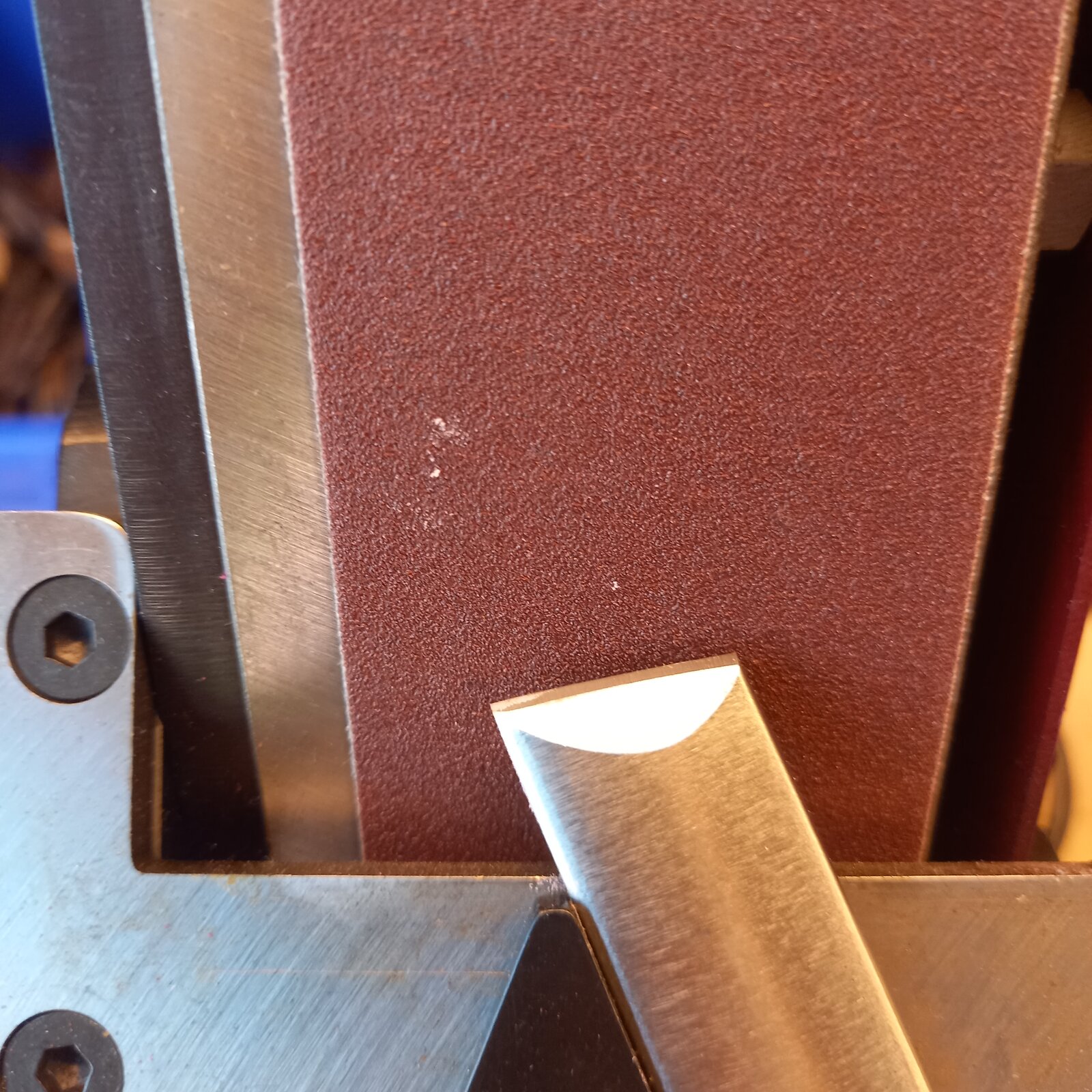

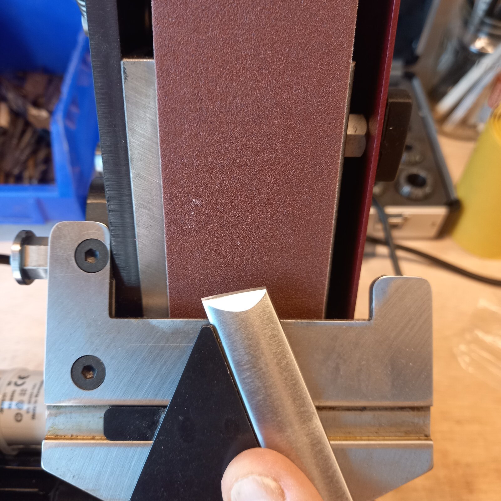

Hello,
I bought a sorby pro edge and a skew jig to go with it. Now I hold my Hamlet skew on the sorby and the angle is way off. It's so much off it makes me doubt what to do. Grind it down or send the jig back and do it from hand.
I could use some advice on this one.

I dont know what angle I want. But the jig is a fixed angle. I was just very surprised about the difference and it made me wonder what is normal and what to do. The angle I have is the only one I know

Skews are similar to bowl gouges in that there are different angles they can be grinded too. I do not know which angle is "better" than others as it comes down to personal preference and what you are use to working with.
Maybe verify with the jig maker what the angle is and see if they can answer your questions to alleviate you concerns.

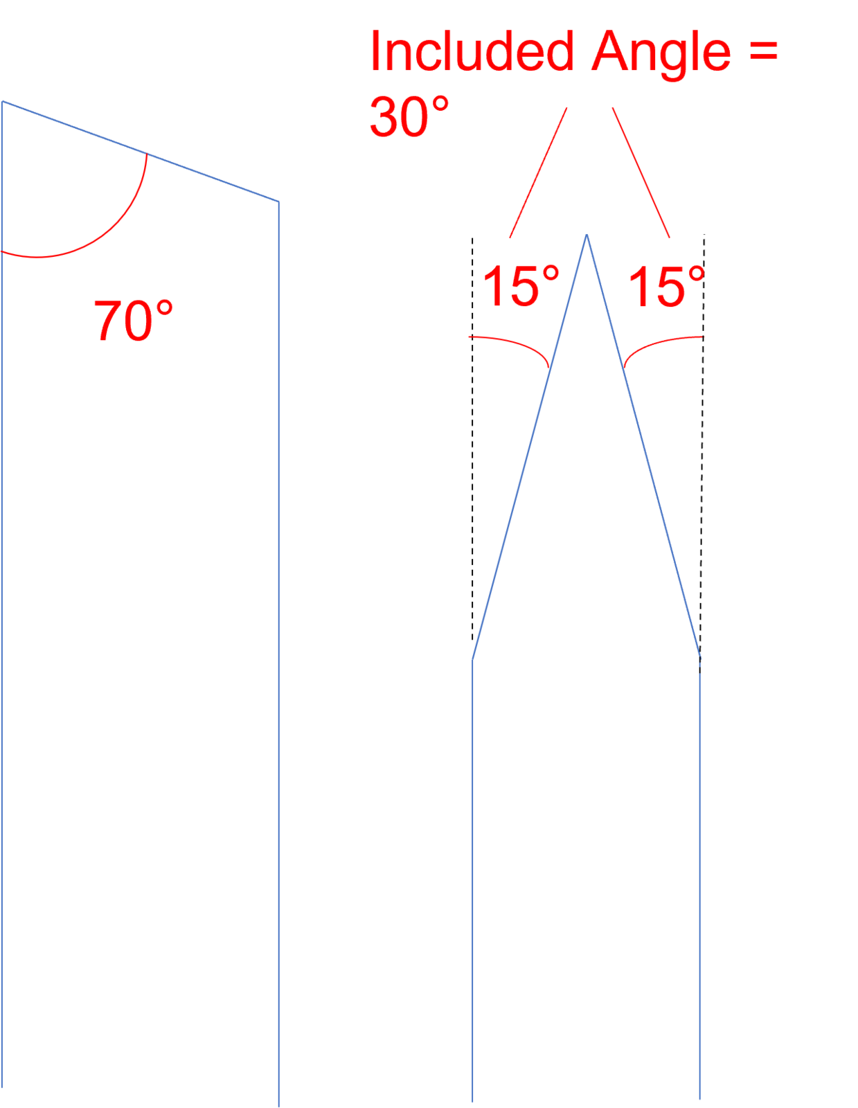

There are 2 angles for a skew. The point to point angle should be 70*. Yours doesn't look to be at that but the jig is most likely to be at 70*
the second angle is the bevel measured as an included angle. This is where personal preference comes in. mine is at 25*. Most people are somewhere between 25 and 40.
You really don't need to put that on the Sorby unless your intending to re profile it. Especially an oval one like you have. If you are not extremely proficient, I can almost guarantee you will ruin that skew.

I have the pro edge and use skews a lot. If you're already proficient in using your oval skew with that angle across the edge then maybe best not to change it. You could make a new jig or, a much easier option, you could make a little spacer that butts up to the jig you have that will sharpen your skew to maintain the current angle. You just need a small piece of 3mm or 5mm ply cut into a wedge with the compensating angle. It works fine as there isn't a lot of lateral force applied when you're sharpening. (I do this myself).
Alternatively make the decision now that you're going to adopt the angle that the jig suggests, put some 60 grit on the Pro Edge and regrind the skew using the jig (it doesn't take long). Then each time you need to sharpen you're good to go.

Here's a basic drawing of the angles we're talking about. On the left is the angle that the chisel takes its name from, which is typically 70*. On the right is the bevel angle, which ranges between 25* and 45* included angle, or 12.5* to 22.5* per bevel.
