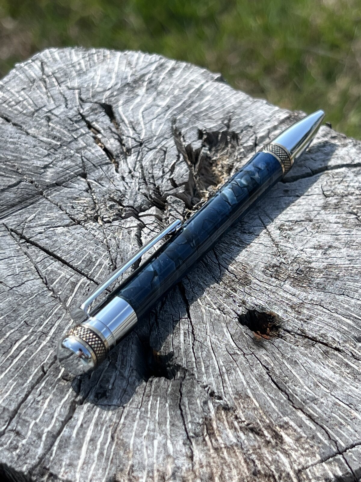

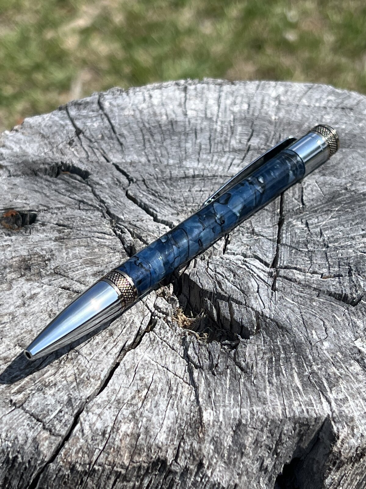

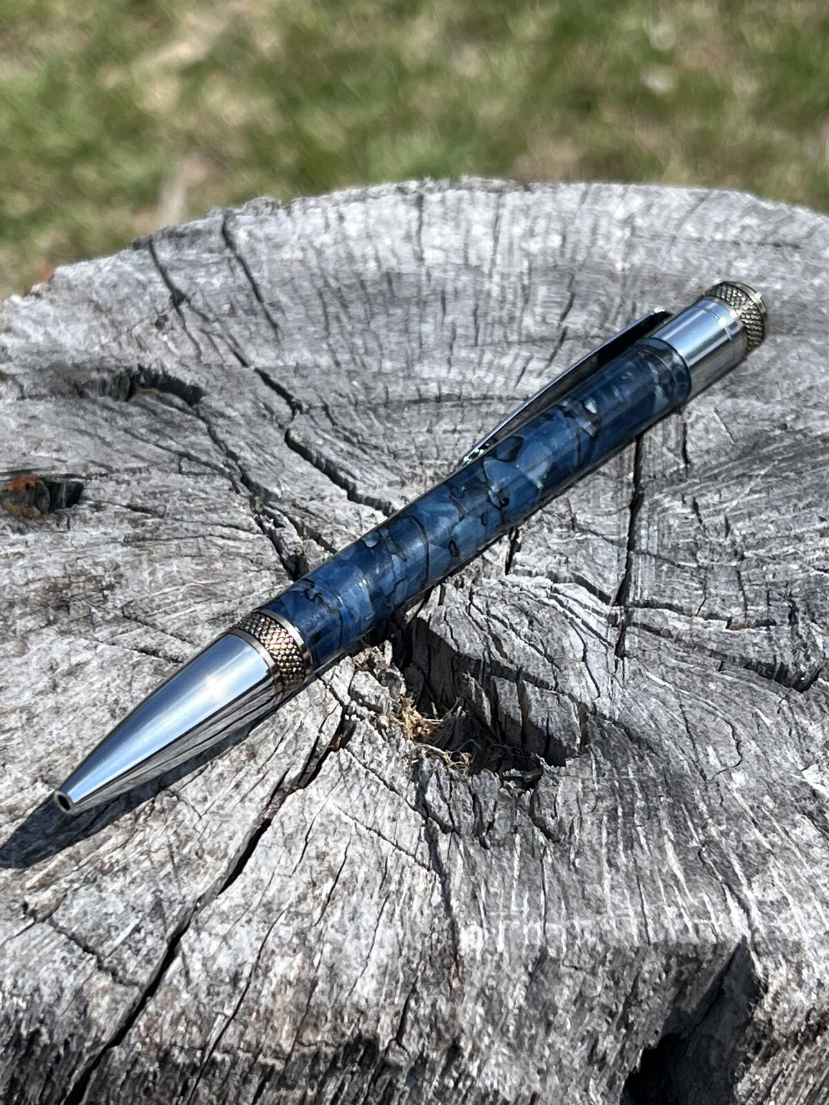

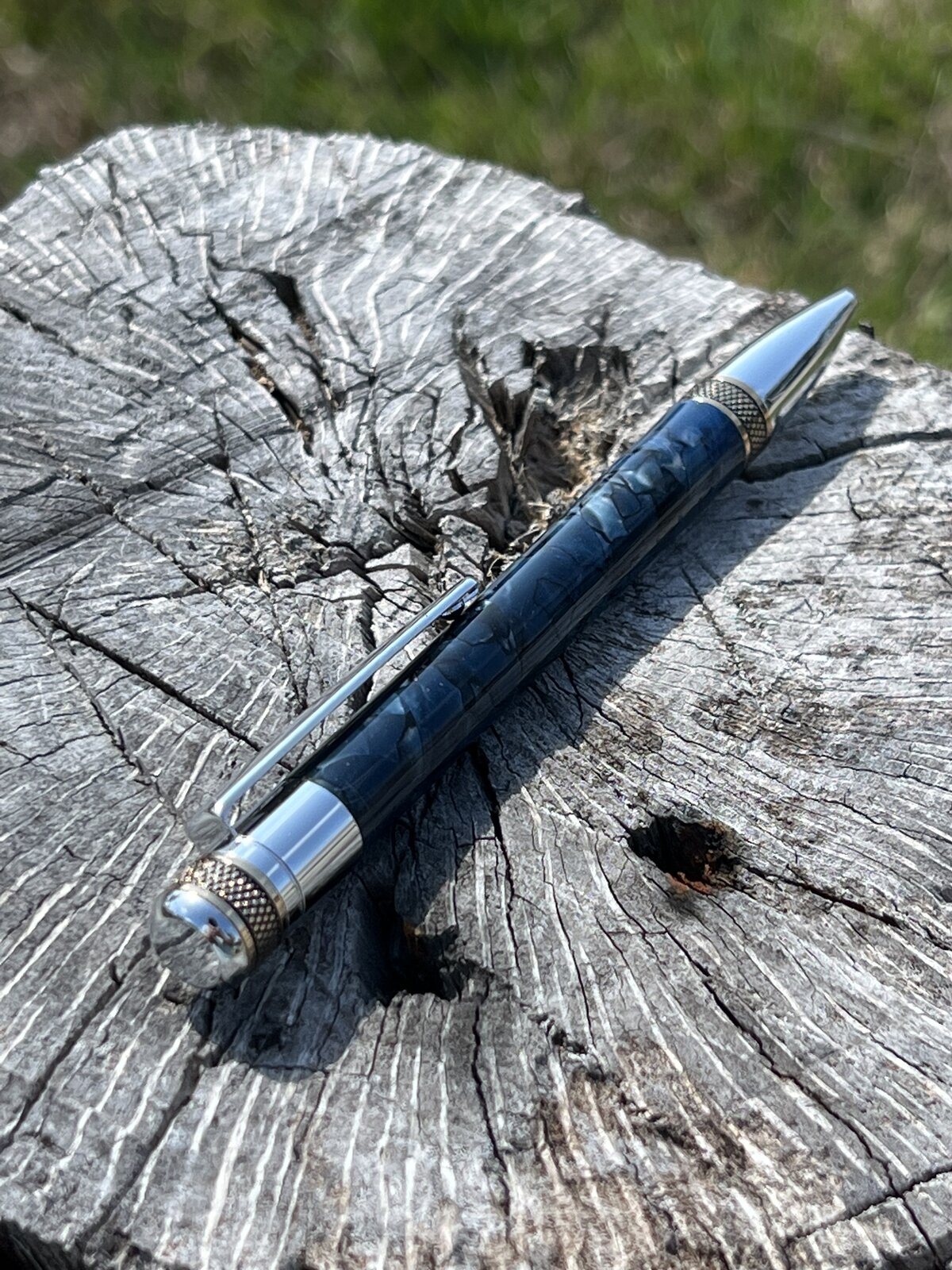

I'm glad you posted this. After seeing your post about the Cortona, I decided to get one epoxied and ready to turn with a vintage material...I think it will come out classy looking. I had forgotten what the upgraded refills were I had used in the past (I believe I posed the question here which led me to buying Monteverde refills from Exotic Blanks).
Again, thanks for your posts, and I'm glad I've stumbled back into both my shop and the IAP!

I had some sanding issues with this material. It's been in my shop without any form of climate control for several years, plus I'm no guru on vintage plastics polishing.

I had some sanding issues with this material. It's been in my shop without any form of climate control for several years, plus I'm no guru on vintage plastics polishing.View attachment 349534
Very Nice. The more I see this kit the more I am going to like it. Shows off alot of blank material. The components are not outlandish to look at. Thanks for posting. Looks good.
