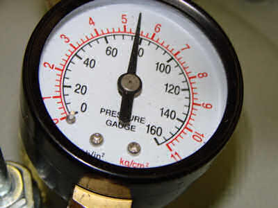

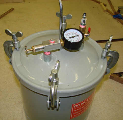

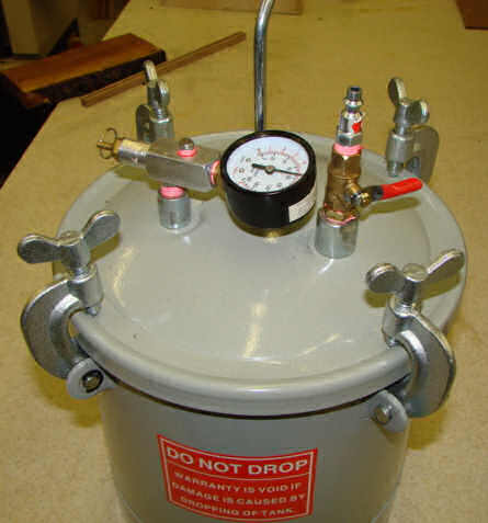

Recently, Reb contacted me about making a pressure pot for him. I decided to make it even more simple than the two I am using and really like the way it came out. This is for Alumilite and pressure only, no vacuum. The problem is, the darn thing leaks! I pressured it up to 80# on the dot and after 3 fulls days under pressure, it is down to 77#! I guess I will have to re-do it!:biggrin:

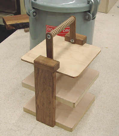

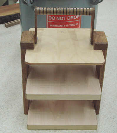

I also made him a rack to hold the molds. It is made with wood grain melamine for the shelves so that leaked resin will not stick. the sides and handle are mesquite! Of course the handle was turned on the lath and has a CA finish!!

Really nice design , I like placement of the gauge , mine stands up and is a pain to read .
That is a great idea with the rack , I use wire racks that nest on each other , it can be a pain to load . Yours looks great .

I made my first pressure pot based on your "worthless wood" article and it turned out great. I do like the way you've rearranged the pipes on this one, it's more streamlined. I don't know about you but the fixtures on the Harbor Frieght paint pot were a royal pain in the arse to get off. The pin release valve that came with the pot leaked, so I removed it and rearranged the fixtures similar to the earlier photo. Thanks for the more detailed pic's of the rack... much better design than what I came up with... think I will be making a new rack this weekend :biggrin:

Total cost to build this pot:
HF Pressure Pot $ 69.27 plus these fittings:
Lowes Item and part #
221029 1/4" mini ball valve $8.62
11303 1/4" industrial air hose fitting $1.60
214782 1/4" x 3/8" adapter $2.13 $
Grand Total $81.62 !!
I did not get the pot on sale but was able to use a 20% coupon. The 1/4" x 3/8" adapter screws into the pot and then the ball valve screws into it. As you can see, there is no need to spend a ton of money on other fittings.
