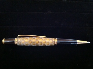

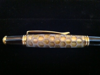

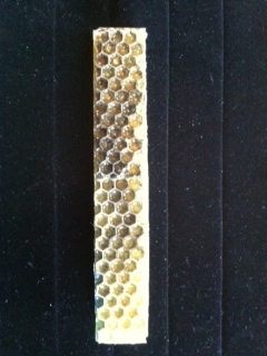

Here is a picture of a pen i turned out of some extra honey comb frames i have from my bee yard. The comb is fully extruded food grade plastic filled with yellow silmair41 PR. When new I coat the frames with real wax which improves the bees 'taking to it". it was a challenge to come up with the process to make it which is similar in effort to turning a coffee bean blank ;)

I really like it. I can't tell from the pix. Does it go all the way around the tube (tube is wrapped) or are the combs only fully visible from two sides? If the later, have you thought about a way to wrap the tube like I've seen done with the cactus innards? Nicely Done either way...

john & jeff regarding the wasps nest do you cut the hive up into blank sized bits and keep stacking them until its thick enough to cast in PR or is it loose in the PR like gold leaf?
mark it is wrapped all the way around the pen (on the sides are thin lines)

john those patterns are replicated by the manufacturer and based on a real comb's cell size in that this is fully extruded plastic comb. God wired a 'nursing' bee to produce exact size cells within very very high tolerances every time, time and time again. in beekeeping cell sizes are a very big topic of discussion. many beekeepers practice 'small cell management' trying to manipulate them down in size in hopes of keeping the risk of mites in control which are a huge problem. if the cell is just a hair smaller then God's original design the mite cant mature to size and dies leaving the brood 'baby bee' alone. they also sell plastic frames (pierco) which only has a slight indent (the shape of a bee cell in the plastic foundation) which the bees will 'build up' with wax. with both plastic type frames you need to coat them with wax so the bees 'take to them' otherwise you run the risk of the bees rejecting the frame sensing that something is wrong. hey dont get me started on discussing beekeeping because i wont stop ;)

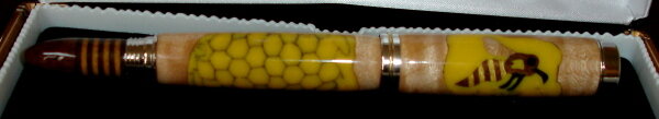

I cut the hive to fit the mold then pour, that's it. Cut it up and you have hives all the way through the pen just like yours. Somewhere I have pics of hive pens but not sure where. I did find this one I did for a PITH a year or two ago, it is a real wasp hive that wasn't thick enough to go all the way through a pen, so I made it a worthless wood hive pen.
