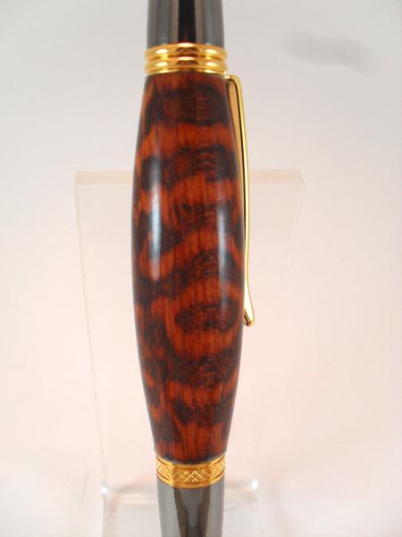

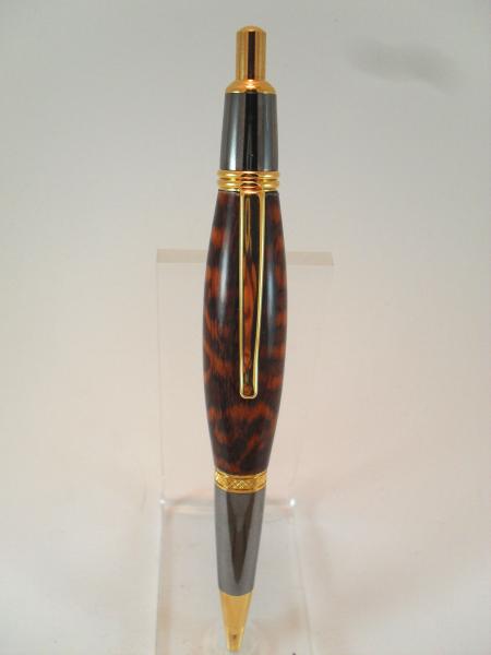

After having tons of problems using my CA finish on this pen (and it still not turning out quite like I had hoped), I have completed my first Snakewood pen. I like the way it looks but found out it is very difficult to turn. I hope it doesn't crack!

I think I was a little too worried about the wood cracking so I was scared to take the wood down any further. I wish I had made it a little thinner.

I am with Manny on this one. What you have done looks good. Great figure in the wood and the finish looks good. The shape looks like it is getting ready to pop though.
