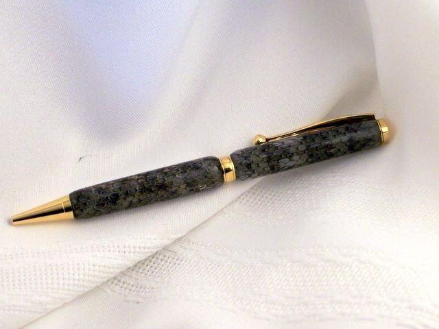

Nice pen, Paul. I really like the snake skin pens. Is it cast in PR or did you build up CA over the skin. I cast my skins in PR and have not tried the CA build up yet. Keep 'em coming.

This was purchased as a precast pen blank. I would love to learn how to cast them myself. What do you use for a form. Do you use the conduit pipe or did you make a wooden cast?

Go to our homepage and scroll dowm to the bottom to the partial list of articles and there is an article by Kenn Osborne entitled "acrylic casting molds". I use a small plastic tub (tupperware type) that is just the right size for our pens. I get three half-blanks per cast. There is an excellent article on casting polyester resin in the files area of the yahoo penturners group. I will see if the author will allow me to post it in our archived articles.

As I've mentioned before, I get my skins from a snake dealer who raises and traps snakes for herpitariums and laboratories. The snakes that die naturally he skins, cures and gives the skins to me. I live in rattlesnake territory of Texas, and neighbors who kill rattlesnakes (I can't control what others do) will call me and I'll go and skin the snakes and cure the skin. One skin from a 2-3 ft. snake will make ten or so whole pens or 20 if I just use the top blank for the skin. The skin is glued to the brass tube and cast in polyester resin. Some glue the skin to a thinly turned piece of wood on the tube and apply multiple layers of CA to build up the pen. I prefer casting in PR.
