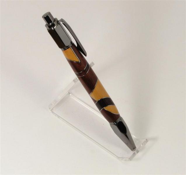

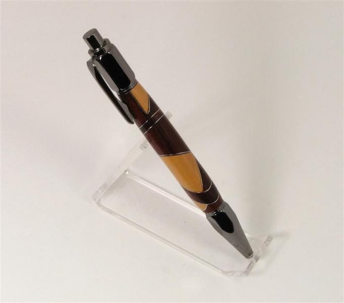

Chrissy's latest creation. Random segmenting with Peruvian walnut, ivory, purple heart and aluminum flashing.
Gunmetal Vertex Click
She's getting really good at segmenting. Now if I could get her to wear gloves more often so she doesn't constantly glue her fingers together or to the blanks :eek::biggrin:

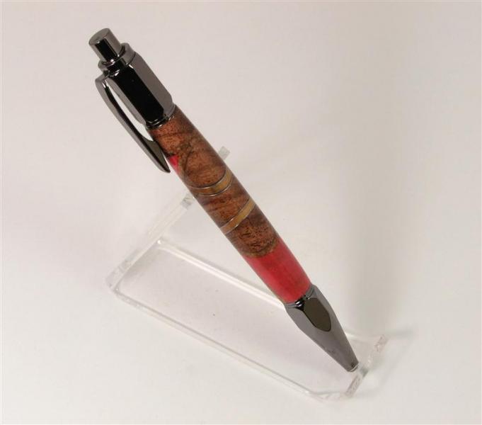

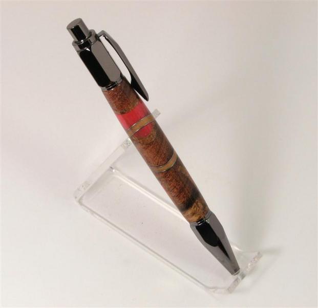

Here is another that she was working on in parallel to the first one. I came home tonight and found that she had finished the glue up, squared it, turned it, and was starting the finish process.
She did the CA finish this time. I only answered questions. I'm slowly loosing controlling stake in my own shop :eek:
