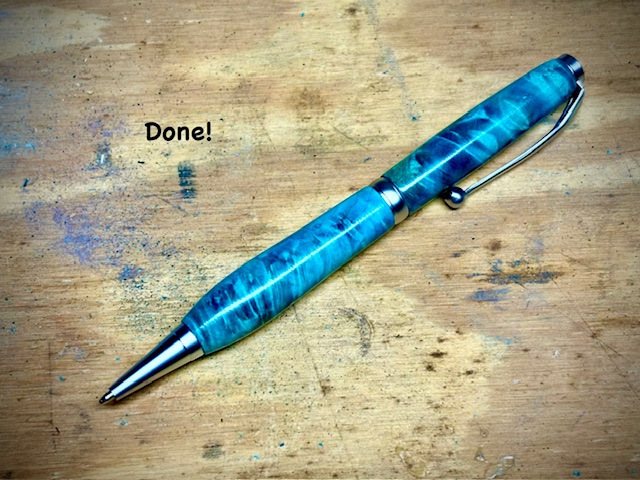

First stabilized wood project is in the books - turquoise box elder Comfort pen. No issues at all, just cranked up the lathe speed to 3200 RPM, took my time, and made a LOT of blue dust and chips. This stuff actually turned a lot easier than I expected, other than taking a bit longer being extra careful to not damage the material. I used the monster 1/2" cryo M2 spindle gouge to rough it round and down to the basic shape, then went back to my mini 1/2" HSS skew chisel that came with the startup set to finish. Sanded with paper from 150 to 600 grit, then dry sanding sponges down to 3000 grit, a quick steel wool, then a damp wipe down with mineral spirits. Finished with EEE, Shellawax, and a final hit with Waxtik. It's not quite the glossy sheen I was hoping for, but my wife loves it, so if she's happy, I'm happy. Bottom line, I do like working with stabilized wood; I plan on getting a bunch more blanks, and I'll keep working on getting the glossier finish I'm looking for.
Just an aside - I bought a full-size 3/4" cryo HSS skew to go with the full size spindle gouge (which I like a lot), but I don't like the big skew nearly as much. I just cannot get the control and smooth finishing detail with it that I can with the smaller cheap HSS skew, either on regular hardwood or this stabilized wood. Three pens now I've reverted to the smaller skew to do the final turning. Maybe it's something that will come with time, or maybe it's just not a good tool for smaller work. I'd really like a mini size cryo HSS skew chisel, but I haven't been able to find one anywhere. It's either plain HSS (which I already have) or carbide tipped, which I don't really want to get into right now. I'll stick with what's getting me good results for now.
Anyway, enough rambling … here's stabilized wood pen #1.

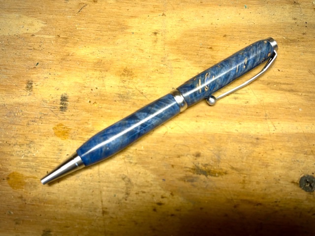

Stabilized wood pen #2 - Blue maple burl Comfort pen. I'm liking this stuff.
