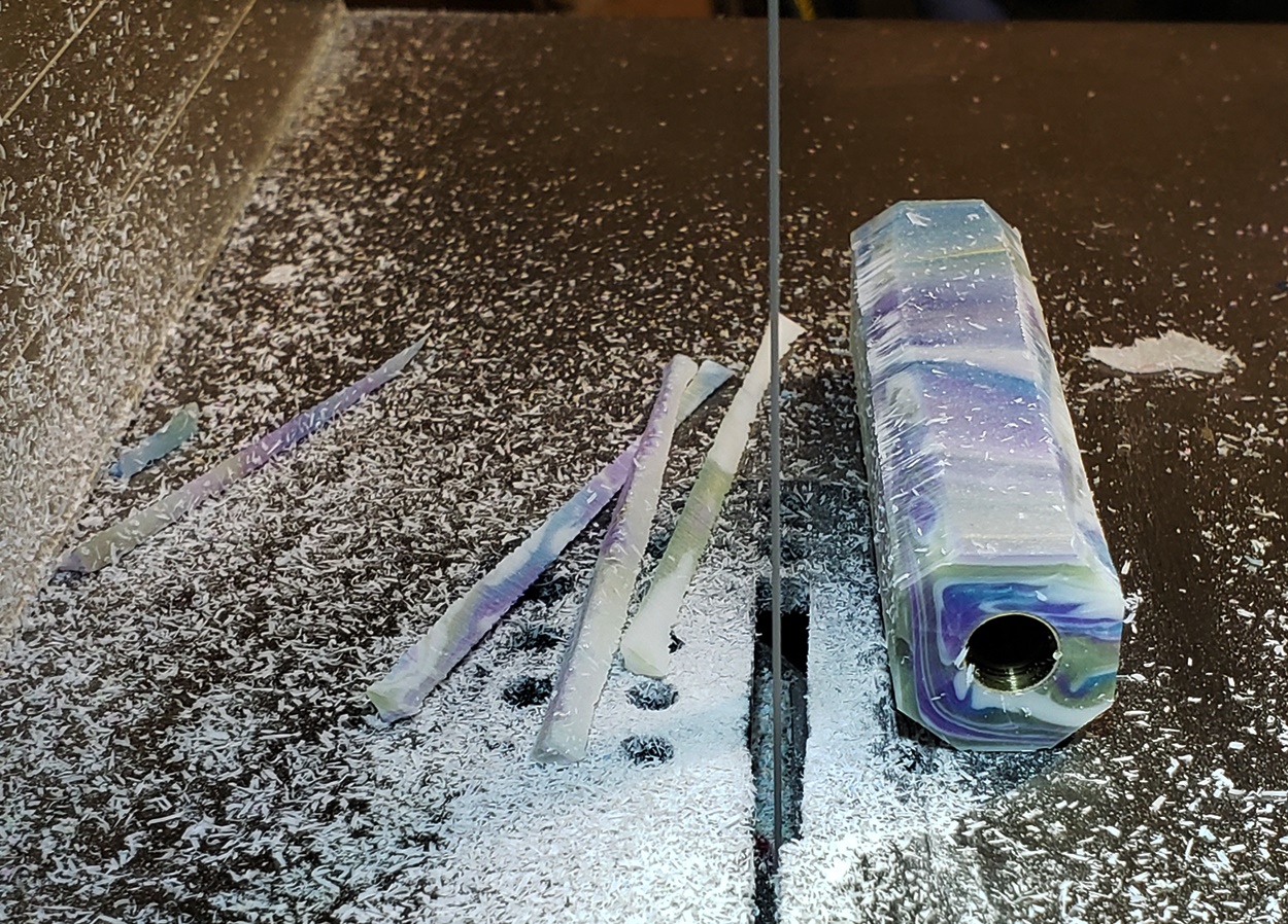

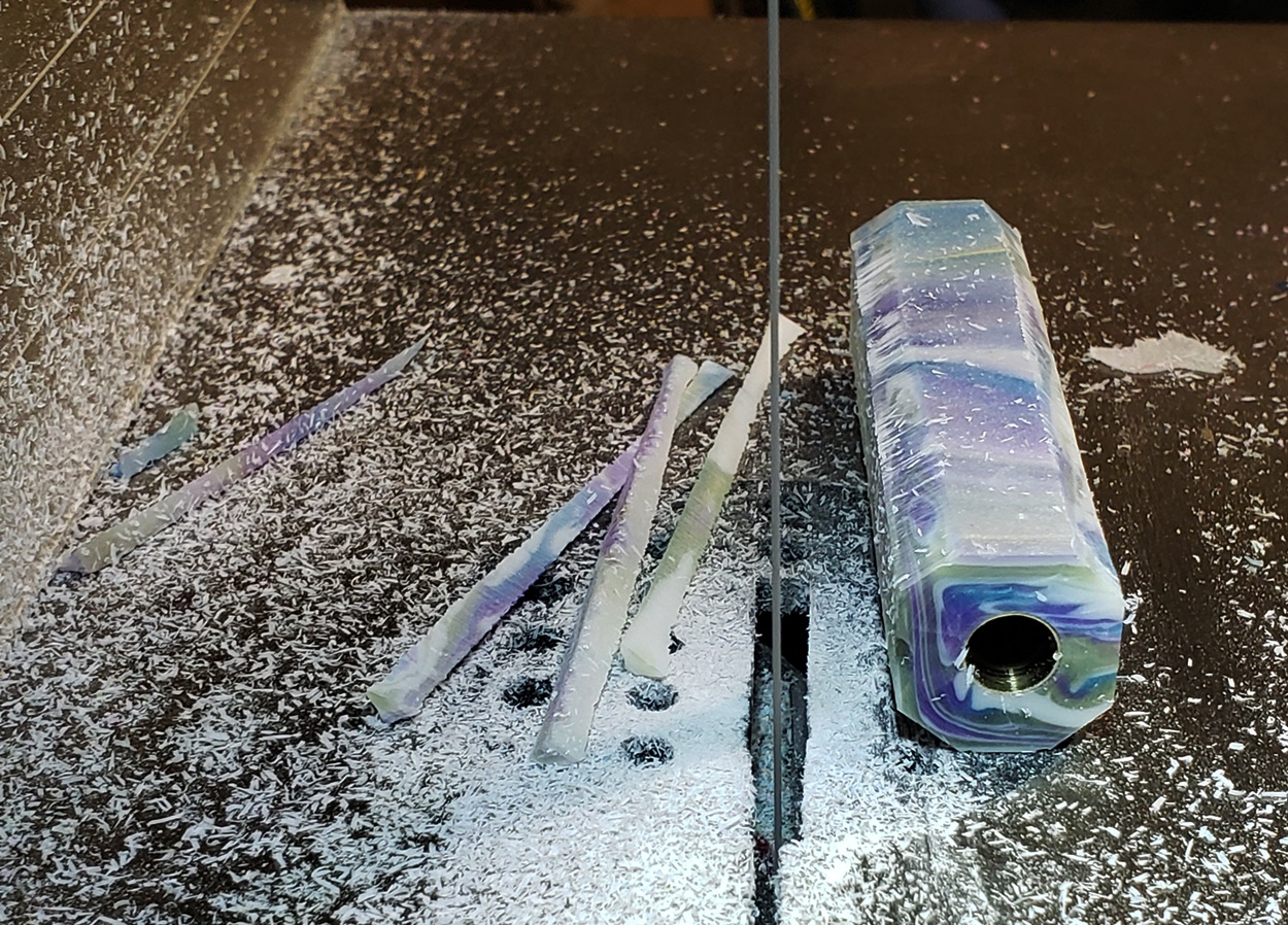

Something else that can help is to trim off the sharp corners of your blanks, so that you end up with octagonal shaped blanks. This will take care of some of the turning work, which for a hard material like inlace can also be a huge timesaver. It also means you don't have those perpendicular contact of hard square edge to hard tool edge.

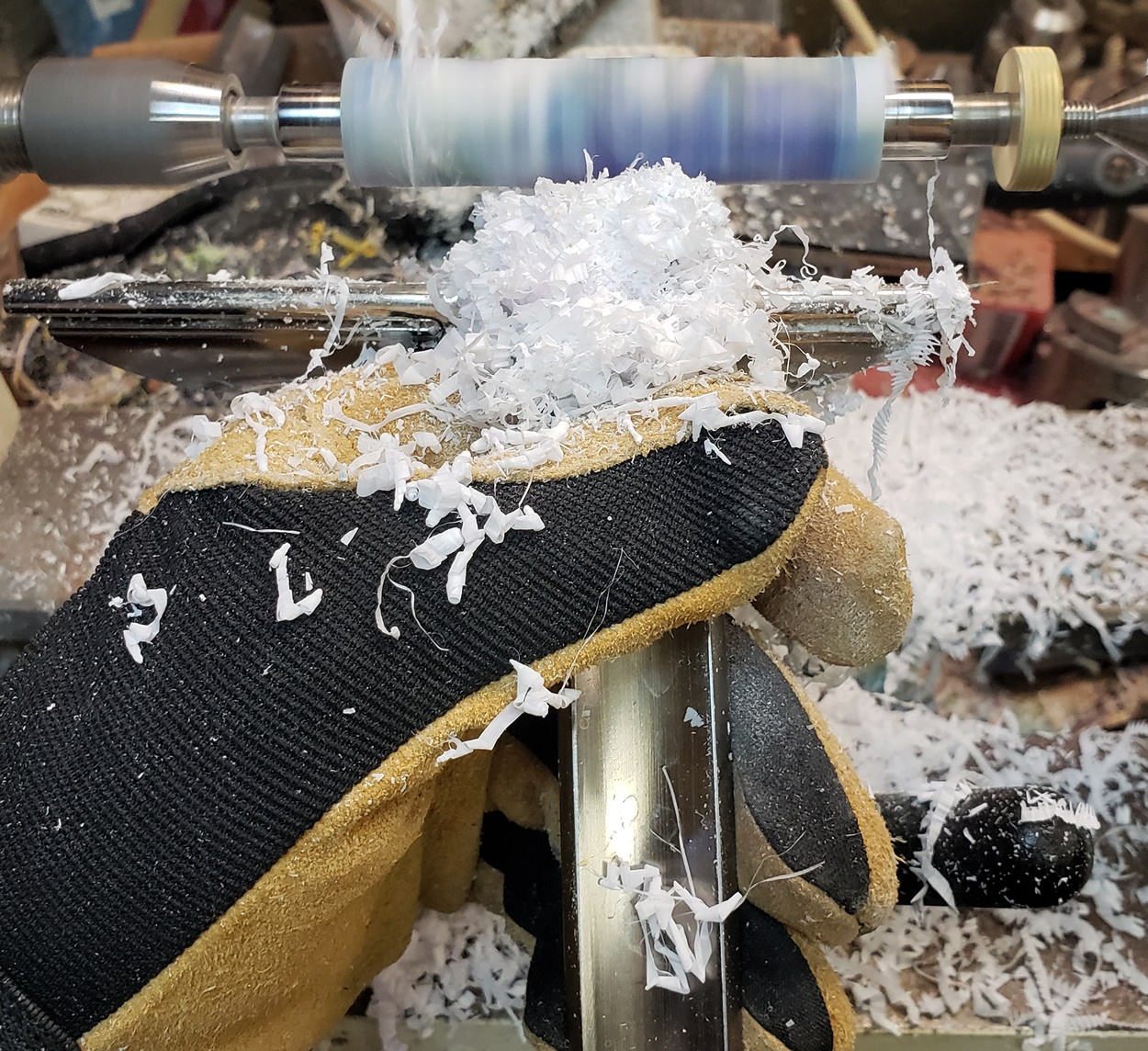

While I can't say that I've seen resin actually pull a tool into itself, I have found that it does NOT take much aggression to start causing problems...either chipout, more the case with harder materials but enough aggression and you can chip out ANY resin in my experience, or what I call rippling, where you get rippled and coiled waves in the resin. IME this is the result of the heat of friction starting to melt the resin, but only so long as the tool is actually in contact, so as the tool moves along the blank you end up with a corkscrew divot or ridge...and worse, sometimes the tool itself will ripple while in contact with the blank, resulting in lots of fast horizontal ridges along the length of the corkscrew. Fixing this is easy enough when you still have material to remove, but if you do this close to your desired blank diameter, then you may well find that the effect is permanent (once the hot tip of the tool moves away from an area of the blank, it will quickly cool and solidify again.)
The solution to all of this, is to learn how quickly you can turn any given kind of material. Real acrylic turns pretty quick, as does alumilite. I turned some kind of resin (not sure what, exactly...just a solid black resin of some kind) last night, one which I'd segmented with some kirinite and alimunum metal layers. Took me near an hour to turn the upper segment (Cigar) which had the segmenting, and took me about a half hour to turn the solid lower segment. Hard material, it did not produce the nice streams of resin like I get with acrylic. I first started with my negative rake EWT tools, and eventually switched to a skew. Used the skew for most of my material removal, then switched back to very light negative rake cuts with the EWT tools for final shaping and turning just barely proud of the bushings. Took a good long while, and the right tool for each nuanced aspect of the job, but in the end I'm happy with out they turned out. A pure acrylic blank? Would have probably taken me 10-15 minutes to turn, as it just turns so much easier.
FWIW, I only actually finished the blanks earlier today. Took a while to sand them to the finish I expect. Even after sanding down to 1 micron (with white zona paper, wet), I could still see scratches in the right light. I then set the lathe to a slow spin, and used radial sanding to try and neutralize the visibility of those remnant (now just 1 micron!!) scratches. That was better, but in the right kind of lighting it still looked scratched. Did a few passes of polish with this micro fine polishing set of 3 progressively finer polishes. For some reason, that hardly seemed to do anything...maybe it just wasn't formulated for whatever resin this was? So I finally did some buffing...which in a sense is both aggressive but not all at the same time, first with Tripoli, then white diamond. Still didn't like the look after the WD, so finally put on my blue rogue wheel, and did a final third pass of buffing to really work out all the final scratches. The blanks ended up looking superb at that point (although, sadly, the buffing seemed to ruin the super shiny sheen I'd originally had on the aluminum accent bands in the segmented blank). Took several hours, lots of scrutiny, and a whole slough of different tools and techniques. But in the end, the blanks have no visible scratches, reflect light superbly well, and feel great between my fingers. I finally assembled the pen a little over an hour ago.
Let the material tell you how long its going to take, don't be aggressive, enjoy the craftmanship, and as you approach your finished diameter and shape, take lighter and lighter cuts to get the most optimal result. Take your time...its worth it.

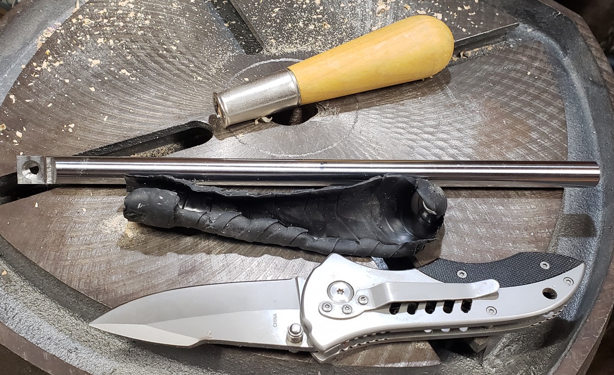

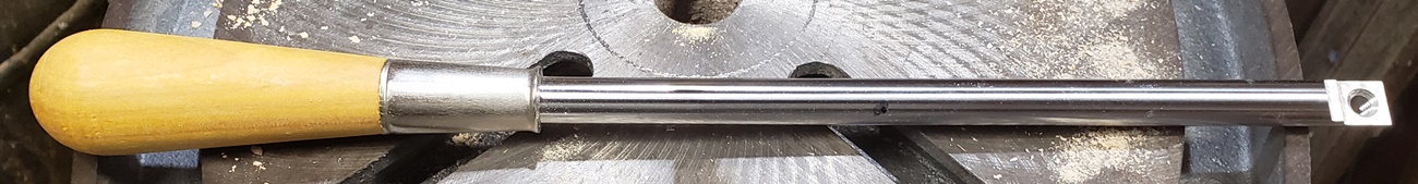

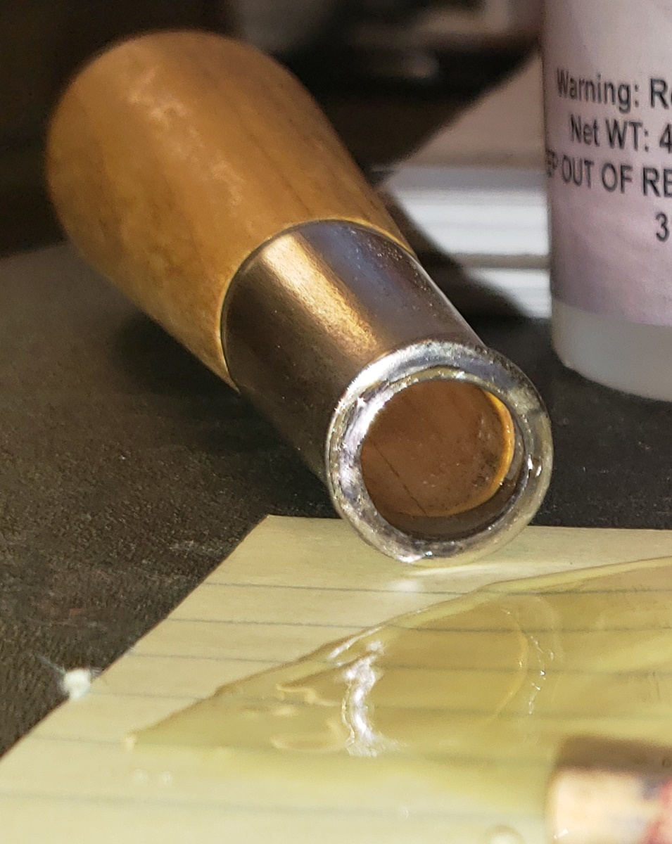

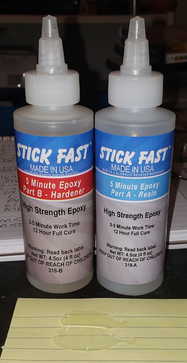

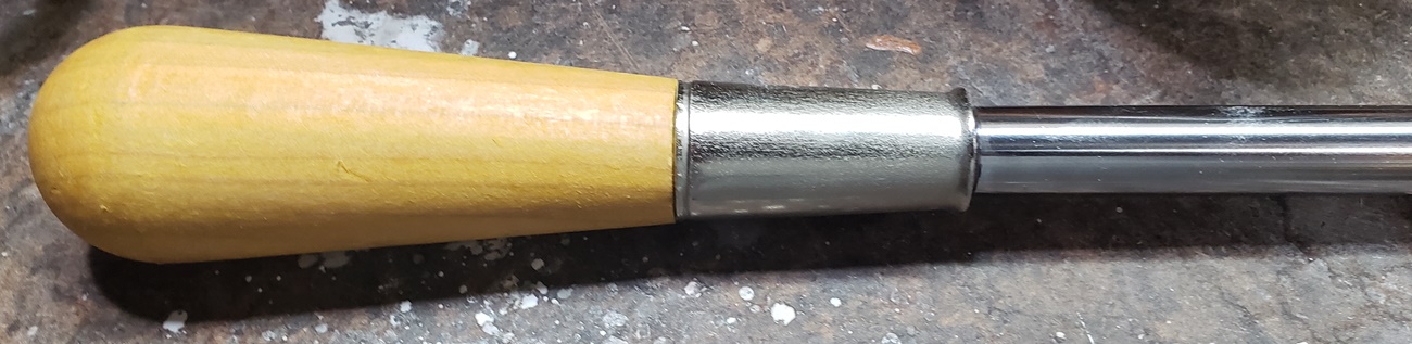

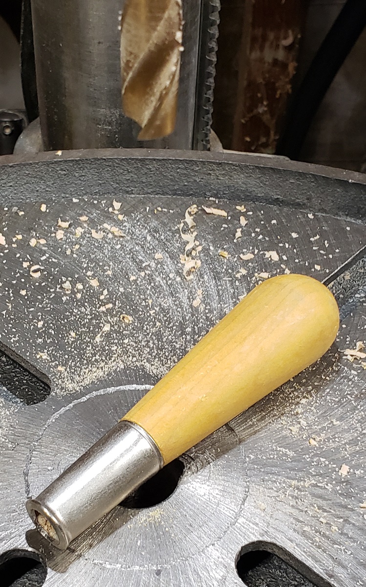

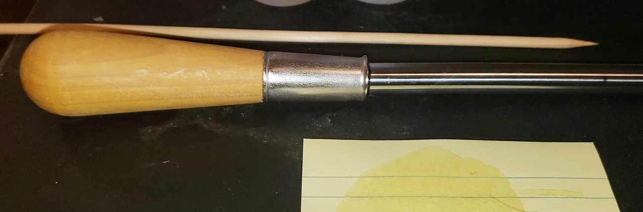

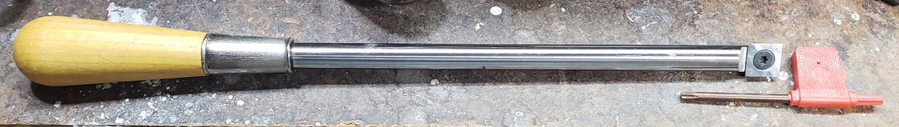

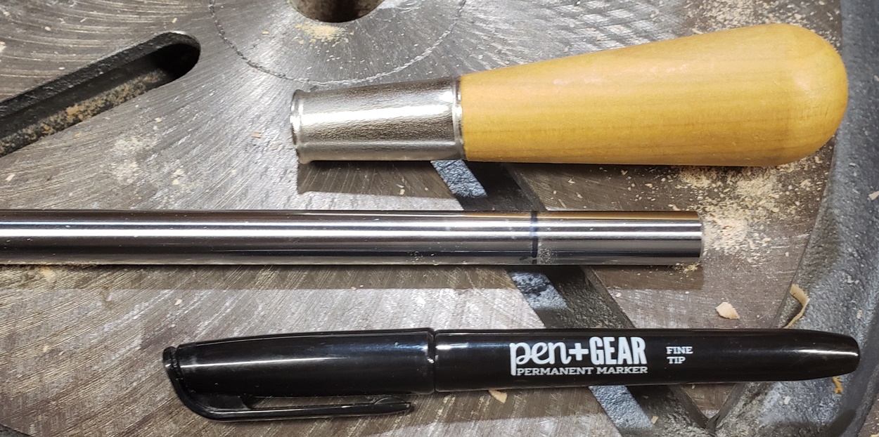

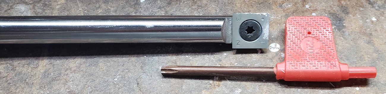

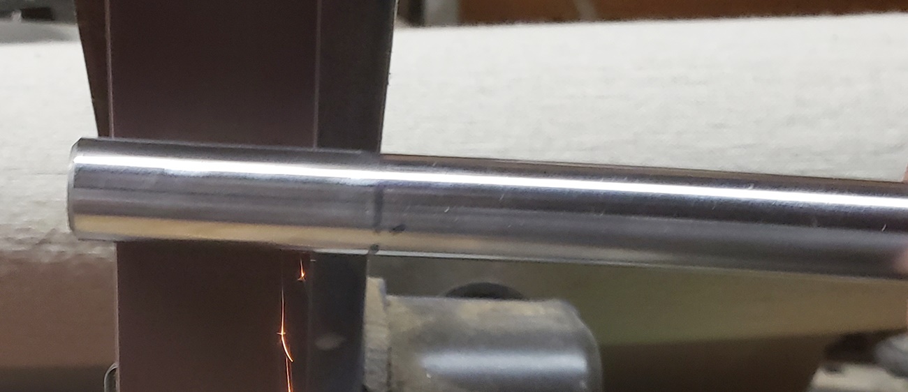

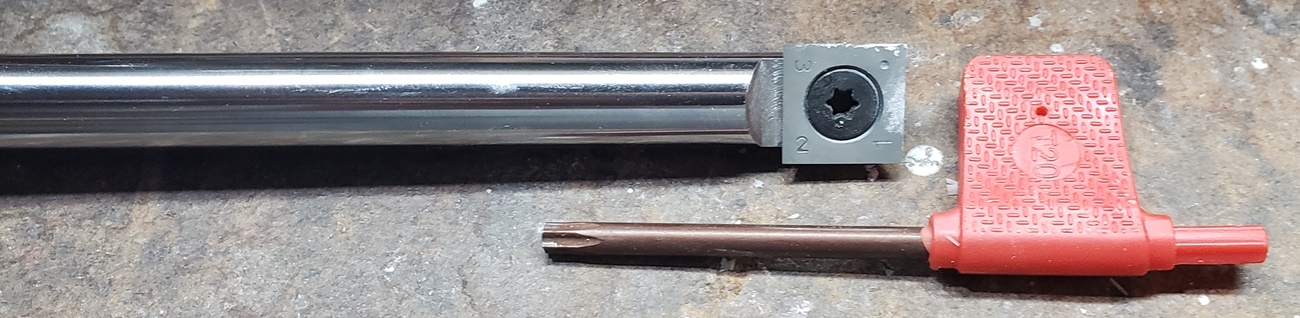

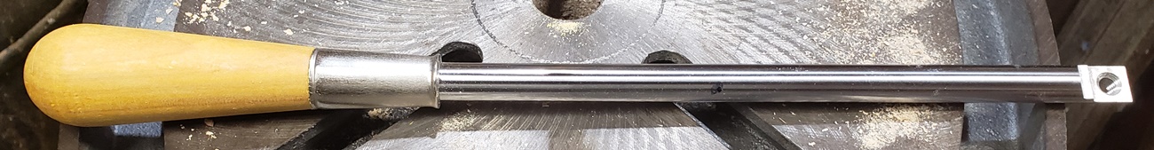

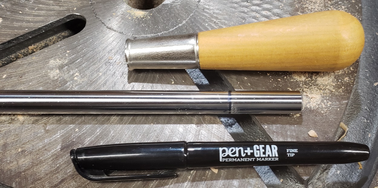

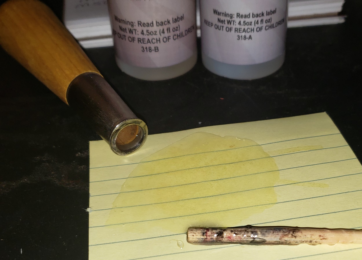

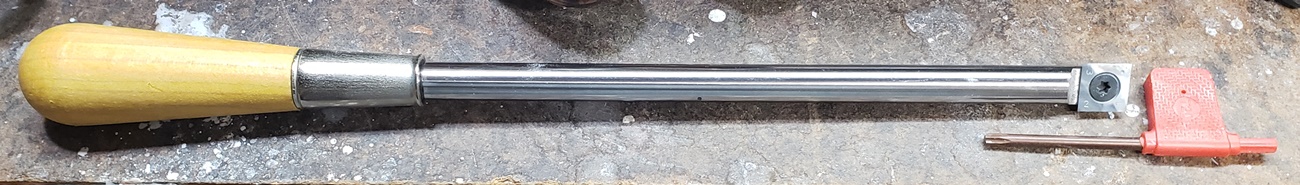

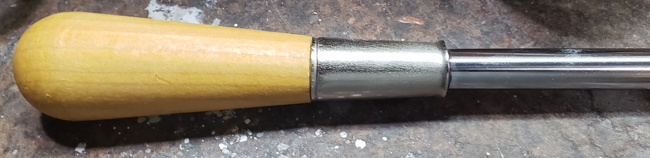

Everyone is giving good advice so my tidbit for you is somewhat against the grain abit. This is to address the end chip out. The proper way to turn a blank is from ends toward center. Most people do not do this and get away with it. But if you are having problems start there and present the tool from the end to the center and do this on both ends. The reason behind this goes back to woodworking thoughts. If you plane a board from center to end there is no support for the tool or blade when it comes off the end. But if you plane from end to center then there is wood or acrylic material to support the cutting edge. Think about it because it makes sense. Now when you get the blank turned down to near completion than make your strokes straight across from end to end because the cut will be very fine and you will not be taking alot of material off. Good luck.
When I have enough surplus blank length compared to the tube length, I frequently cut the blanks as long as possible and then drill to the depth of the tube without drilling all the way through the back end of the blank. This is where the majority of the blowouts occur. Then I cut the blanks to length by trimming off the end thereby exposing the drilled hole. Heat, pressure from packed flutes, unsupported back side, and drill bit grabbing when punching through an exit hole are the primary causes for blowouts on the ends of blanks. - Dave

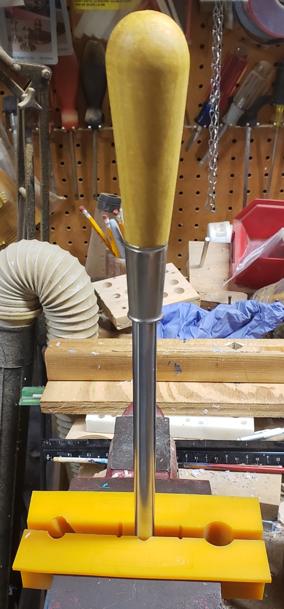

I used to HATE inlace acrylester. It always exploded on me, usually towards the end. So I avoided it like the plague. But a few years ago I discovered carbide tools held at an angle so I get a "shearing" cut. Since then, I have turned several inlace and other brittle blanks with no problems. I actually use a semi-homemade carbide chisel. I bought a carbide holder from Amazon and put a file handle from Ace Hardware on it. Works great. I know some here prefer 16mm round cutters, but I usually use 15mm square cutters with a 2" or 4" radius. I get the cutters from Amazon, too. Another thing I do that helps is to cut the corners off the blank before I start turning it. Seems to help with the initial "roughing".

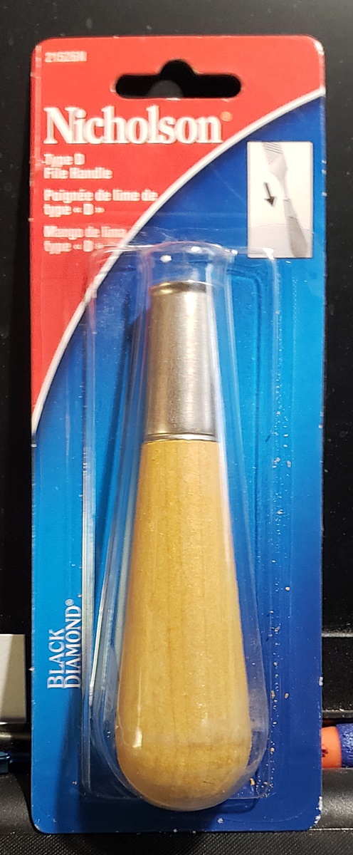

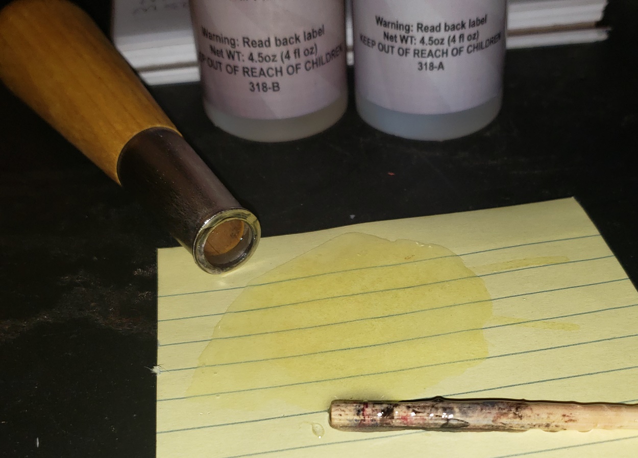

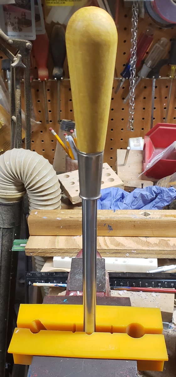

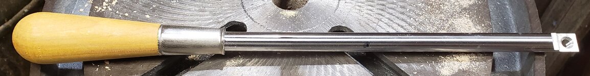

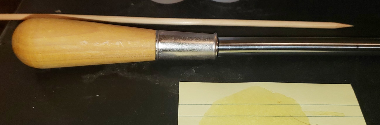

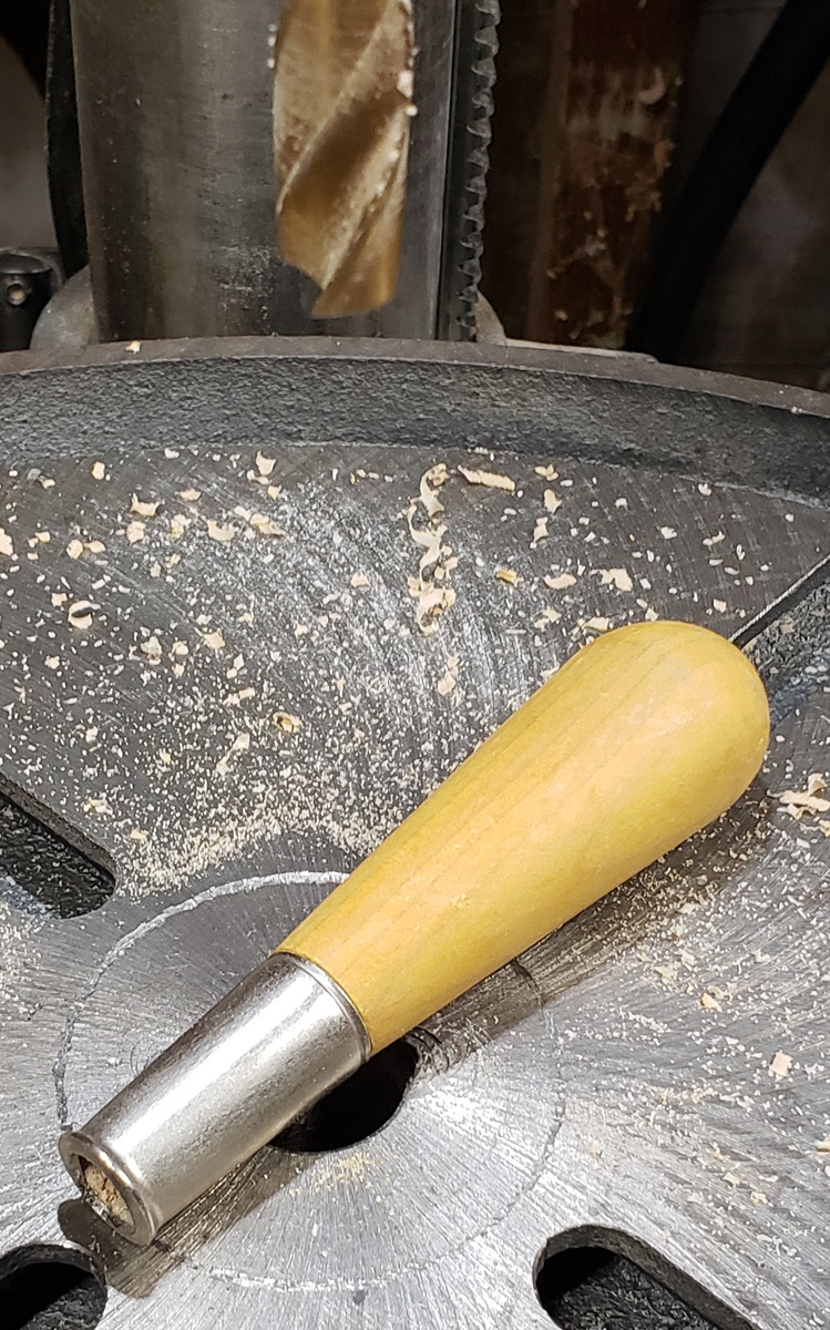

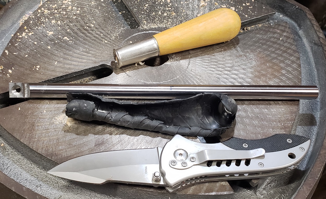

If you don't like the idea of the file handle, you can always buy EWT or similar handles.

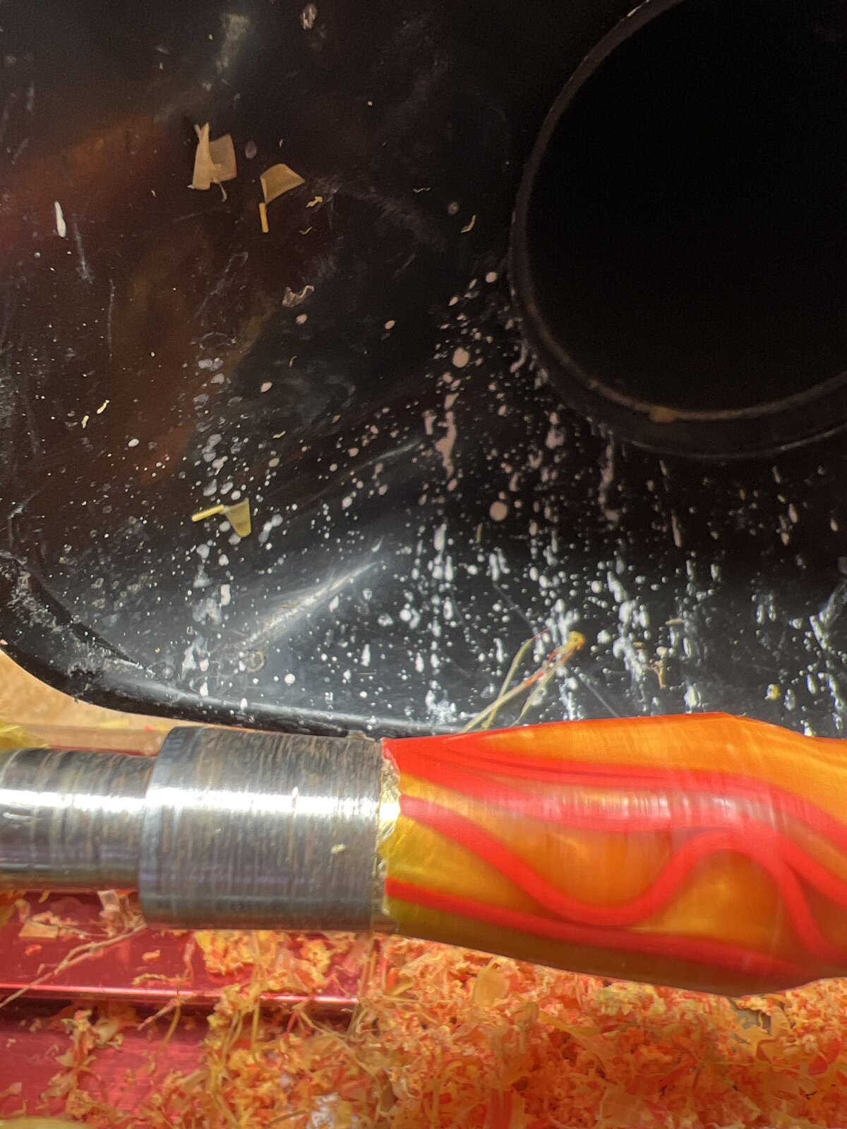

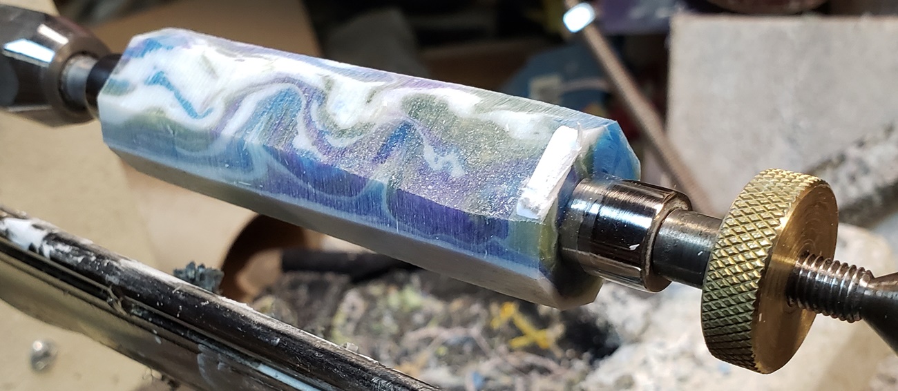

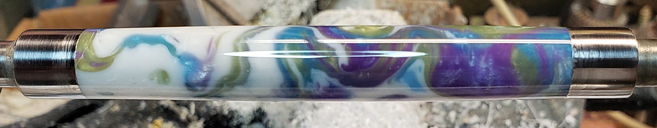

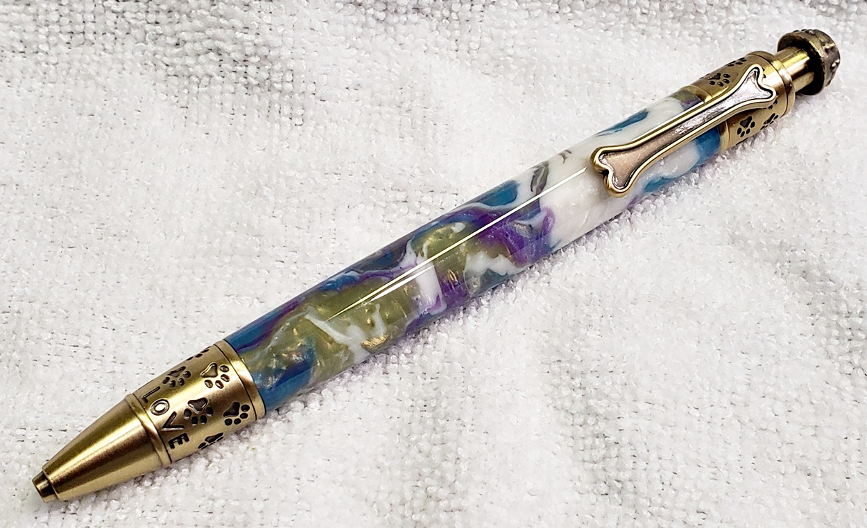

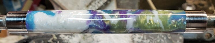

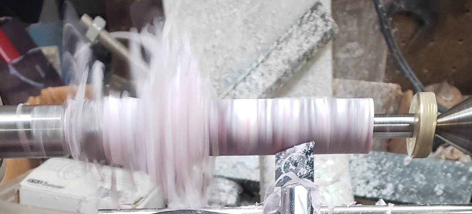

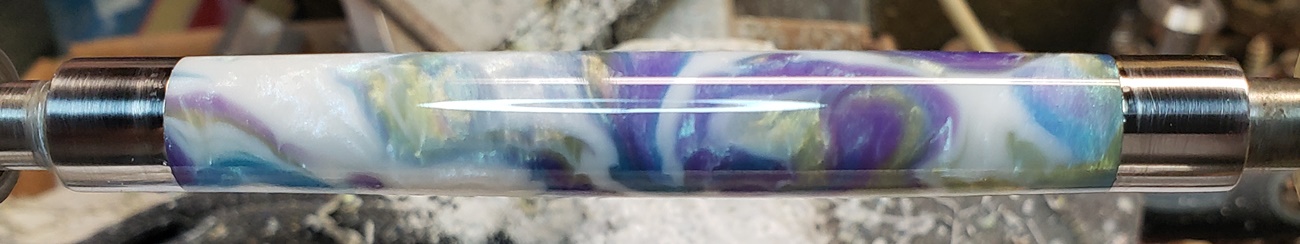

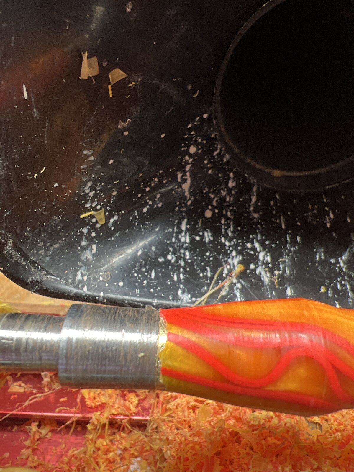

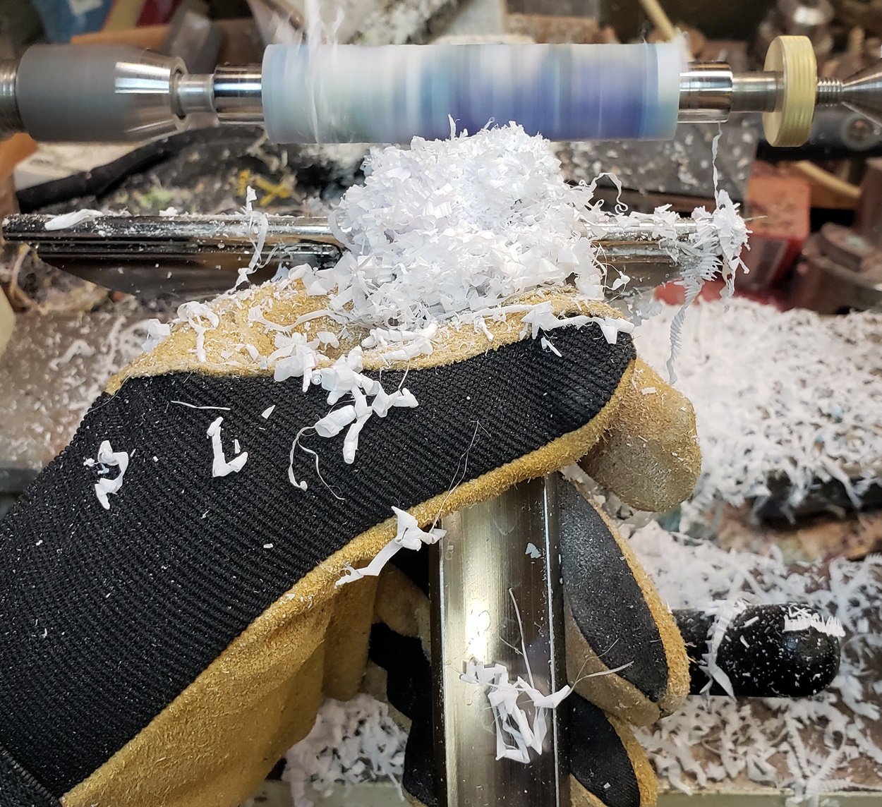

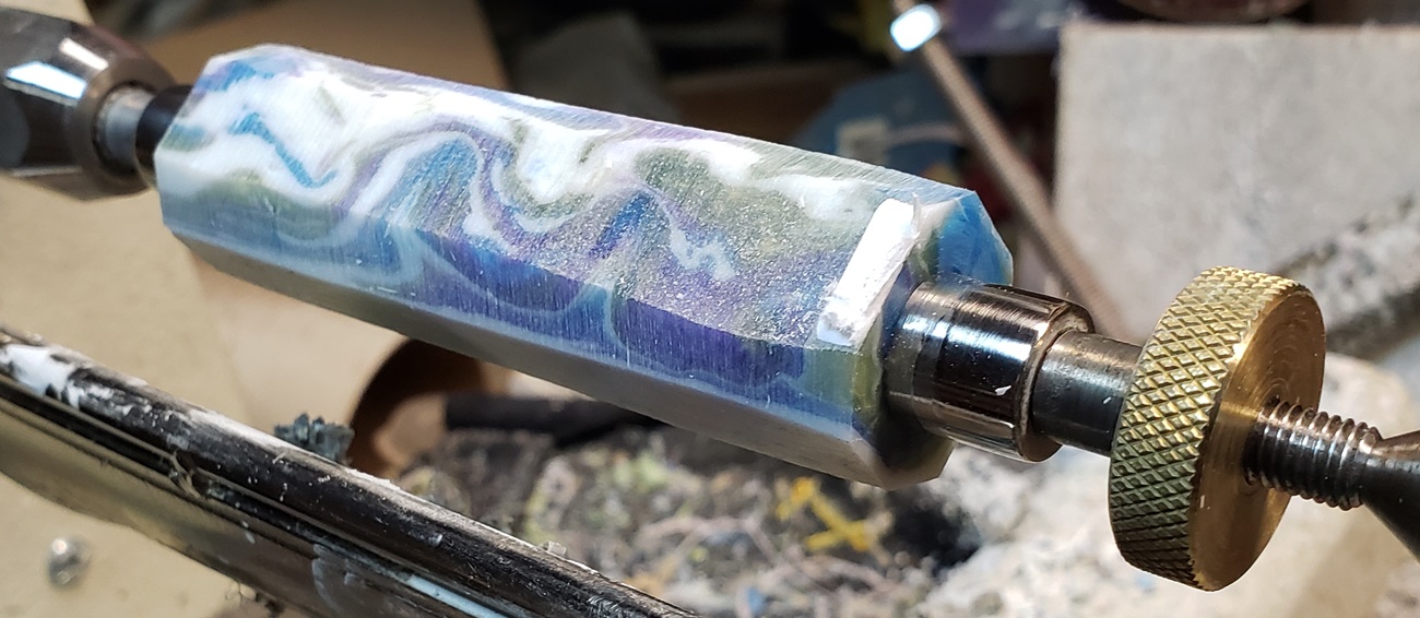

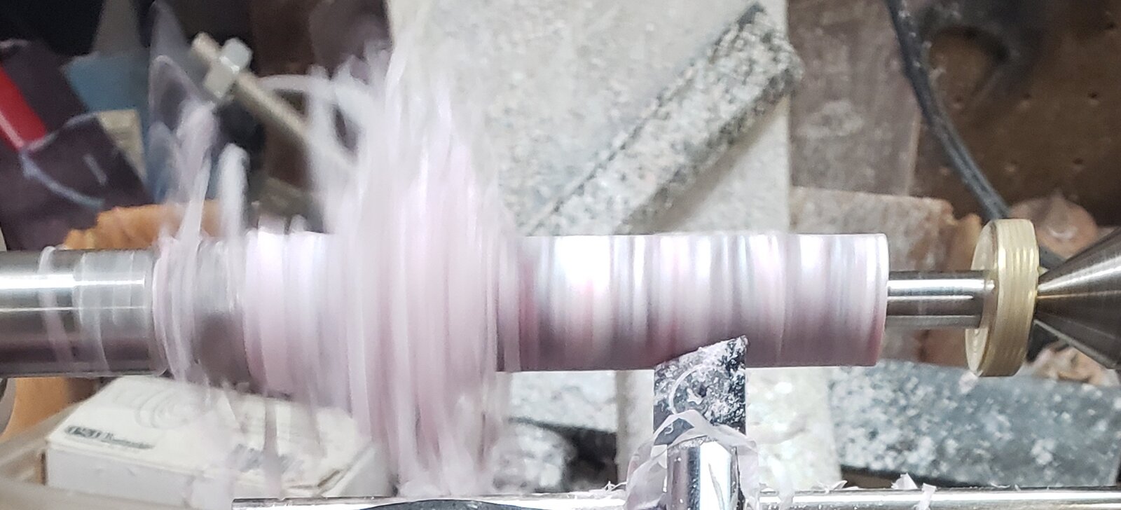

So this morning I decided to give things a try by turning it.(I drilled and glued the blank yesterday) I thought I was doing so good then this happened, maybe I am being impatient, it's a Kirinite blank (prepared it before I started message) other blanks I have are lava bright. I also have some inlace acrylester (which I know stay away from till I get better)
Your picture reminded me of some other discussions, related to all blanks and not just plastic. Be very sure to have glue between the blank and the tube, especially at the ends. Sometimes this kind of tear-out is related to bits of the blank not being securely glued to the tube.
Mark Dreyer (mg_dreyer) has an excellent YouTube that explains it much better than I can. Here is a link to it: 10 Minutes To Better Pen Making - Gluing - Mark Dreyer.
Another very good video related to glue related blowouts on plastic blanks like what you had happen was made by Zac Higgins. The the link to his video is How I Glue Tubes in Acrylic and Mixed Material Pen Blanks.

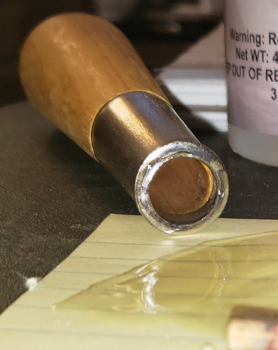

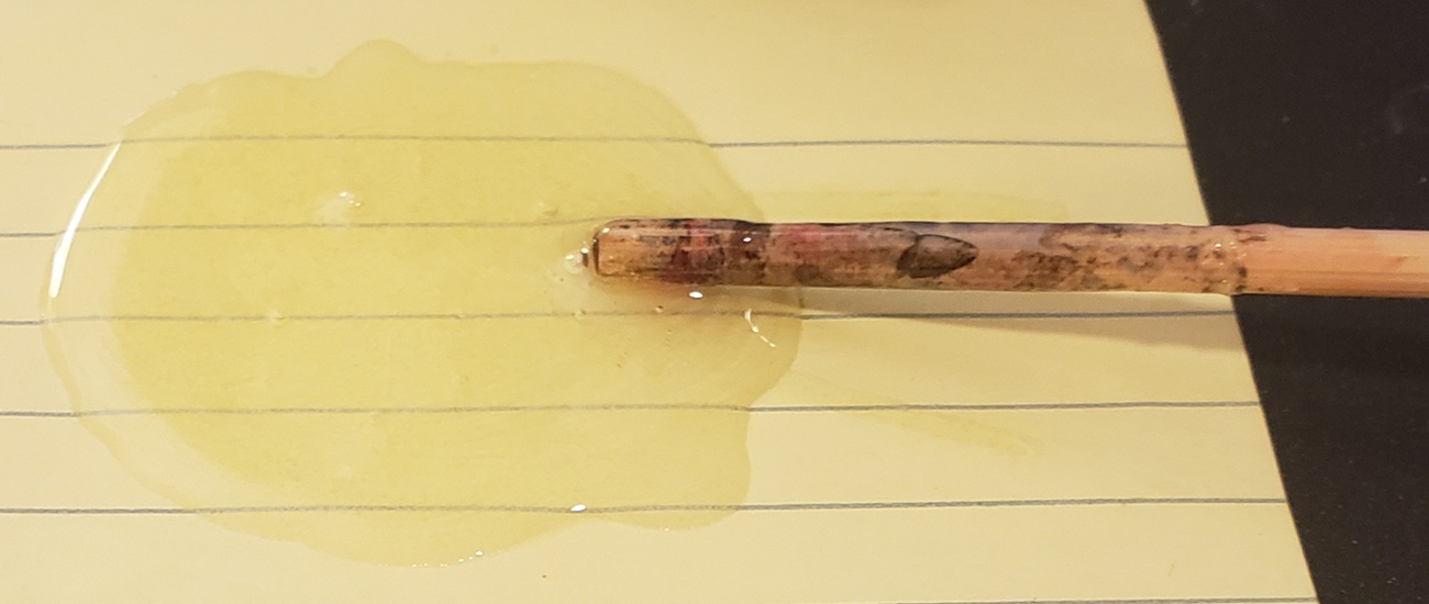

Are you sure that you are eating sufficient glue/epoxy down at the ends of you tubes? I've had the same issues and when I took a closer look it seems the tubes were not 1. sufficiently roughed up near the ends and, 2. looked to be a but light on the CA (thick). Was always the end of the tube that was the last part inserted into the blank (where is was on the insertion tool). So now I rough the tube up of a disk sander (not by hand) and when inserting the tubes I twist the much more that I used too, and when inserting I push the tube out the far end of the blank and add a little more CA to that end and then twist/push it back in. Wastes a bit of glue but that's cheaper than blowing out all the blanks. Good luck
When I was young, my Uncle was the School Superintendent in Winthrop Harbor, only for three or four years then he moved to Zion. As I recall thru my 10 year old eyes and brain, it was a very nice town. I always enjoyed the trips to IL.
I think the advice from everyone is spot on, but the end chipping I think could be related to your drilling. If one end of the blank is egg shaped, there is not good support under neath to the material you are taking away. It needs the support of the brass tube, which is not there and it breaks. THis should be easy to see by studying the end with a lupe or magnifier after milling/squaring the end.
The other great piece of advice came from John T. Round the corners first, then work to the middle. I literally round them very close to finish size and then begin to take away material in the middle. Also I hate to say it, but if it is going to break, at least you do not end up with a lot of time in a useless project.
If you can get a negative rake for your carbide magic THAT IS KEY! There IS a ton of difference in how much easier it will turn. I made my own carbide with square stock and a file....I also use a skew, occasionally, held in the same position, sideways, it is actually ground similar to negative rake, but takes some practice...that point will get you. And if used in the correct position is a great tool....practice on a 2x2 pine block before you try blanks. I use a skew a lot for other things and like them, but a negative rake is no-brainer, and is easy to pick up and use.
Lastly....if I take a lot of time off of turning pens I almost always will break a blank right off ( I turn in batches of 15 to 20). You have to be gentle, take your time, and take light cuts.....unfortunately, for me, it is not like riding a bike.....I break one.
Or better yet, make your own exactly the shape and size you want it. ;)
