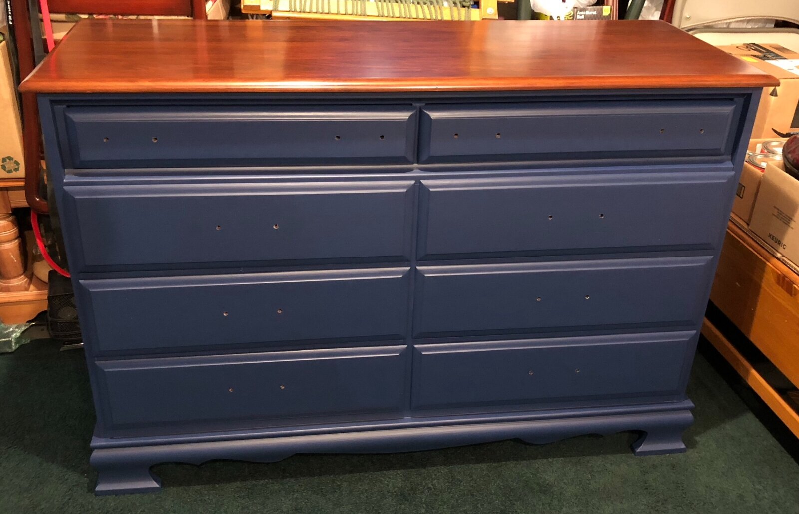

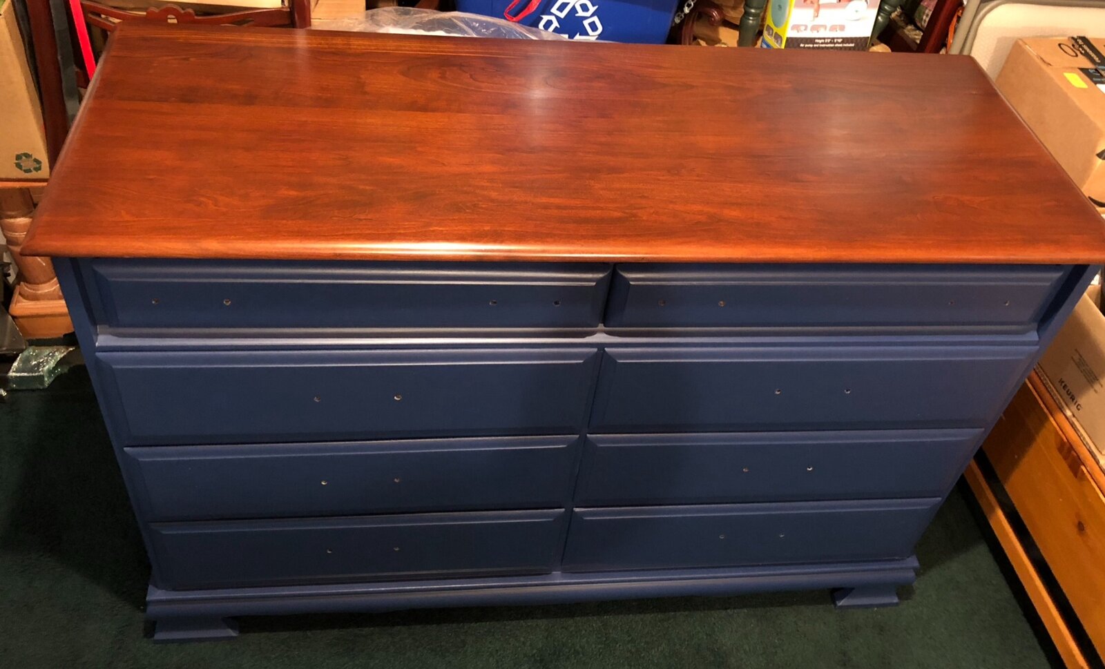

A couple of years ago, our daughter picked up a dresser from Craig's List. It was solid but the finish had talked abuse and wear over the years. This was a cherry dresser. We sanded the body and drawer fronts and used General Finish's Milk Paints. First was a sealer/primer folded by tow or three coats of the milk paint. After plenty of drying/curing time, I added several coats of their latex satin finish to protect the paint. The paint was a deep blue.
On the top which was solid cherry, I scraped and sanded the old finish then still using General Finish products, I stained the top with two coats to desired color then proceeded with sealer and finish coats.
The General Finish products were at our Woodcraft Store.
I did sand just before beginning the finishing process to avoid the oils from handling the pieces and also to minimize any grain raising from ambient humidity.
I will look for a pic.

Here are the pics. Just needed drawer pulls.

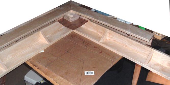

These would not look good with plywood. They look good enough for staining but it is up to her and since they will go in a bathroom, paint may be a better choice. They are 2-piece corner units and are 4" x 4" x 32" long. The 2 at the top of the image are positioned like they would be mounted at about eye level or higher. The other set is laying down so you can see the construction.

What do you put on 4" shelves that is not going to fall off 100 times?? Something that small solid wood is the way to go. We had no idea that is what you were talking about. Plywood is not a good choice.
If determined to paint I highly suggest spray painting and not brushing. Too many small crevices and you will see brush strokes. I would paint before installing and also plan for screw holes and use buttons to cover holes and paint those as well. Would not use nails. Again my thoughts only. To even add to this I believe this is a build on site project because every wall is not perfect 90 degrees and I would have did something decorative in the corner like either a larger angled block or even a square black and marry the 2 smaller shelves in leaving the corner stand proud. Sorry but when I see projects I start thinking what I would have done if confronted with that situation. Just who I am. :)
