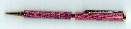

I am new to pen turning... I sand 150 grit-600 grit, EEE, then Shellawax.
Finished pens look pretty good but after a couple of days they begin to look bleached out. I did a maghony pen, nice dark finish and a couple of days later it really lightened up.. WHY
