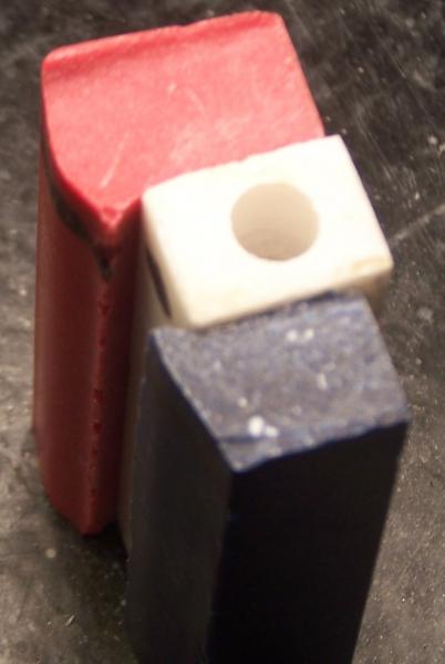

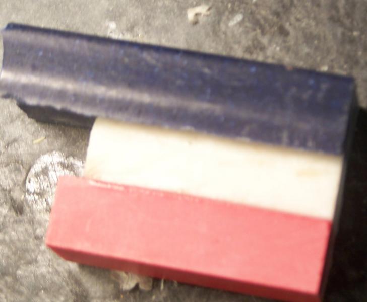

Do the pieces need to be symmetrical? I assume these won't work in their present state. The first two pictures all 3 pieces are the same lenght. I the 3rd I could probally trim the blue one down to the size of the red and white.

Is that hole the final one for the tube? If so, then I can't think of a kit that has so much meat that it will include much ( or even any ) of the red or blue.
If the hole is perfectly centred in the white piece and the sides are perfectly parallel, then you might get a thin red and blue stripe.
Nothing to lose now, so just turn it and learn from it. That's what I do:biggrin:

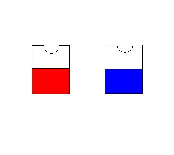

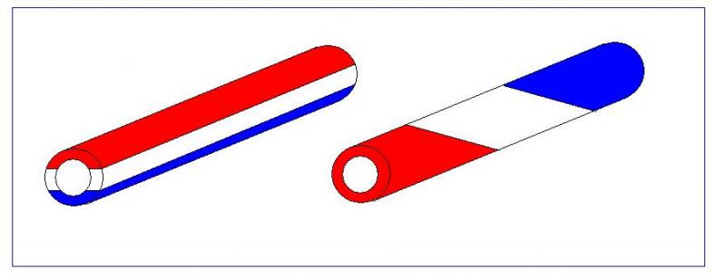

Ok, so even if you re-drill a bigger hole then the best you could expect is something like the pic below. The circle can't be bigger than the white.

PS how did you put that circle on there?

I'd be inclined to do the segmenting on the length. I'd cut the colours at an angle to give it some interest. On a slimline, the white would be split over both halves.

PS; I copied your pic into Paint to add the circle

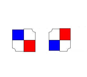

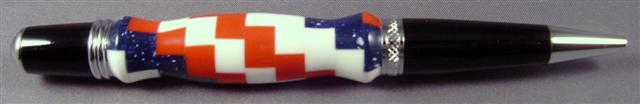

Or you could cut each of the corian pieces as shown buy the blue lines and glue the narrower pieces bake to back on the long edge (see next graphic). Then cut them in half again as shown in the next graphic. Then flip one of each and glue it together as shown in the next graphic. That will give you a blank made up of four long thin segments. You can turn it like that, or do something different. Like cut it into smaller pieces and stagger the layout as you glue them back together. That would give you make something like the Sierra shown last.
Yes, I know, kids, I actually shared something. :eek: I spent some time turning today and couldn't help myself.
Thanks Billy. Really like the Sierra. I guess to avoid this problem in the future I will have to segment like in the last picture.
