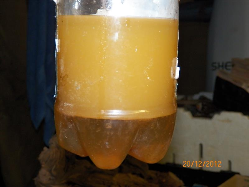

I suggest that you do a test that, will show you very easily if your oil has any water or not. After you used the pump, let the oil cool down a bit and then grab a clean/dry plastica empty water bottle/glass jar and pour the oil contents into it, the pump has a bleeding screw below the oil level clear plastic window so, remove that screw and empty the oil into it.
While sometimes is immediately visible that is water in that oil, you should put the bottle aside overnight, with a lid or without, the next day, you will clearly see if the oil has water or not as the water will be at the bottom of the bottle, like this 016 (2).JPG
I have found that, if I drain the water before I use the pump, and top up with new oil to bring the oil level to the middle of the low and high (try not to overfill), I get the best possible use of the oil and reduce any damage to the pump from too much water mixed in the oil that results in poor vacuum.
