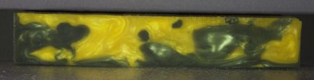

If you want well defined separation then mix and pour one color and let it start to gel. With Alumilite you let it go until you see the very first HINT of it starting to thicken. Then QUICKLY mix the other color and pour it in while "swirling" the first color. The first will kick over as you mix it and will form lumps and bumps. The fresh will flow around it. You end up with something like this:
attachment.php
