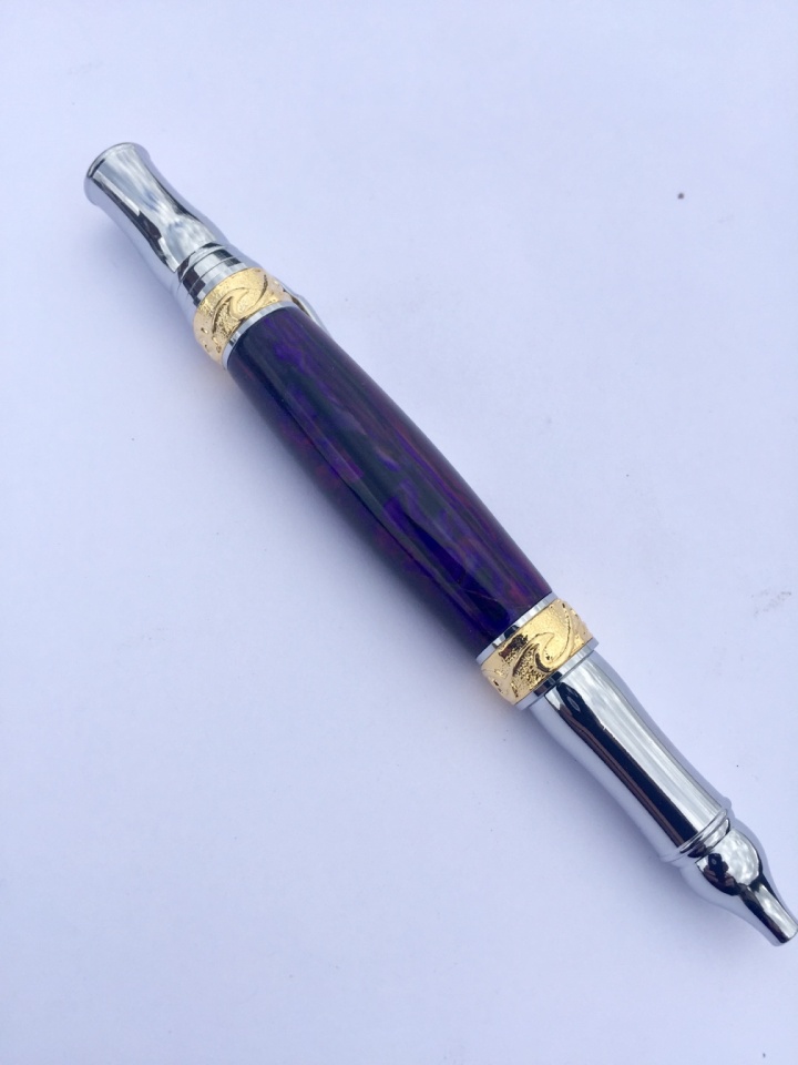

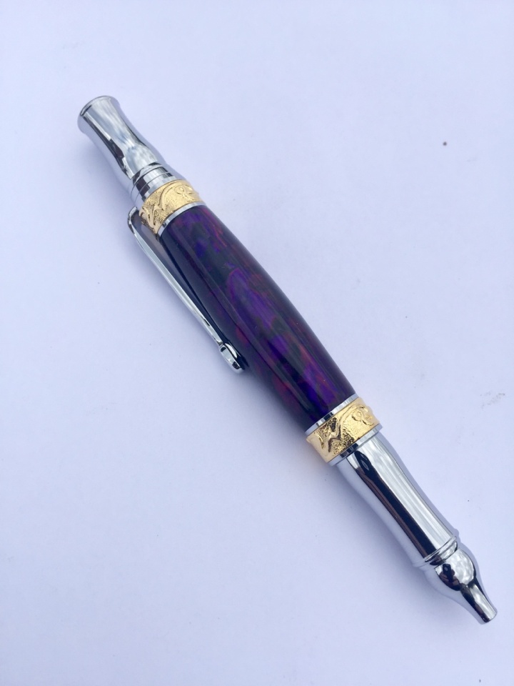

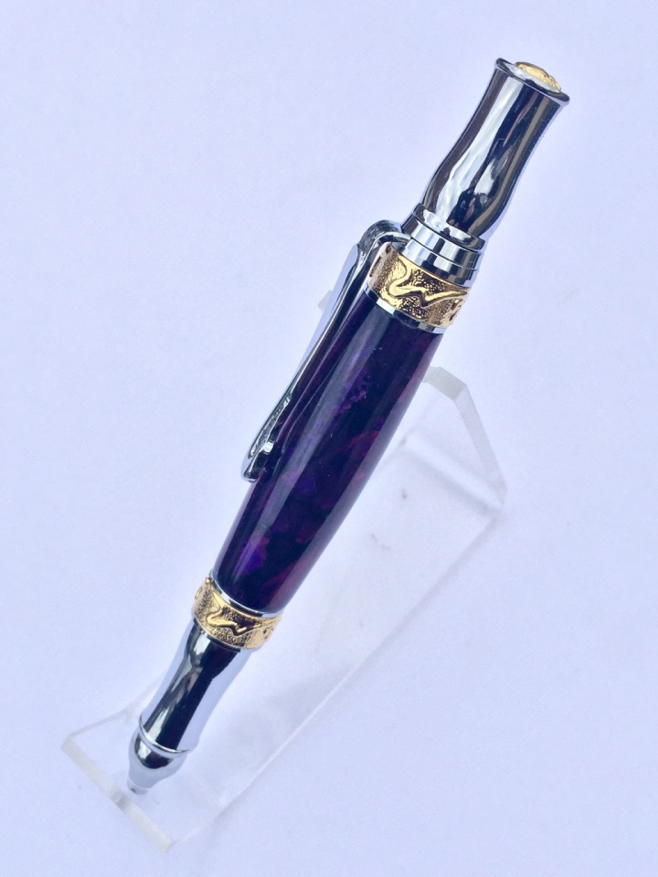

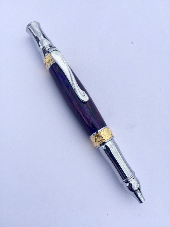

I made the blank with a single piece of purple tinted Abalone shell. I cast in LD for 24 hours at 50 psi. It's my third blank and second try with the abalone, the first was a failure. I thought it would match up well with a Chrome and Gold Nouveau Sceptre Twist kit. The single seam hides well under the clip. Comments, questions, and critiques are welcome.

Thanks everyone for your kind comments. I wasn't sure how the blank would turn out, pardon the pun. I wasn't sure how the single seam would look. Only about half of the seam was even visible that hid easily behind the clip. The darker tinted Abalone was hard to photograph but it really is rich looking in person.

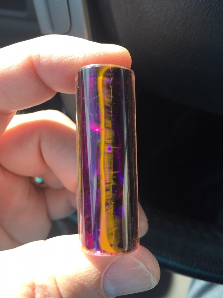

Here is what happens with a Sharpie and Liquid Diamonds.
DO NOT USE A SHARPIE!
Unless you like the orange stripe look. It will hide the seam, just not in a good way.

Hmmm ... thanks for showing ... point taken !!
