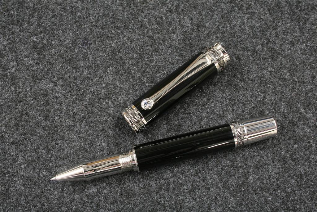

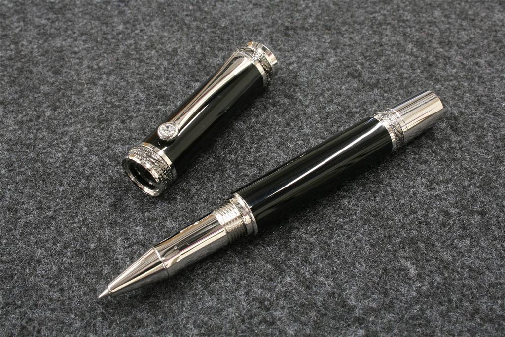

Hi I got my new pen kits from PSI and made a few of the Majestic pens this past weekend. These are really nice kits

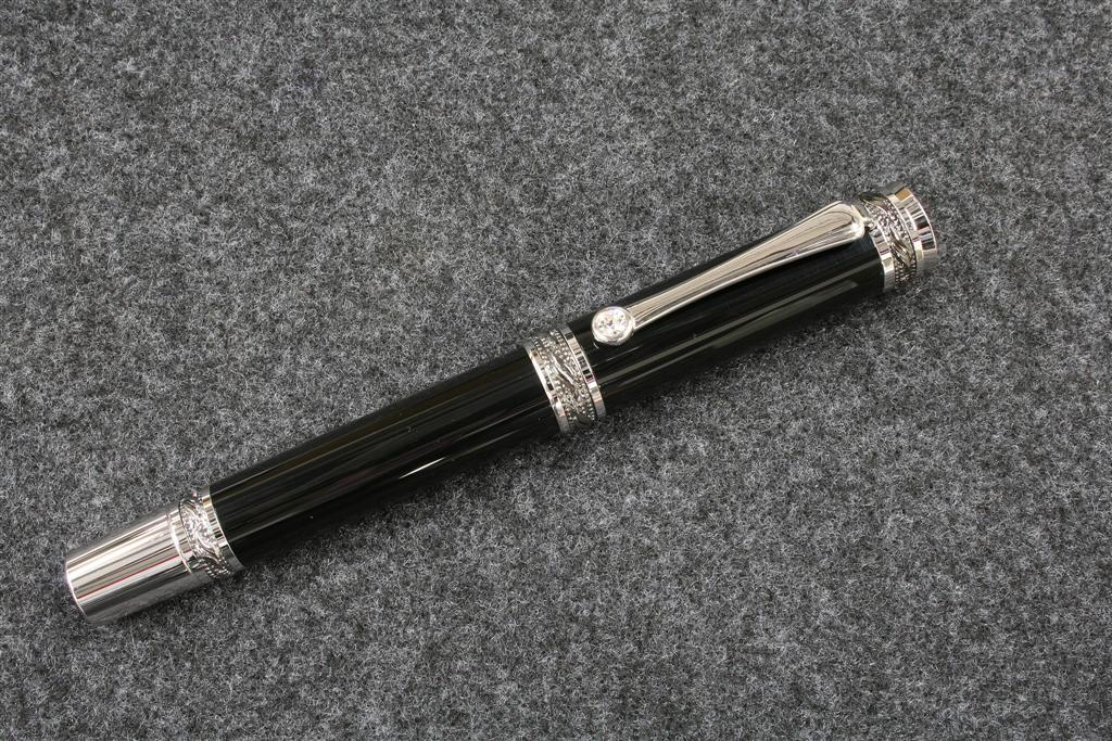

This first one is a Majestic in black titanium and platinum in a black onyx acrylic

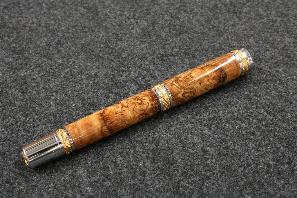

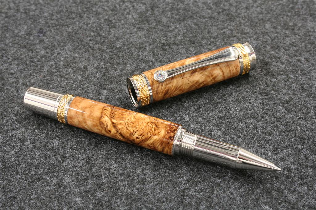

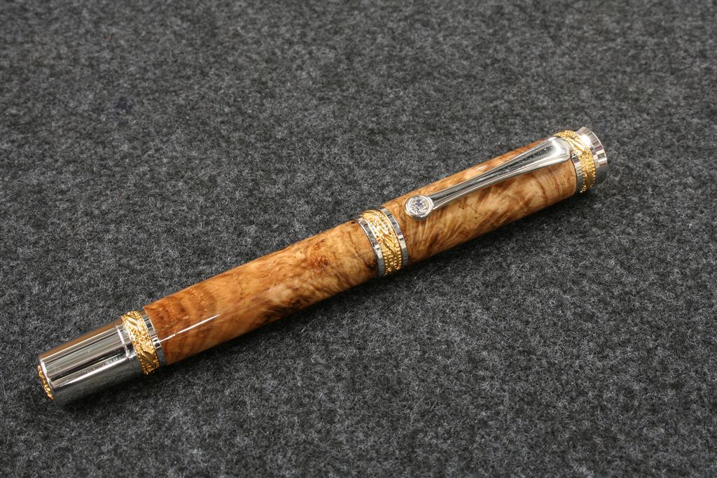

This next one is also a Majestic but this time the finish is 22k gold and platinum. This pen is made of feathered oak with a CA finish
The figure in this feathered oak is amazing!

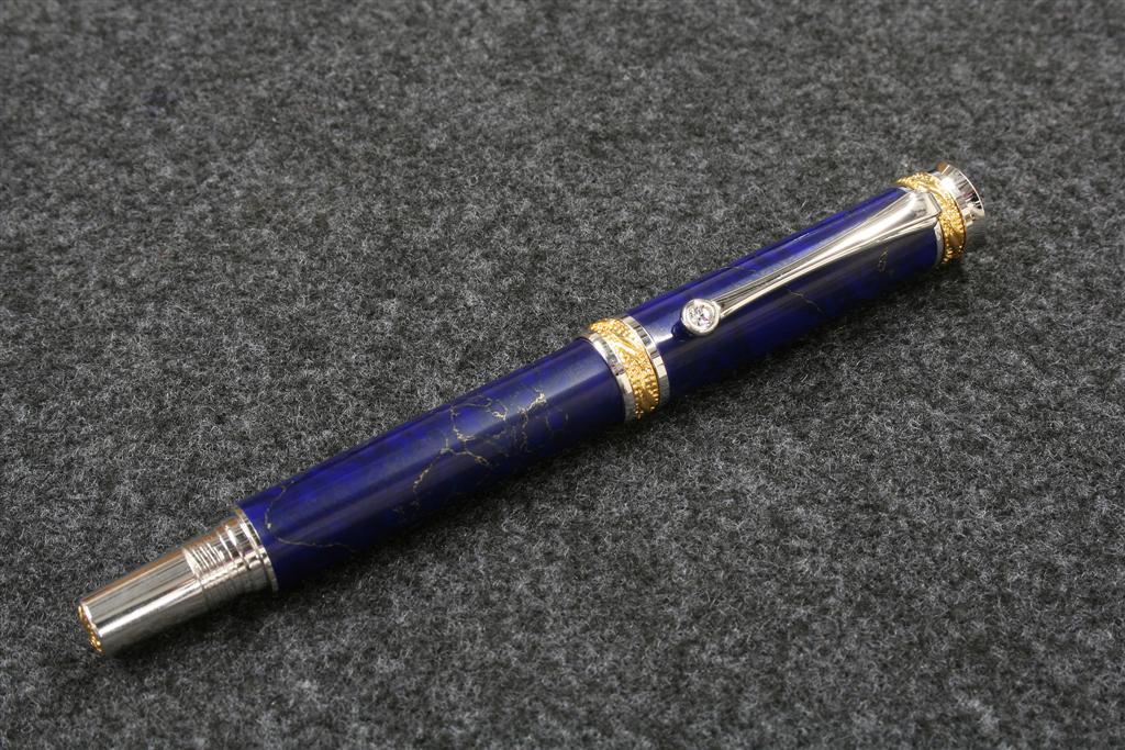

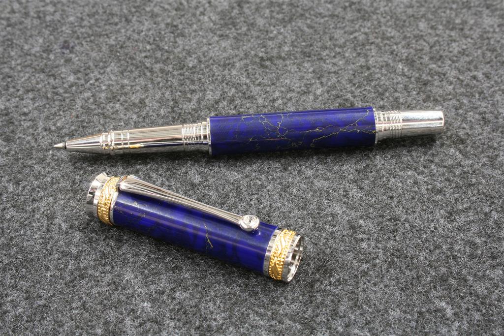

This last pen is a Majestic Jr also in 22k gold and platinum. The Jr has a post able cap. I made this one from blue lapis Tru Stone. This is my first try with Tru stone.

flippin heck, my computer nearly crashed when the photos started to load :biggrin::biggrin: those are awesome pens

So far I've only done wood - you've got me interested now in the Tru Stone... anything special about turning or finishing it?
Thanks for the tip aboput wodturningz. I didn't see the majestics on their site.
This was my first try with Tru Stone but make sure your tools are VERY sharp. We had to resharpen a few times turning this one pen. Go slow and take light cuts. I used a splidlemaster to remove most of the material and a sharp skew to get to the final size.

I stll have problems getting my finish to shine like yours what are you doing to finish it with that much shine?
Hi Jim, I went back to basics with a plain thin CA finish. I make sure any no pin holes, crack and voids are filled with CA first and I sane these spots by hand with the lathe off. Then I wipe a heavy coat of thin CA on the pen and allow it to soak in for a few minutes, sometimes I use accelerator. Then I re-sand making sure the pen is smooth with no pin holes. Then I start to build a finish a few drops at a time ad sane in between with 800. When the finish is finally smooth I sand to 12000 micro mesh and use Novus 3 step plastic polish with a micro fiber cloth. This pen took a few hours to get this finish.

Geez, I have to ask - where can I get some of that feathered oak?
A friend of ours owns a sawmill and specializes in quarter sawn white oak. He found this wood in a 100 year old tree from his family farm. It comes from crotch wood. He gave it to me to make pens for him and his wife and I have a few pen blanks left over. He said he has never seen grain like this in oak that was not a burl in all his years of milling wood. To get this board he had to waste a lot of wood so that may be why you don't see it often.
