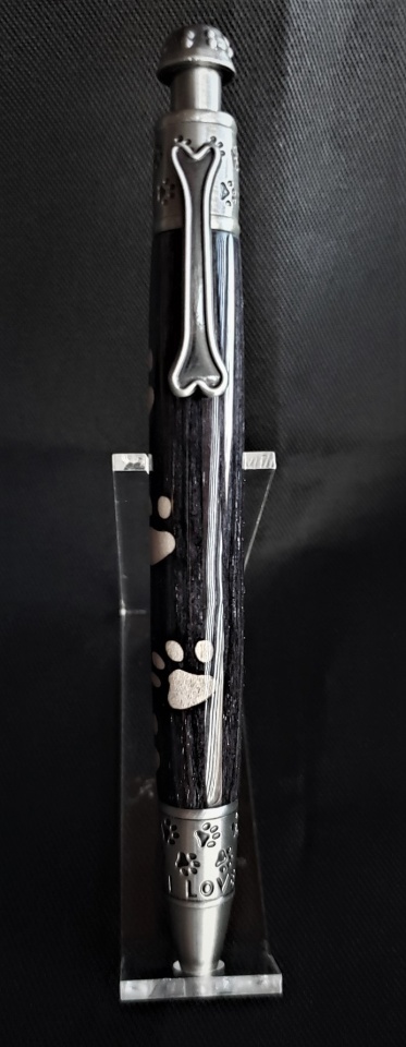

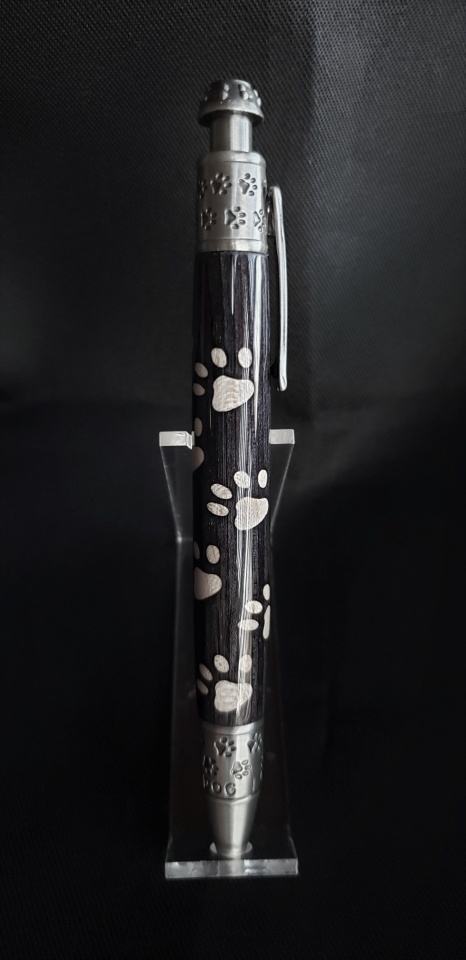

Hey Folks:
Made this for my wife. It actually has more of a black background.
Seems like a well-made kit. The clicker has some plastic in it, but works well (so far). The folks at WW sure make it easy to turn these inlay blanks.
Gluboost finish.

Nice looking pen, Tony ... as you say, WNW makes it quite easy to complete their laser-cut inlay blanks.
Keep an eye on the pen clip function as the clip is used and let me know if you observe any issue.
Thank you. The click is similar to the vertex. I just received my order of PSI Dura Clicks. I am looking forward to the comparison. The Dog pen appears to have a clip that is welded/cast in place. I hope that means no rotation.
Thanks folks!

So far I have been lucky with the one that I made. I have two more two make. The one above is used by my wife - she about 100 pounds, so not right tough pens (or chairs LOL). She does have two dogs to contend with when she tries to do any thing at the table. So far, her pen is fine (and it has been dropped, but only front table height onto hardwoods).
I did use a lot of CA to practically stabilize the blank though. What you say about the threads doesn't surprise.
