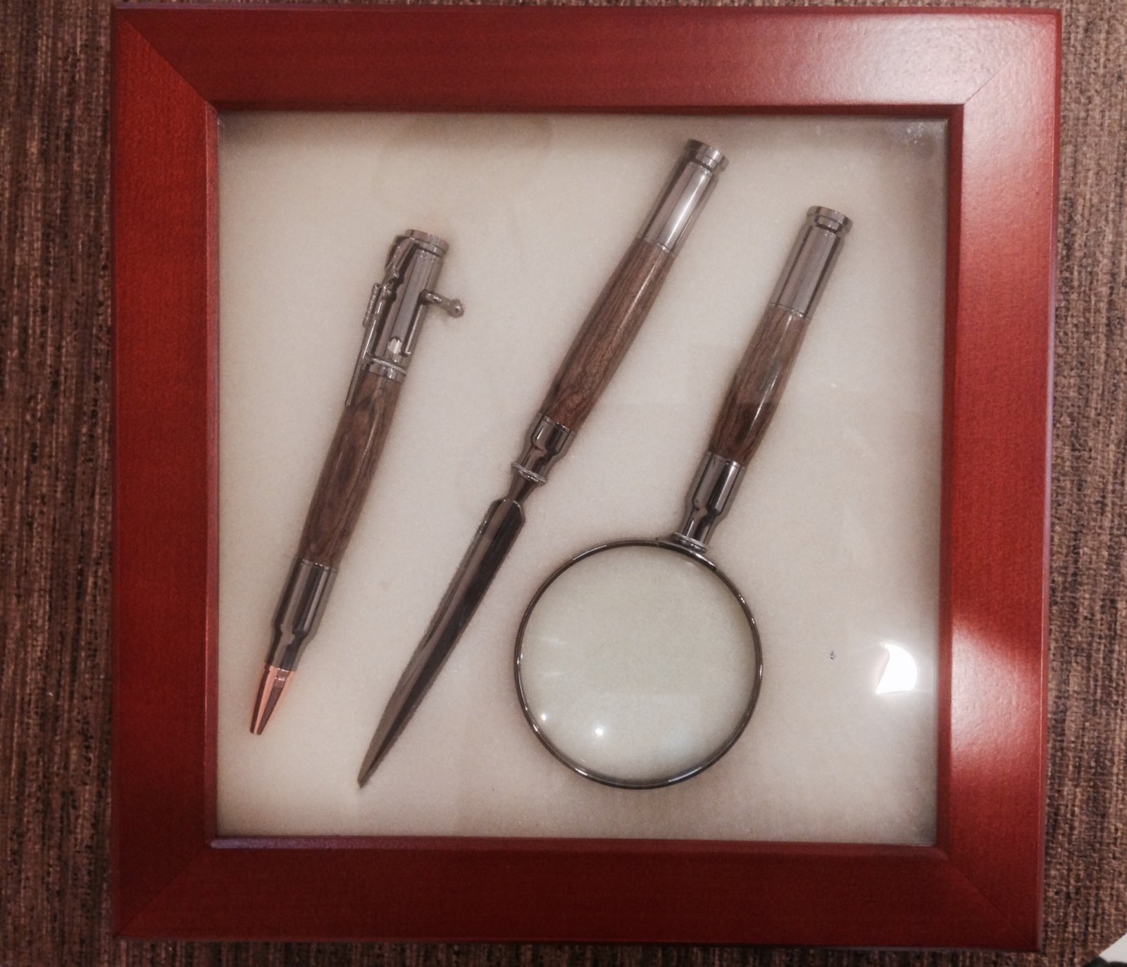

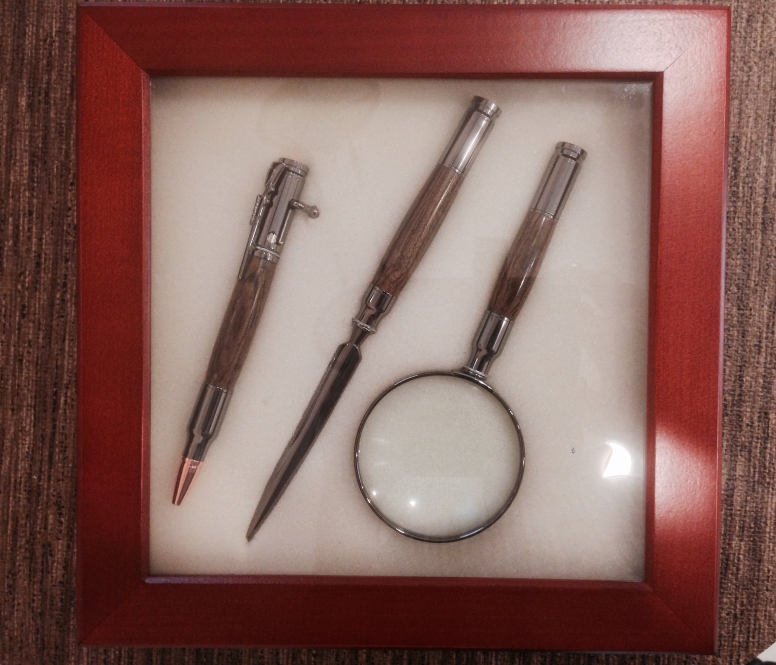

Be creative with the 30cal kits. I made this tri combo for a friend/neighbor......by request it is hanging on a wall in his living room.
