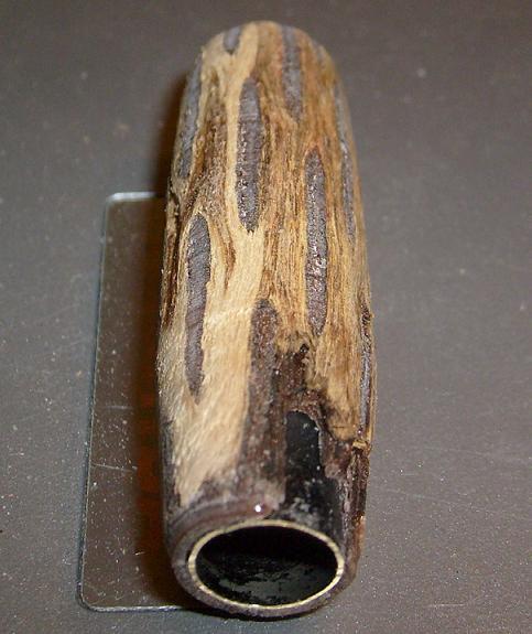

Well it happened. I think i need to stabalize the material first.

I don't know if it is cholla cactus or not. The guy i got it from called it "walking stick" cactus. After googling it. and looking at google image, I don't think they are the same cacti. The walking stick is Cylindropuntia spinosior. The cholla info says: scientific names of the various species of Chollas, all cactus of the genus Opuntia.
So it is a different cactus alltogether. I really have confidence that if this material was stabalized first, then it would work.
Don, It is already cast in PR. I cleaned a piece of this cactus (which is WAYYYYYYYYY easier than messing with prickly pear) and cast it in a 3/4" PVC mold. Then i turned it. This blank was SOOO close to final size. I was taking one more cut (always the story right?) and then it was sanding time. Maybe it's finally time for me to learn how to use the ever so elusive skew. I don't think it would have blown out with a proper skew cut. I am so afraid of that tool it isn't funny. whew.. getting nervous just typing about it.

Yeah, the skew probably would have saved your bacon there.
I was thinking worthless wood style... Mix a bright color and fill that blowout.

OH YEAH IT'S DON'S BIRTHDAY! Savarooney!!! good call. That would be a good opportunity for me to do a worthless cast, and plugged tube cast all in one! Thank you Sir! excellent idea!

Here is a cholla pen I did back in August of 2006. Cholla is a pretty generic name for this type of cactus. Another name for the walkingstick cactus is Cane Cholla so I would guess yours is considered a cholla, whatever that means!

I believe you blow out may be glue failure oriented> A skew would have been nice to do your finish turning with. It has it's own learning cure, but one secret is to always have the edge "scary sharp" ... it also will cut down sanding time if used properly.
Keep at your idea and post additional pictures of your results.
BTW, GET A SKEW!!!

Thanks Fred. I thought i had good glue coverage. Normally i use a Q tip to get glue all over the inside of the blank, but didn't do it on this one. Guess that is a pretty important step!
BTW. I have a really nice skew, Just don't much know how to use it.

If you can find the chip:
Turn it undersized and get a resin saver mold.
Worthless wood cast it w/ Alumilite CC.
If you can't find the chip, leave it big, pick a color, then
WW cast it and turn back down.

Well, don't lose all hope on it. You can always part it off and do something segmented. I've screwed up a few on the ends and had to part off and add something else and they ended up looking better than I think they would have in the first place...
