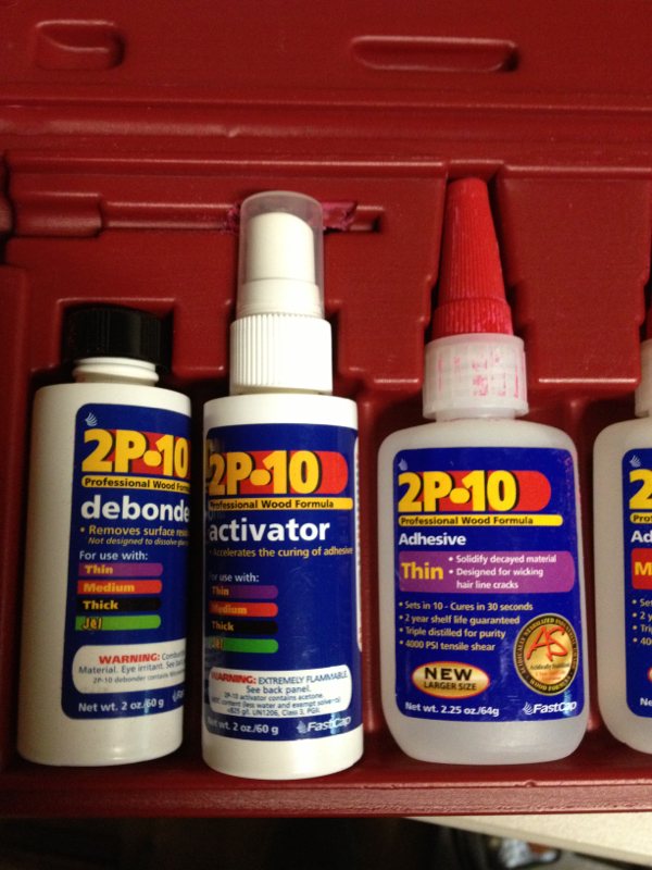

One thing I found interesting is there is only one pump sprayer in my kit. It fits the debonder (I used it that way) and it fits the activator. If you were switching the pump back and forth, there is the chance that you would spray debonder on your pen, (residue in the pump) when attached to the activator. Just need to be diligent cleaning the pump sprayer out between switching products. Potential to cross contaminate the products also.

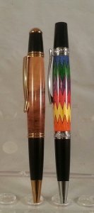

I got mine last night and tried it on finishing today. I already had some blanks ready to turn and I had been playing with my new pressure pot and Alumilite for the first time, so i decided to do a worthless wood for my test finish. The only two products i used from the kit was the thin and Medium. so i'll give quick review of those. I had turned the blanks and cleaned with dna and a quick wipe with blo which is my normal treatment. I started with several maybe 8 coats of thin and then an additional 8 coats of medium. Can't say I can tell much about either that was different from the hot stuff I'd been using except the thin was really thin and dried almost too fast. The medium was like the other one as far as I could tell just doing one pen. It may have dried a little quicker too. I will try gluing blanks up with the gel and see how that goes next anyway here is the pen i really thought it turned out nice!

The pump sprayer in the kit is for the activator and the little brushes in with the screw on cap is for the debonder. Of course, with your comments, maybe FastCap will include two pumps in the kit.

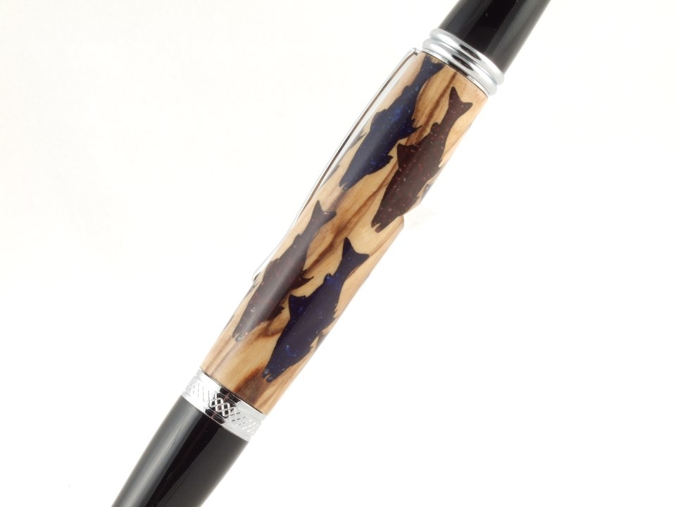

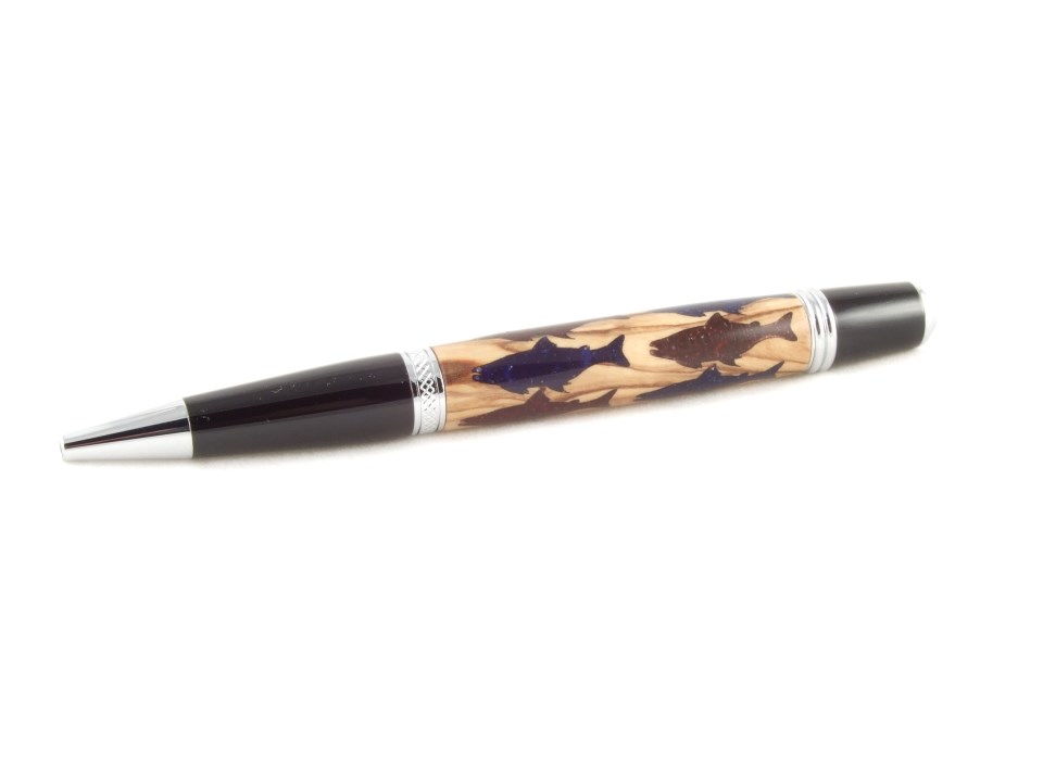

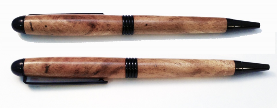

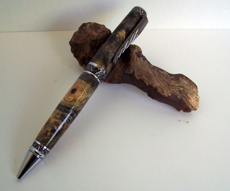

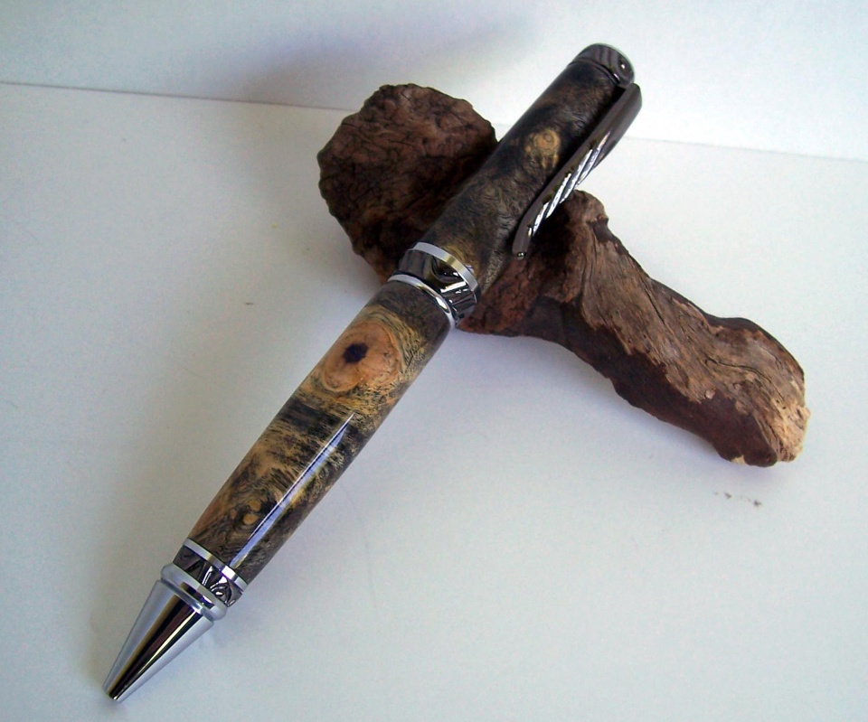

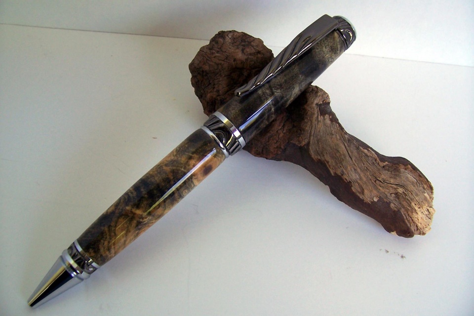

This buckeye burl barrels were glue in using jel 2p-10 ca after my normal sanding method, was finished with 2 coats of 2p-10 ca thin, 8 coats of medium... after finish sanding and before assemble I found a gap on 1 of the eyes in the lower barrel... which I filled using the jel again and then sanded... then approx. 4 more coats of medium 2p-10 ca sanded again and then buffed... over all after learning the properties of this product I found this ca glue finish was as good as others I have used... but after using it some more I may find it superior to purchase because of the reasons listed below.
1. shelf life 2 years 2.convenience of this well thought out bottle design, needle inside to keep open the tip. 3. the kit holding all the ca products in one organized storage container 4. because it drys so fast it limits the need for accelerator. These are my first impressions and I will post more later. Best regards. Ronnie

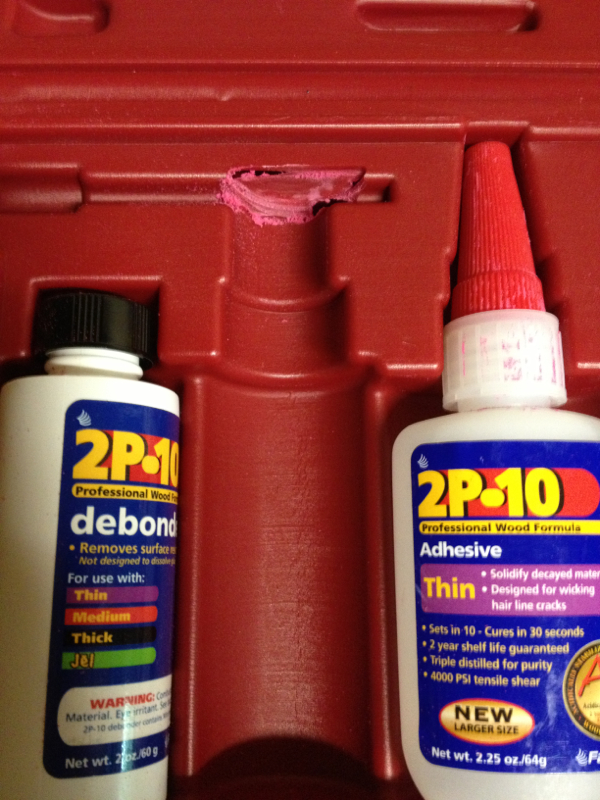

On the case a little work with a wizard did the trick. Not the prettiest but works. They just missed molding this for it to fit. On the next round of cases maybe they can change this. So far really liking the glue.

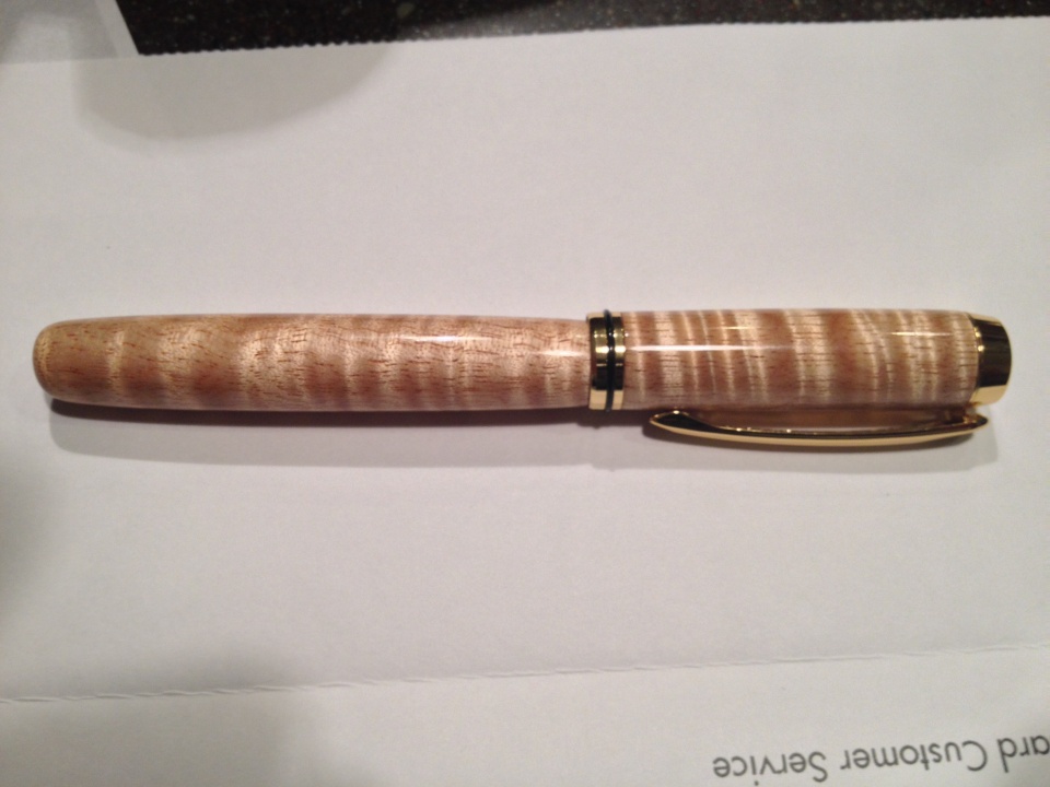

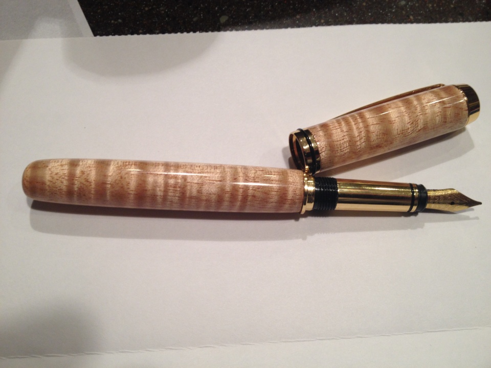

Finally had a chance to try my first pen last night with this ca. Very pleased with the thick ca. Nice not having to cut the tube neck. For thick ca, it did seem to set up quick. Will be experimenting with other pens this weekend. The case is nice to keep the glue in. I would be tempted to switch over to this glue just to keep my glue organized in the case. I have glue bottles spread all over my shelf.

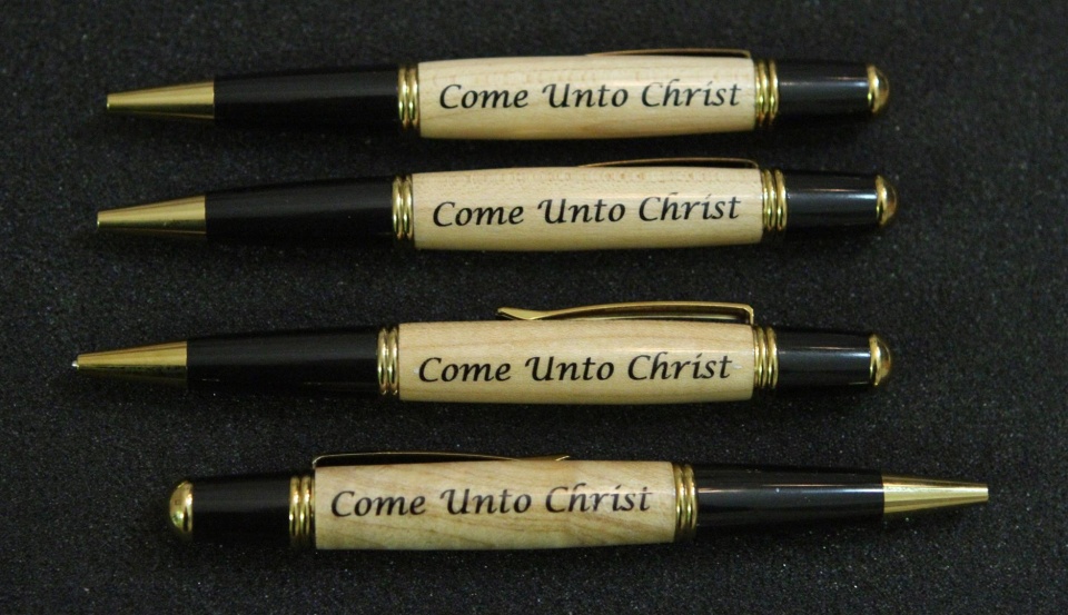

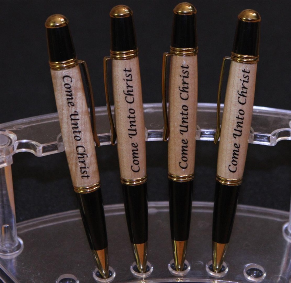

I used the thin and medium, with BLO, to finish the set of pens pictured. I found them to work great and produce a very smooth finish with no orange peel. It was a breeze to MM and finish with Novus and PlastX.

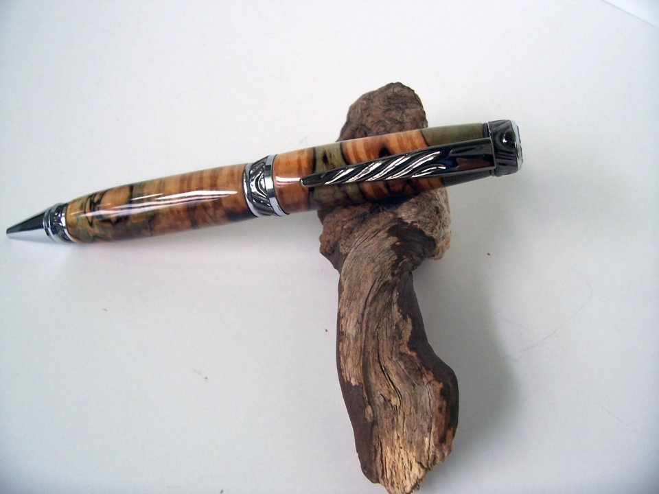

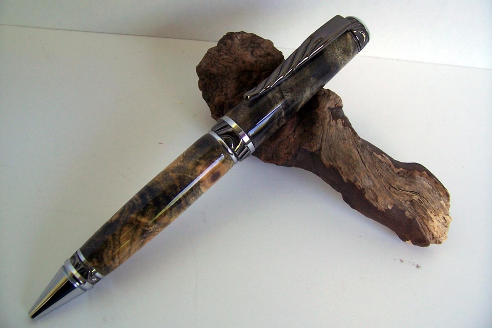

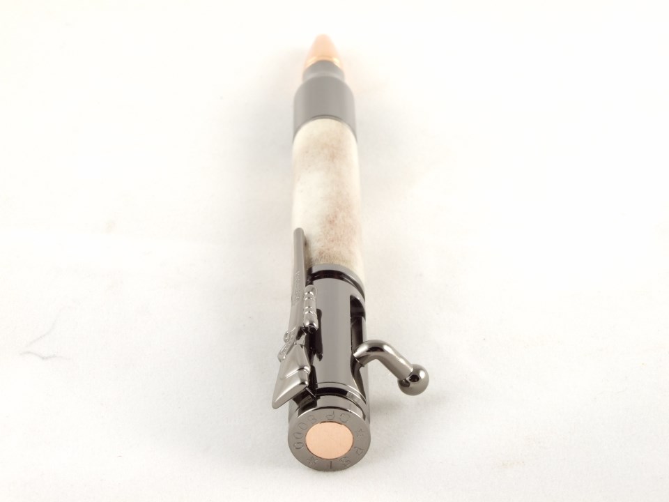

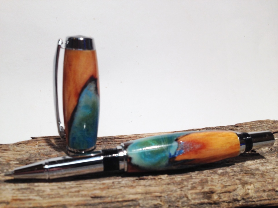

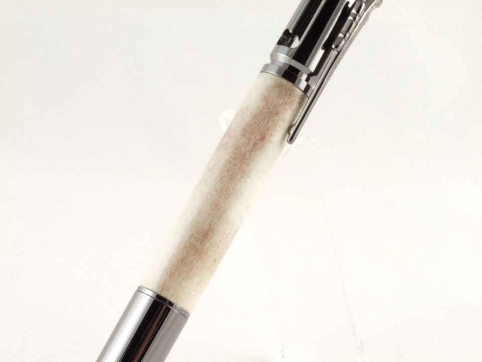

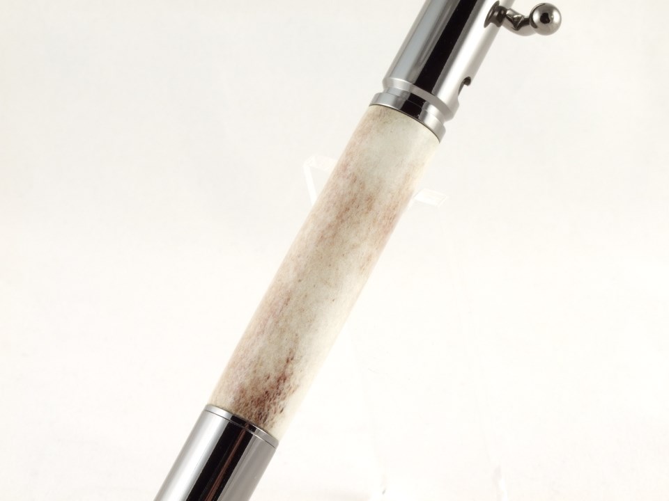

First finish test: CA on antler bolt action: Used thin and medium, 6 coats of each, built up just how I wanted it. Dries fast, one of the fastest CA finishes I've done. Very happy with the result.

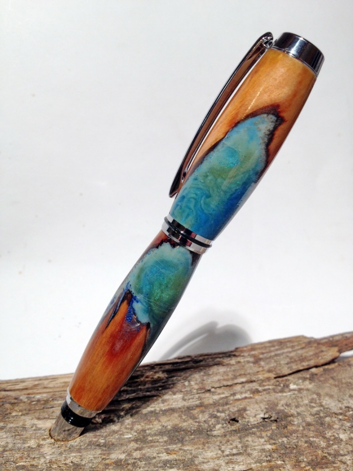

Second colorant fill and finish test:
I used the blue and the red colorant as a test. A few things stood out here.
-The working time is very long. When Mark posted about coloring CA I couldn't wrap my mind around it. Watched a video on 2P10s site and exactly as described:
https://www.fastcap.com/estore/pc/viewPrd.asp?idproduct=9913&idcategory=48
Plenty of work time and good results.
-Used the jel, it shrinks fairly heavily so I did fill a couple of times. I can see some of the brass around the red so I didn't apply it perfectly but for a first run I was happy.
-The colorant is very concentrated, don't have to add much to the glue.
-When sanding not a lot of bleed. I was concerned about this, especially mixing colors. I noticed no bleeding.
Sorry for the long rambling, Mark hopefully this helps. Thanks to you as well as FastCap for putting this together, I've enjoyed the thought process and will use the product again. I've fixed a lot of kids toys with it already too!
As a suggestion, I prefer aerosol accelerant but the pump has it's applications to me too. Maybe they can offer an IAP pack of the kits we got, an aerosol accelerator and colorant pack? Not sure that many would want all of that but of the products I could see value in that package. But the prices seem fair, especially at free shipping with $100 order. I could see small regional group buys before club meetings being advantageous.
Thanks again, here are a few pics, let me know if any questions.
Warren

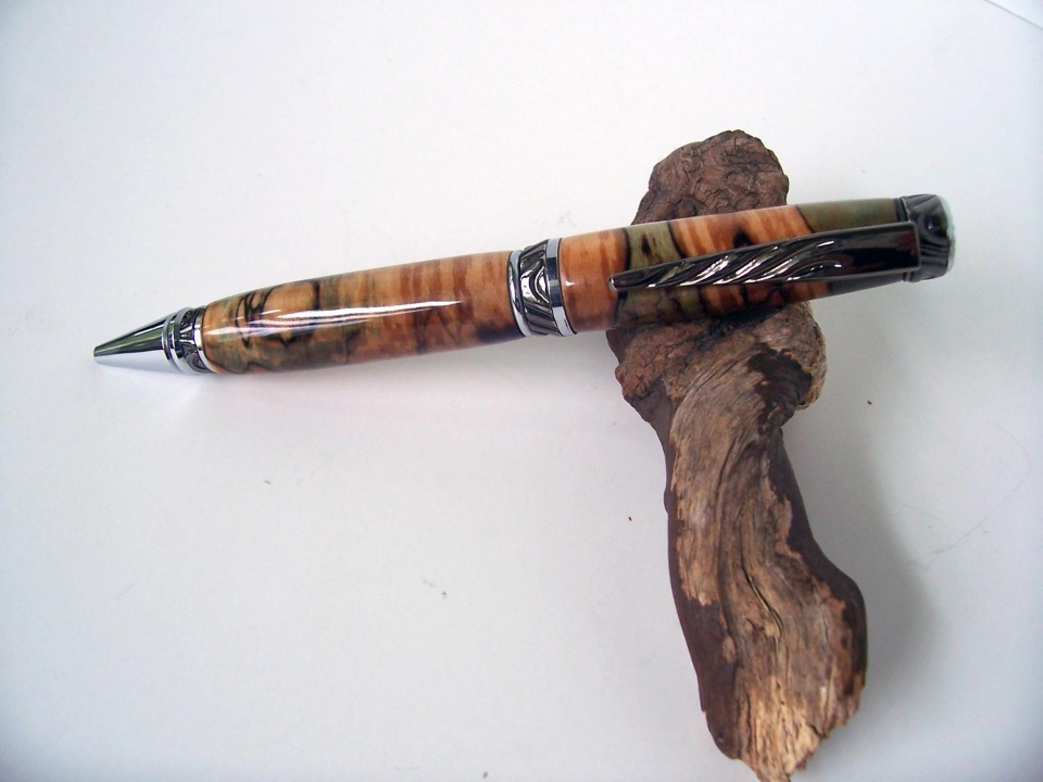

The following 2 pens were done using 2p-10 ca as a finish and tube glue up.
I do hope this review is a help to all and thank you for allowing me the opportunity to participate.

I've been very busy with work, but finally got a chance to turn something and test the CA. It gave me an excuse to get some shop time and to try a closed ended pen for the first time. Fit isn't perfect on my first attempt, but the finish is...thanks to this CA. I used a punch as a jam chuck and it wasn't centered perfectly, so it was a little OOR. I'm happy with it as a first attempt though. I used an old Jr Gent 1 kit in case it didn't turn out well. Thanks for the chance to test out this glue. I think it will be my go to CA.​
2P-10 PENTURNER QUESTIONNAIRE​
1. What do you think is the BEST qualities about 2P-10 CA glue?
Set time. It seems to cure faster than the EZ-Bond I was using, which I like. The faster the better. I don't like to use much activator, I just wait it out. This stuff is fast enough that I had to change gloves a couple times because the paper towel stuck to my glove before I got rid of it.
2. What do you think are the WORST qualities about 2P-10 CA glue?
None for me. For those that don't move quick when applying it as a finish, the speed of setting could be a negative. For me it's a positive and the reason I would pick this over other brands.
3. What would you suggest to IMPROVE 2P-10 CA glue?
Make a version that's even faster setting? It's pretty good the way it is.
4. What size bottles would you buy 2P-10 CA glue in or are the offered size bottles good as they are (2.25 oz or 10 oz)?
I think these are good sizes
5. Would you buy the activator in a larger refill size for the pump sprayer?
Possibly. I would like to get an aerosol sprayer like many of the others have and pour it in.
6. Did you have an allergic reaction in any way to the 2P-10 CA glue or activator?
No. Same smell as other CA glues I've used. Possibly slightly less odor, but in no way odorless.
7. Did you tint the 2P-10 CA glue? What did you use for tint? Was it satisfactory?
I didn't try tinting the glue.
8. If 2P-10 was offered to IAP members at a discount, what do you think would be a fair price for the CA glue? For the Activator?
I think the EZ Bond brand I was using was around $5 for 2oz and $16 for 8oz so similar pricing would be fair. I think $1/oz is a good price for accelerator, using other brands as a reference.
9. If you fine another brand of CA glue to be better, why do you think it is?
I think I like this the best, after 1 test of course. Of the few brands I tried previously, I had good luck also with EZ Bond.
10. Did you have good or bad results when using the activator?
Good luck. I think it's milder than the regular EZ Bond accelerator (they also make a mild I haven't tried). With the quick set time on a thin layer you use in finishing, mild is what you want I think. I used 20 coats of CA and only used the activator 4 times or so when it was staying tacky longer than I wanted. It took care of that in a hurry.
11. What other uses would you use 2P-10 CA glue for?
Anything super glue can be used for. I glued a magnet back together for the wife, and a puzzle border for the kiddo with good success.
Thanks again for the chance to test the glue. I will probably be a customer if my experience is as good going forward as it was with the first use.
The pen I made is from Okoume. Only the second time I've used this wood. Very soft. It's cool because the light and dark "stripes" change places as you look from different angles (chatoyance?).
Finish
I've been working on some decal pens for our Church youth group. These are some maple with a water float decal. I thought I'd share my thoughts on 2P-10 over decals. Bottom line is it works great.
1. I sanded and sealed my blanks with thin.
2. placed my ink jet decals (that had been sealed with Krylon clear).
3. three coats of Medium
3. three coats of Thick.
My only complaint and its minor, medium seems to soak through the paper towels quicker and I get more glue on my fingers that with other products. I think I could adjust as this is more operator error.
I used the Thick glue and it goes on great.
One question to the group. I've always used aerosol activator, and had to be careful how close I was to the blank when applying it. I tried to stay 18 inches away, too close and I got white cloudy spots. I've used the pump activator in this kit much closer, like 6 inches and no cloudy spots.
I don't know if that is the difference in the product or the method of delivery?
Do others that have used pump activators have issues with cloudly spots?
Anyway the pump sprayer activator with this kit is slowly converting me to pump sprayed activator.
As soon as I finish sanding and assembly I'll post the pictures of my pens.
Thanks for giving me a chance to try this product.
I have found that if you go heavy on the activator, you stand a good chance of having white spots or foam. Go easy on the activator.
I know what you mean about staying a distance away from your project when using aerosol activator. It comes out with too much force and can "push" the CA out of shape.
Well, I've had the exact opposite experience. The activator I had already is Mowhawk brand and is heptane based, and the FastCap activator is acetone based. I placed a drop of glue (I think it was medium) on a plastic bag, and drenched it with the FastCap activator. It cured rapidly, and may have smoked slightly, but no "popcorn". I tried it again with my Mohawk activator, and it smoked and fizzled and turned into popcorn.
Pictures
Here are the water float decal pens I am making for our church's young women's youth group that my wife is involved with (going to be Birthday gifts).
I used thin, medium and thick 2p-10 CA glue on these. I also used the accelerator, with no issues.
these are SPW Le Roi (titanium gold and black chrome), the wood is maple.
1 left handed and 3 right handed.
thanks again for letting me review these products.

Initially, I was not sure what the brushes were intended for so I used them just for the debonder application. The brushes were easily knocked from the case when placed on top of the microtips.
I liked the precut tips on the glue bottle except for the initial ejection of glue as described above.
I love the debonder! I put glue on several surfaces (some accidentally, others intentionally) and it did an excellent job of removing the glue.
As a finish, I applied the glue while it was raining and used both the 2P-10 activator and another brand of activator. With high humidity and with both activators, the thin/medium glues provided an excellent finish without cloudiness.
I also liked the fact that the typical off-gassing smell of CA glue was not as prominent as it is with other brands of glue.

When the kit first arrived the cap of the medium was glued onto the bottle. Other than that I had no negative experiences with the glue.

Quick follow up to my review.
I still really like the Jel for gluing tubes into the blanks.
The caps do manage to glue themselves to the bottle still. Ended up needing 2 pairs of pliers to undo one of the caps but once it was freed up I was able to clean up the tip and all was well again.
Still a better bottle than many other brands though.
I've done quite a few CA finish pens and am happy so far
