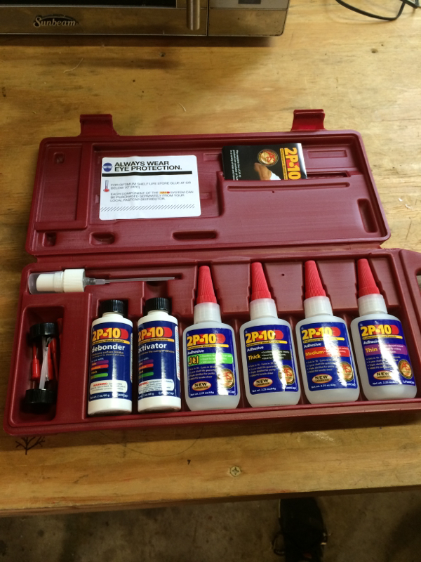

Got mine today. Great packaging as others have said. Way more than expected for a free test. I prefer aerosol for activator for the mister is well made so sure it will work. I've looked at their prices and they are very fair and free shipping for orders over $100. May be good for local club orders or IAPers that live near each other.
I'm gluing some tubes tonight (antler) going to try thick and jel to see how that goes.
I did fix Lightning McQueens rear wheels tonight. 3 yr old crashed him a few nights ago so the jel did the trick and he'll be back with his buddy tomorrow for more crash tests : )
Will send full report as I get to test some more but so far promising. Great case and design.
Not sure on the tinting idea, seems like a neat idea but can't think of too many times I would use it. Maybe in place of reverse painting. Would that work for filling voids as well I assume?
Anyway, thanks again for arranging the test, lots of goodies to play with
