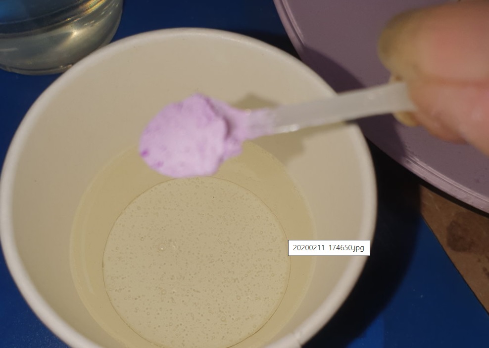

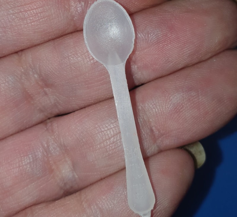

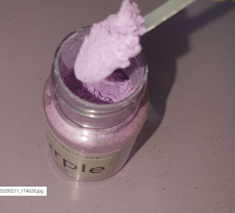

I went out and poured some blanks so I could get pics to show you my process. Here goes.

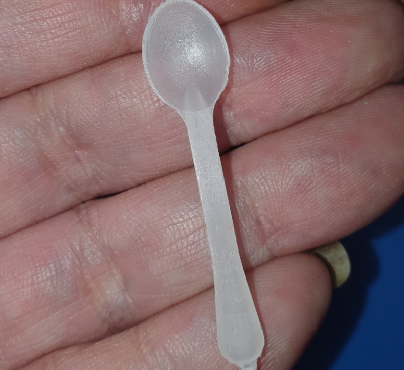

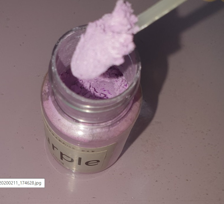

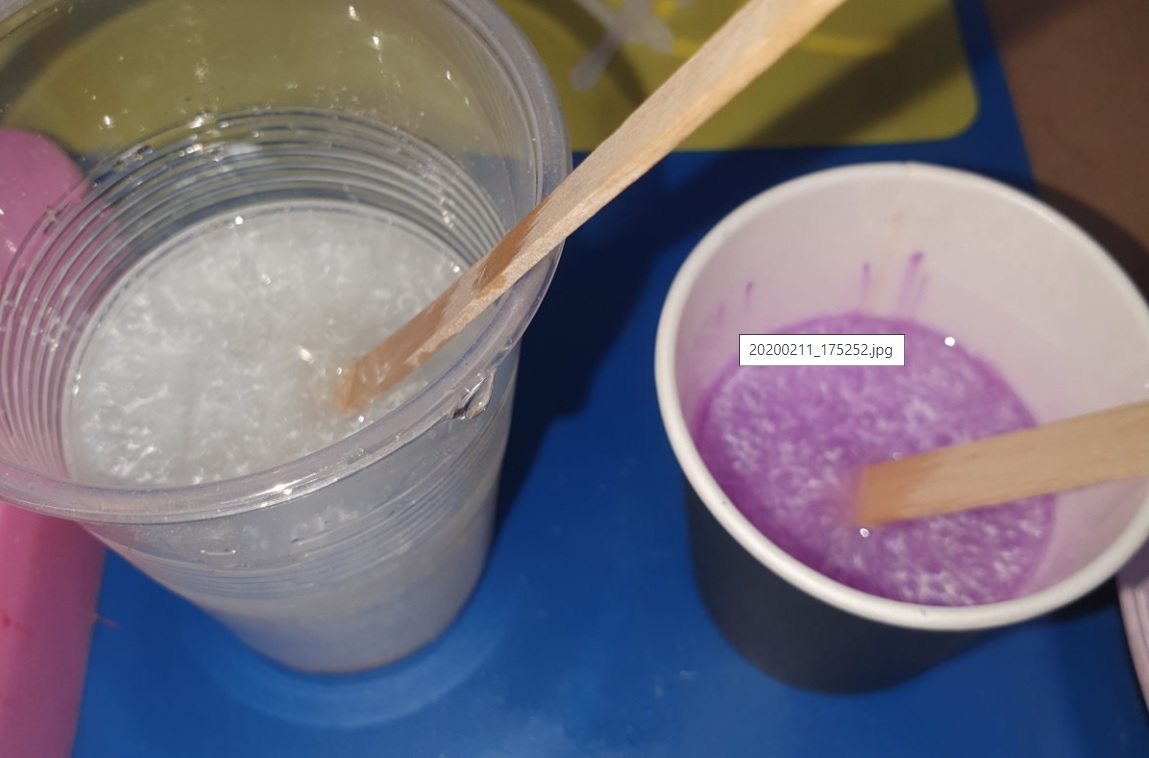

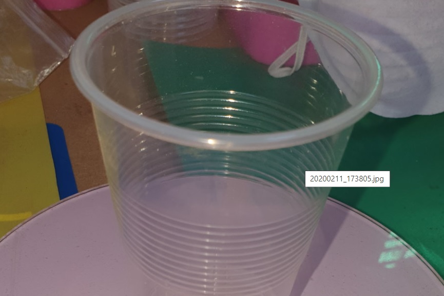

I mix up enough resin to put all 3 blanks, them divide it up into cups Lynne2.jpg

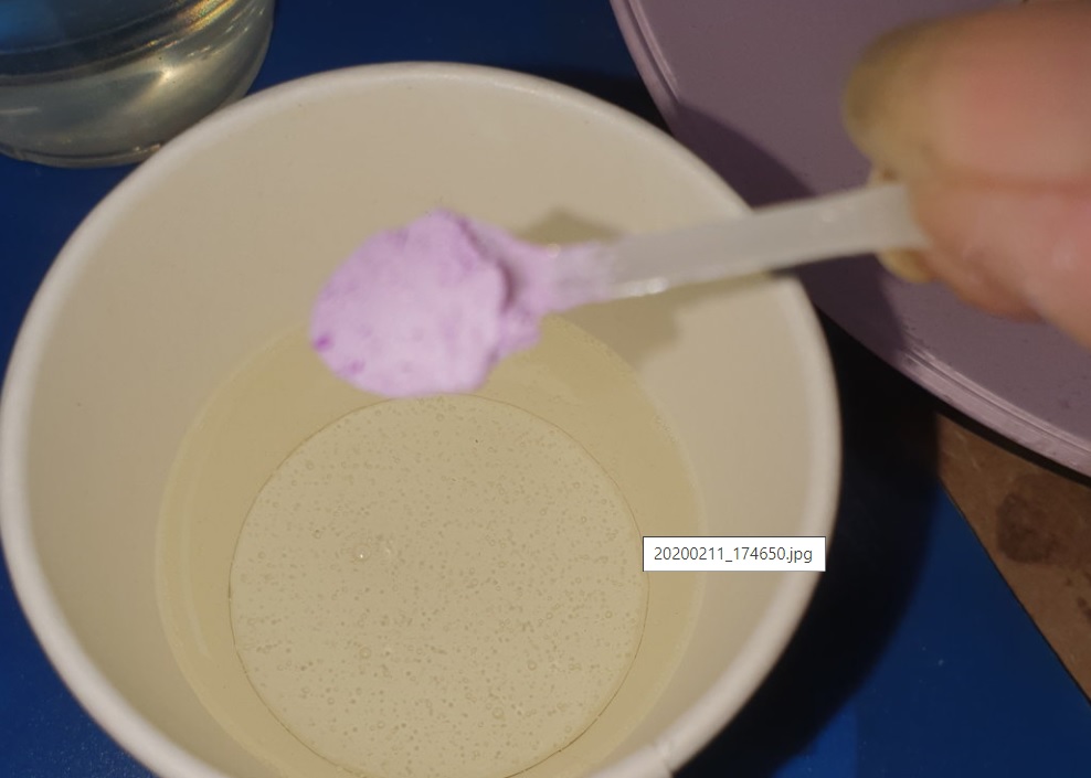

This is what I put in today in to grams of resin. I added slightly less micro pearl to the other cup. Lynne5.jpg

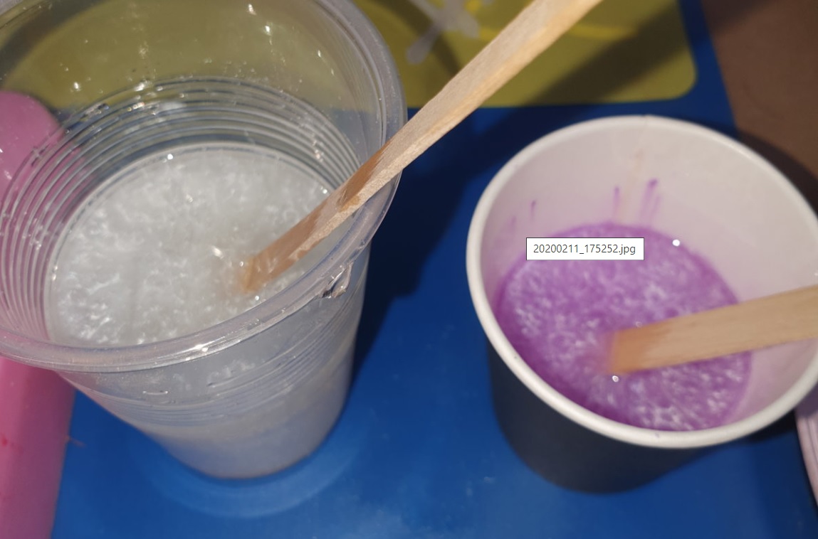

All mixed up, and to me, this color is not deep enough. It's to translucent, but we will see how they turn out tomorrow. Lynne6.jpg

I also need to know the volume of resin (ml or gr) of part A and B before you add the powder.
That powder doesn't look like Pearlex but anyway, for a normal 3 blanks mold pour fill that small spoon with the powder as if you were adding it to resin, make sure you try to fill it up as you normally do and they weigh it (powder only) and let me know, none of this info was seen on your pics and I need that info, sorry.
Mistake #1 - with these sort of powders, adding more won't make it any darker, too little the mix gets semi-translucent with little/low pearl effect, too much, the pearl effect increases significantly but the colour stays the same only more opaque/solid. Darkening of certain colours can be achieved by adding small amounts of black, brown, depending on the shade of the original colour.

For 3 blanks, I use 104 grams of resin with 51 grams of hardener. The purple was not pearlex brand, it is a natural mica powder I got from china . The micro pearl I used is pearlex.
I will measure the amount of powder tomorrow when I go out to demold the blanks and send that info through as soon as I can.

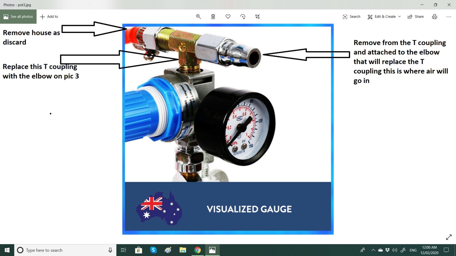

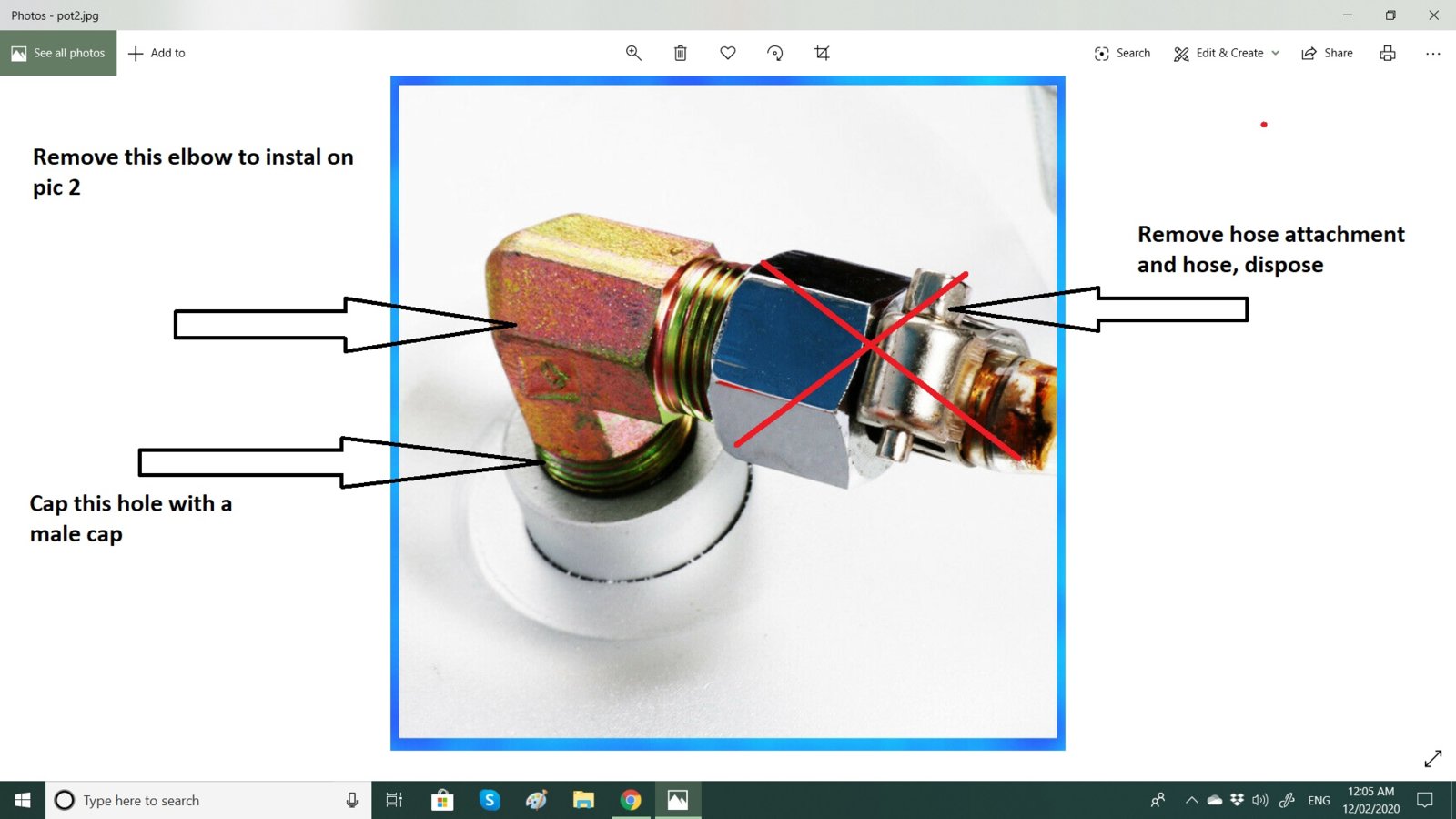

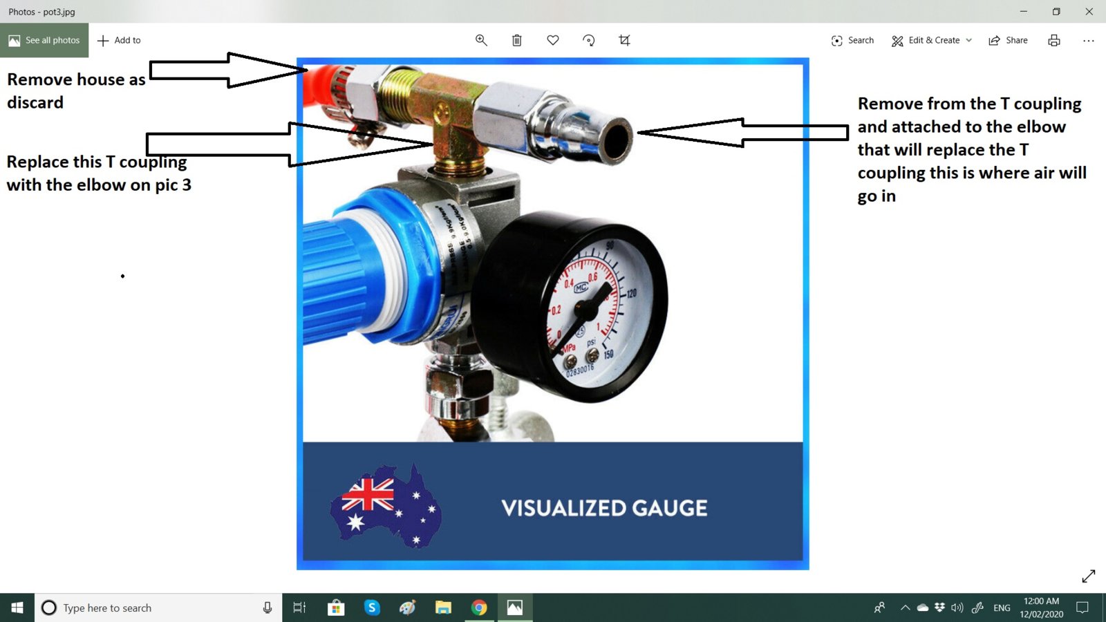

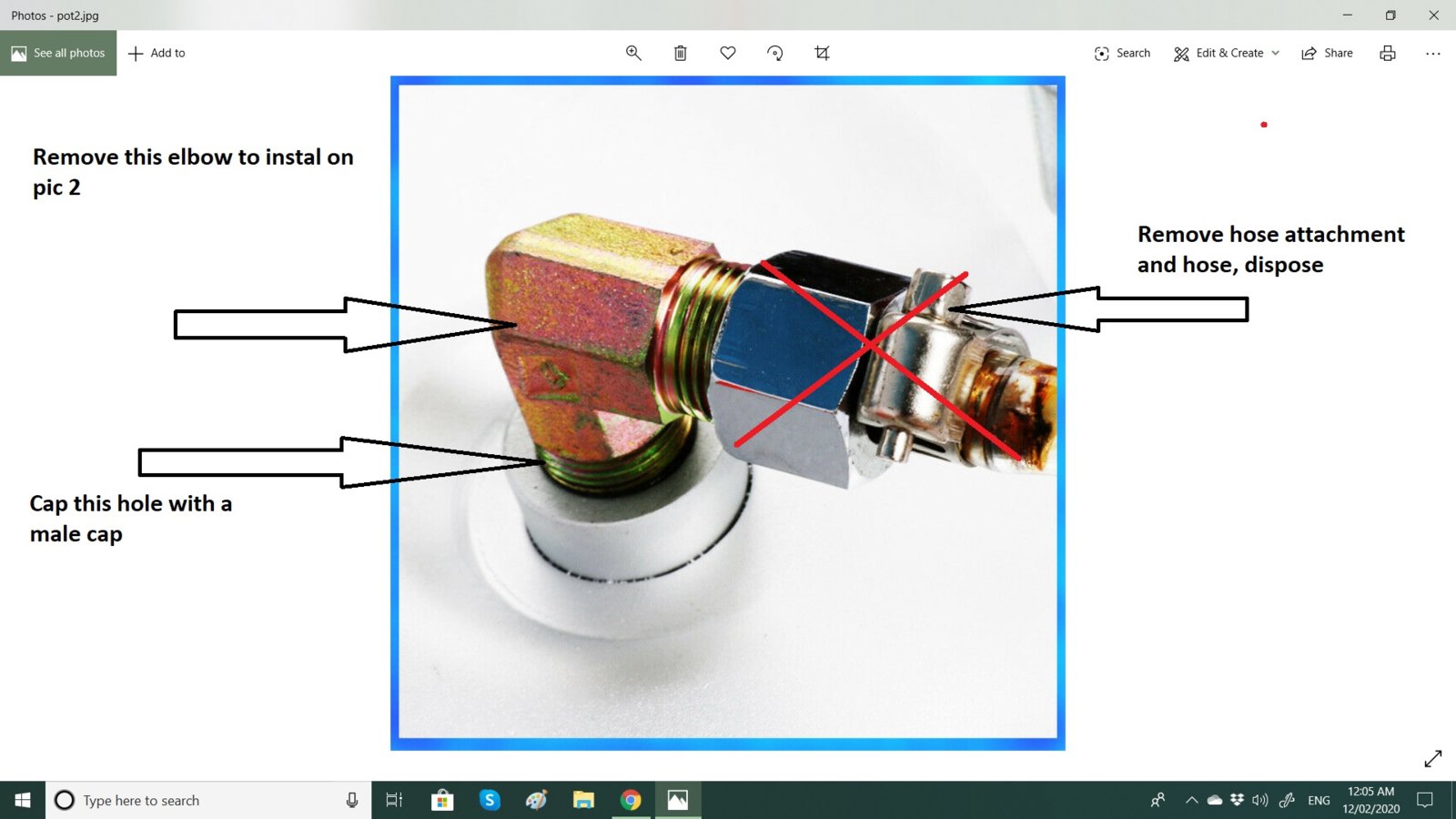

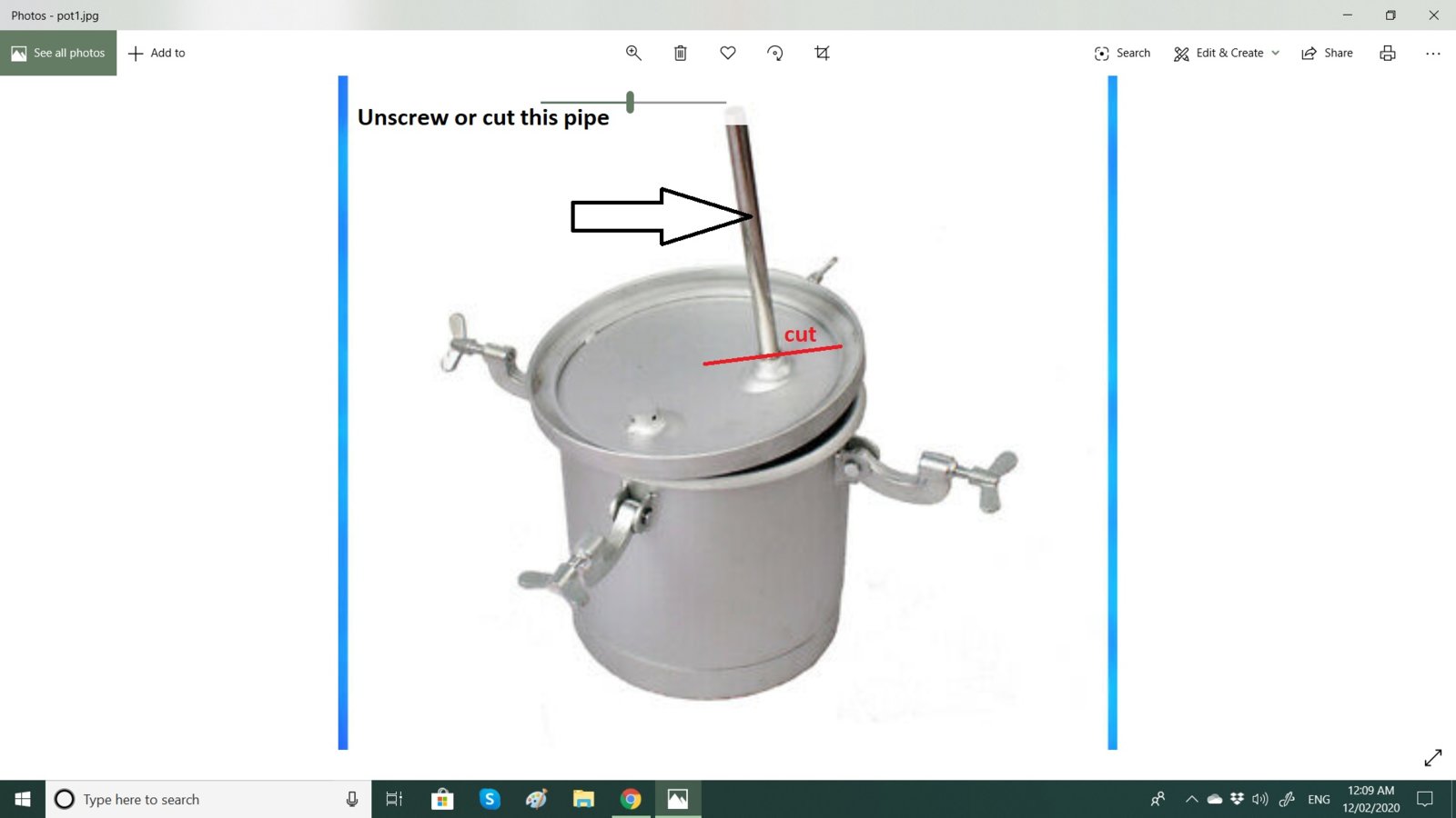

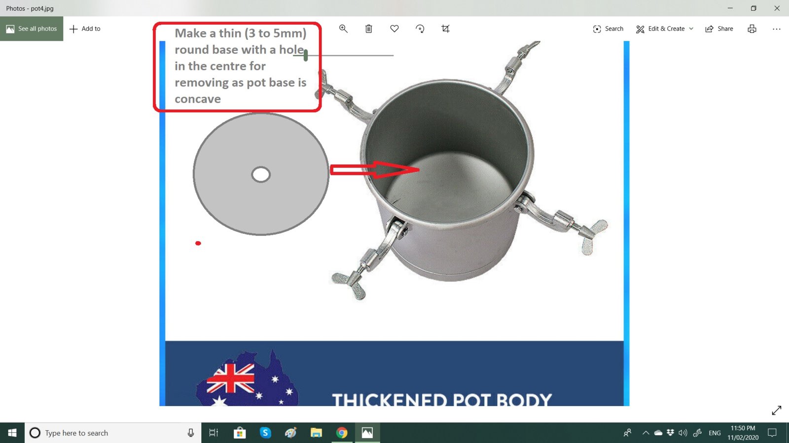

I have just found a great pressure pot for you, not only is rated at 98PSI max pressure but some of the new accessories type on the pot lid are ideal to convert into a casting pressure pot.
This is the eBay link https://www.ebay.com.au/itm/10-Lt-Pressure-Pot-98PSI-Spray-Gun-Tank-Hose-Gauge-DIY-House-Paint-Air-Tools-New/153603376070?_trkparms=aid=333200&algo=COMP.MBE&ao=1&asc=20171012094517&meid=328511fd5fbc4970bdf19f671a57357b&pid=100008&rk=2&rkt=8&sd=131243744457&itm=153603376070&pmt=1&noa=0&pg=2047675&_trksid=p2047675.c100008.m2219
The alterations necessary to turn this paint pot into a casting pot are minimal and very simple, I have screen pasted and edited the images that will show/explain what to do, see attached pics...!
Leaks are what should be avoided to preserve the correct pressure inside the pot after disconnected from the air compressor, any accessories replaced or moved should have white thread tape on the threads of the part, sometimes original parts need to be heated with a hot flame to loosen the glue they use in the factory if reusing those parts use thread tape always when done pressurize the pot to 40 to 50 psi and look for leaks, soapy water helps to find any leaks but in instances where there is a leak but it can't be found by these methods, you may need to find a big enough container where you insert the pressurised pot to locate any leaks.
The lied rubber sometimes doesn't seal properly from factory, in that case, request the gasket replacement from the supplier. There are ways to preserve that rubber seal and at the same time help the rubber to seal better, products such as vaseline are great, remove the rubber seal from the lid rub a small portion of vaseline on the channel where the rubber goes then rub a little bit of vaseline also on both sides of the rubber. To prevent leaks is important that the lip of the pot is clean before putting the lid on for pressurization, a small amount of vaseline around that pot lip does wonders. After a few uses, clean old vaseline and replace with new in all places where vaseline was applied in the first place. I follow these procedures with great results.
If you have any further questions, please ask away...!

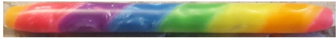

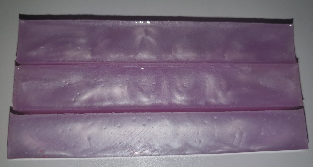

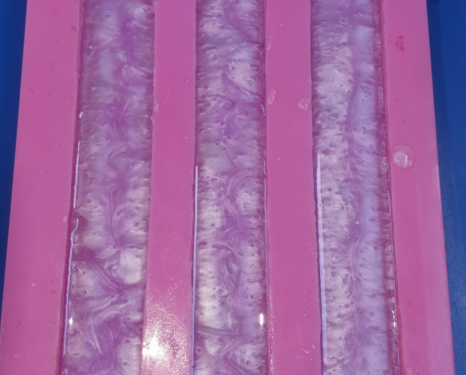

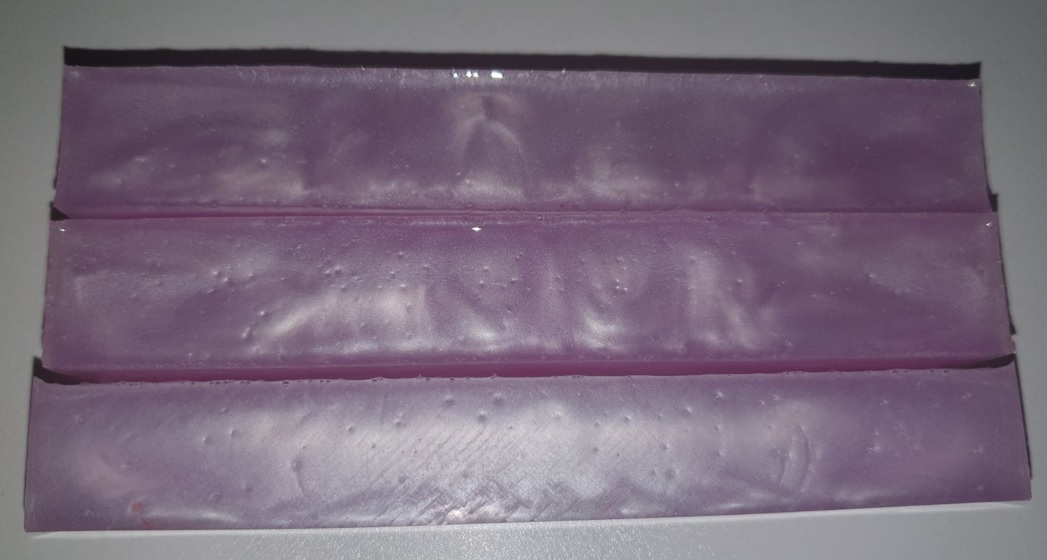

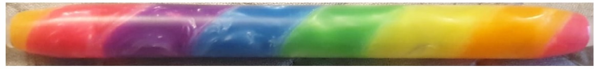

Demolded the blanks. Did not work as expected, but put that down to user error as I rushed to get the resin in the molds so I could cook dinner :)
They were supposed to be pearl white with a purple swirl through it, but I think it has all mixed together to become a very light lilac colour.

For casting where only resin is used anything around 40 to 50psi is sufficient.
Yes, about 12 hours under pressure to demold, the amount of time you should wait before turning depends a bit of the ambient temps but 7 days would be ideal, the difference between waiting or not waiting for it to cure properly is the hardness, full hardness is achieved when fully cured.
I noticed that you use Silicone molds, it would help considerably with handling the molds into the pot
(particularly while resin is still liquid) and out if you make one of these. timber preparation 005_(1).jpg002.JPGtimber preparation 007_(1).jpg
Using one of these, you don't need that plyboard at the bottom of the pot (inner).

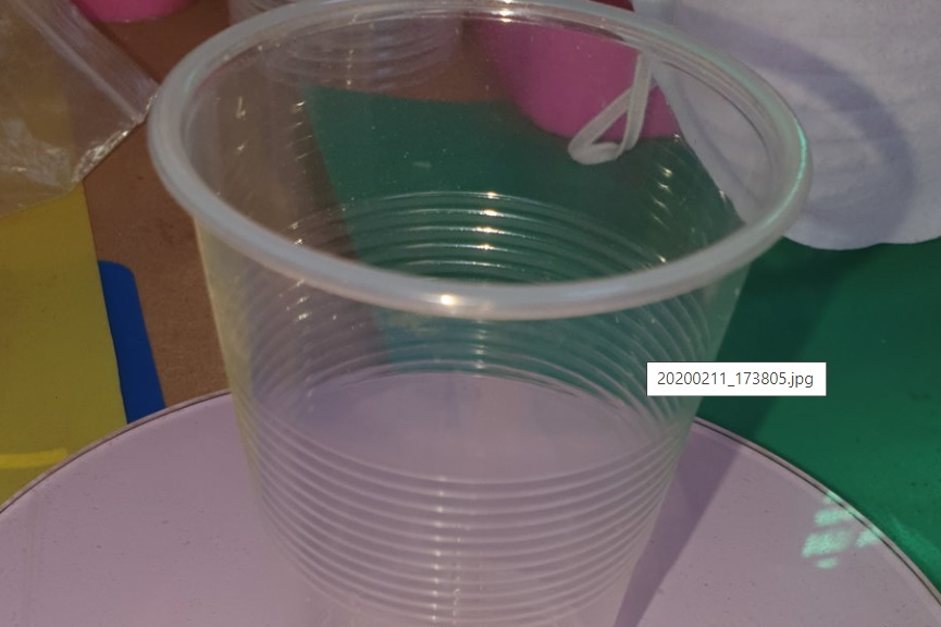

Well, I understand that may be very difficult to weigh such small amounts of powder without the micro scales but I still believe that you are using too much powder, try to cut the amount in half, on that small spoon make it level with the spoon edges, even from the pics it looks too much for the small amount of resin you're using.
I use one of those 1 litre mixing cups and I have found out that a small teaspoon just full but not too much is the ideal amount of powder if I fill that same spoon right up until it can't hold any more, I pass the saturation point of the resin and the molds take days before I can demold. In general terms, your mix is about 150 mg (part A and B) while mine is about 1,000 mg now make this test, grad a teaspoon and fill it but not excessively, put that powder amount on top of a piece of paper/plastic (make sure is wind/fans blowing into it as you will lose some now grad your little spoon and fill it with the same amount you normally do and put it next to the other pile, the resin amount difference is about 6.5 times so you need to fill your little spoon 6.5 times now compare the 2 piles, you should see a fair difference, right...?

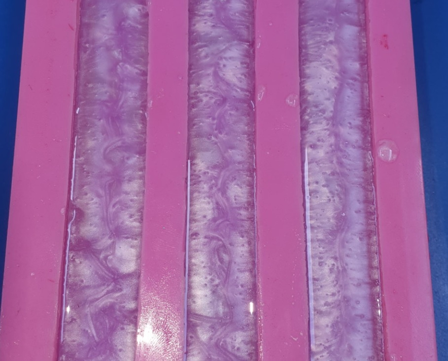

I did do a test today. One blank with no colour, 1 with a level spoon of colour, and a 3rd with a heaped spoon of colour. It will be interesting to see which ones bend and which don't when we turn them. I will keep you updated with that one.

As for the correct amounts of the opaque pastes I would be very careful, it doesn't take much to achieve the full colours so, I would start with a small portion and then add a little more if necessary, in fact, saturation is easier to achieve with the liquid colours, paste or no, some resins don't like liquid pigments so again try small batches until you are comfortable with the results.

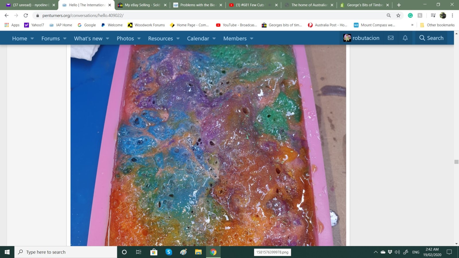

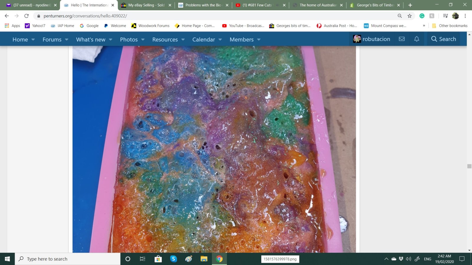

I just did another test. Bought some acrylic paint and decided to try that to colour the resin. I decided to try and recreate an Opal block i had made last year. Poured about 1/3 of 6 shot cups with resin for the colours, the rest was tinted with micropearl.
The colours mixed well and looked very nice (only a tiny drop of paint was used).
The micropearl resin got to temperature (about 15 minutes), so I poured it into my block mold, then started to drop the colours onto it, hoping it would sink somewhat to the bottom, then i would softly swirl it, as I had done previously.
Well, the pink was dropped on first, and it just sat there! I poked it with a paddle pop stick, and my micropearl resin had gone hard on the top!
I managed to poke a few holes in it, thinking the colour might seep through and maybe I would get something usable. Dumped the rest of the colours onto it and poked a few more holes......Suddenly I had this!
VOLCANIC reaction!! Not sure if was the paint, or if I had not cleaned the mold properly, but I have never had resin go hard on top as quick as this micropearl did, and never had this reaction before LOL It is crackling away in the shed and I will demold it later tonight or tomorrow.

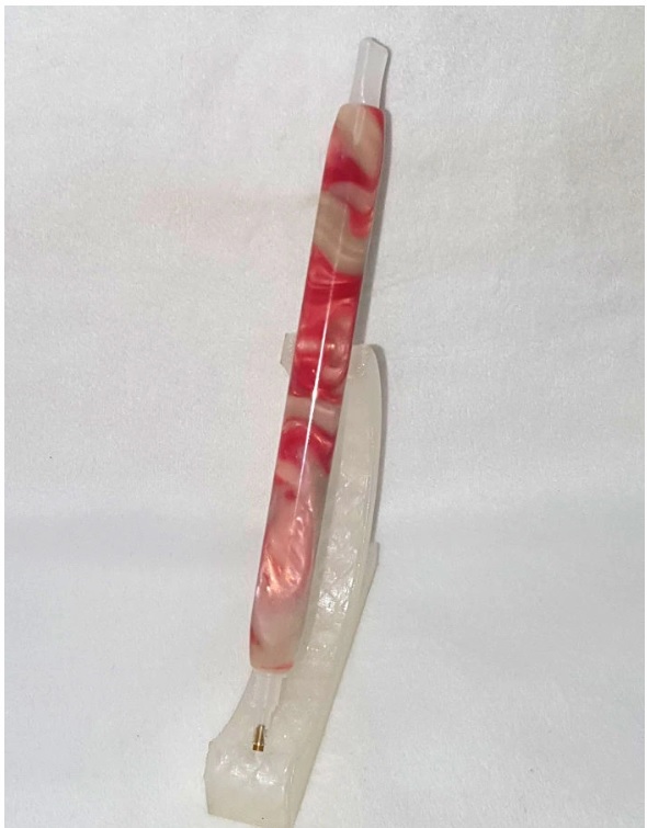

Ok, yes I think I understand what you are meaning with the care of the pen after sale. Most keep their pens at home as that is where they work on their canvas. Most of these pictures can not be transported, so they are an at home craft.
I do not know how I will cope with the smell of polyester resin. I just today bought a pack of these to try while sanding, as the paper ones are not really that good. Not sure if they would keep the smell out though, plus we keep our workshop locked all the time, as it is quite a way from the house, and do not want anything to disappear.
I honestly am not a fan of the tubes in pens, especially when doing transparent ones. You really don't want to see a brass (or white painted) tube inside a beautiful clear cylinder. I did look for clear tubes, but was unable to find any.
Does the UV resin have a smell? I really do not know a great deal about resins, and was researching what would be the best to use when my (now ex) business partner called AMC to inquire about what they thought would be best. Obviously they said the bio casting resin, so she bought the largest kit she could and had it sent to me.
If you are thinking it is a combination of too much pigment and no tube for stability, then maybe I need to think about trying a different resin.
Do you have any you can suggest?

LOL IF they are even usable. I don't think they will be. Live and learn. Never know if you don't try right?

You may maybe able to salvage them but you need a pressure pot, simply put them back in the mold and fill with clear or any other colour you wish, with luck the pressure will fill all those air pockets and turn them solid/usable

First of all and before I forget, no, using the pressure pot won't change the fact that epoxy resin is particularly sensitive to heat on unsupported blanks/pens, etc. the next time you have a 40C day grab one of your pieces or blank and see how much it will move just by using the pressure in your hands.
Its a lot more to casting that some people may realise, allergies is a big one, polyester affects a lot of people and yes unless you are working in a well-ventilated space/area you need a respirator with single or double chemical filters, the ones you purchased today are merely dust masks.

I believe the problems you have been having of not curing/hardening properly and not shinning enough those are all result of excess powder in the mix and that can happen with any other type of resin.

I generally pour enough resin to make 3 single blanks at a time. Each blank holds roughly 54g of resin, so the most I would mix at once is 162g. I then divide this into smaller cups to add the colours I've chosen.
So for this it would be 1.62g of catalyst if my calculations are right.

Thinking about the amount of powder put in the mix, I did a lot of research, and from everything I read, it says that you can safely add 6% of your resin weight in colour. 6% of 50g is 3g, and I do not put anywhere near that quantity in my pours, so I am leaning toward the problem being that this resin needs stability. It needs to have the tube in for that, and we are not using tubes, so each pen fails. If I were turning traditional pens, 2 halves with a tube in each, then I would not have this issue, but mine are different, and the only way to put tubes through the middle, is to pour with the tube in the mold. This will then eliminate me being able to do swirls or multiple colours, and also gets me back to having to introduce heat to the ends with needing to ream out the holes to accommodate the tips.

I don't know where you read about the 6% colour in a mix that that ain't right. not even close, I would be more inclined to 0.6%, imagine me adding into a 1 litre (1,000gr) resin 6% of powder that would be 60gr the average weight of a full Pearlex container is 21gr, do you thing that 3 full containers of powder in a single 1 litre resin sounds right...? not at all...!

Oh, and I have received your blanks this morning, it looked firm enough or normal for epoxy but I will do a few tests and let you know before I return it to you...!

You are using far too much powder and that has become clear over our conversations and as I said before, you have the exact same risk of reaching liquid saturation regardless of epoxy or polyester so and as I suggested before, start with half of the amount you have been using and go from there and remember if you are going to use solid colours pastes you won't get any pearl effects and even adding white pearl to the mix may not produce the results you want, again experimentation is necessary.

I may have a solution to my problem, and not have to change the resin after all.
I was explaining to my son's girlfriend why I can't use the blanks I just made, and saying how I needed to have a tube through them to stabilize the pen, which then meant having to ream the ends again to make the hole large enough to fit the ends.
I said I couldn't do translucent colours, because you would see the rod, and my son asked why I couldn't use a piece of plastic tube. Then a lightbulb must of gone off, because he followed that with "or why not 3d print a rod to the size you need".

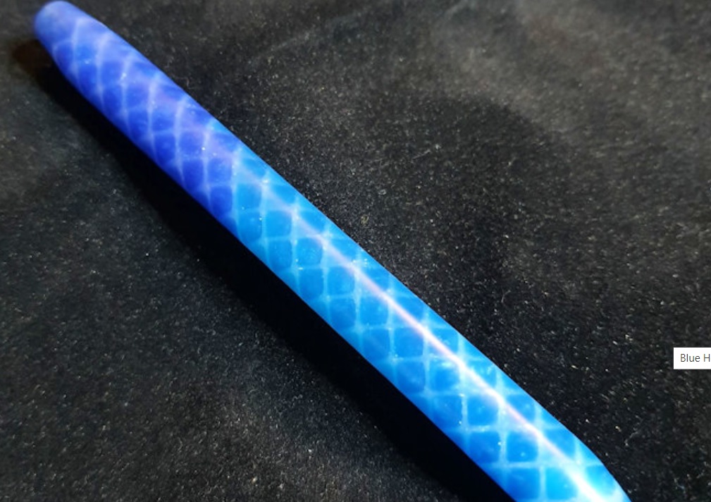

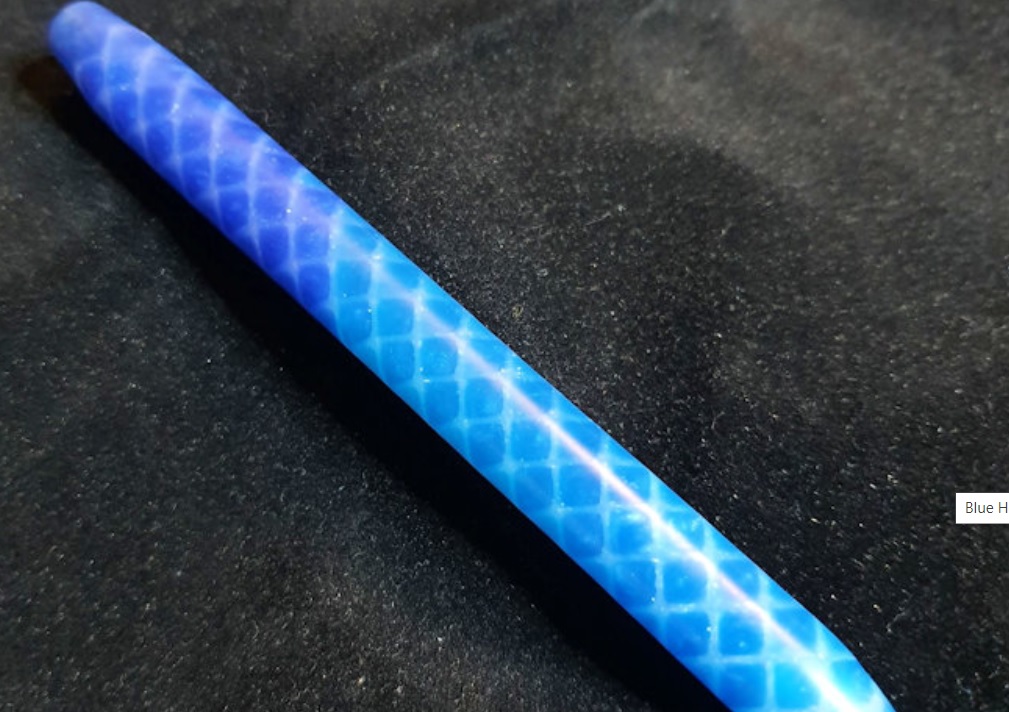

I have used 3d printed inserts in my blanks, and does work. By using translucent filament, you would barely be able to see the rod in the center. I could also make the rod to fit the pen ends perfectly, so no need to have to ream the ends.
I am going to give this a try. Will take a few days, as I have to draw up the design for the rod first, then print it, but I am hopeful I might be on a winner here.
Doing swirls around a tube will be a challenge, but I like a challenge, and if there is a way to make it work, I will find it LOL
This was made with a diagonal insert I 3d printed in translucent. You can hardly make out the lines between the colours.
And this was made with a honeycomb insert
