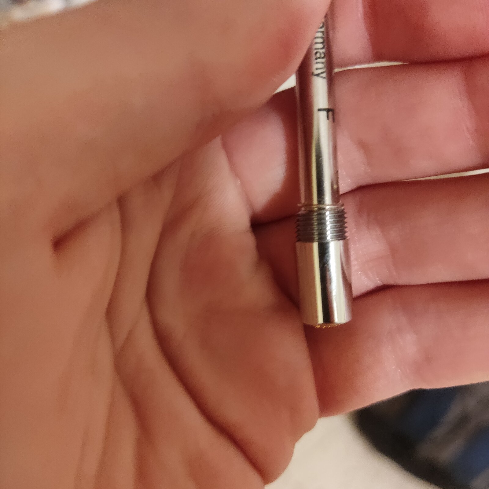

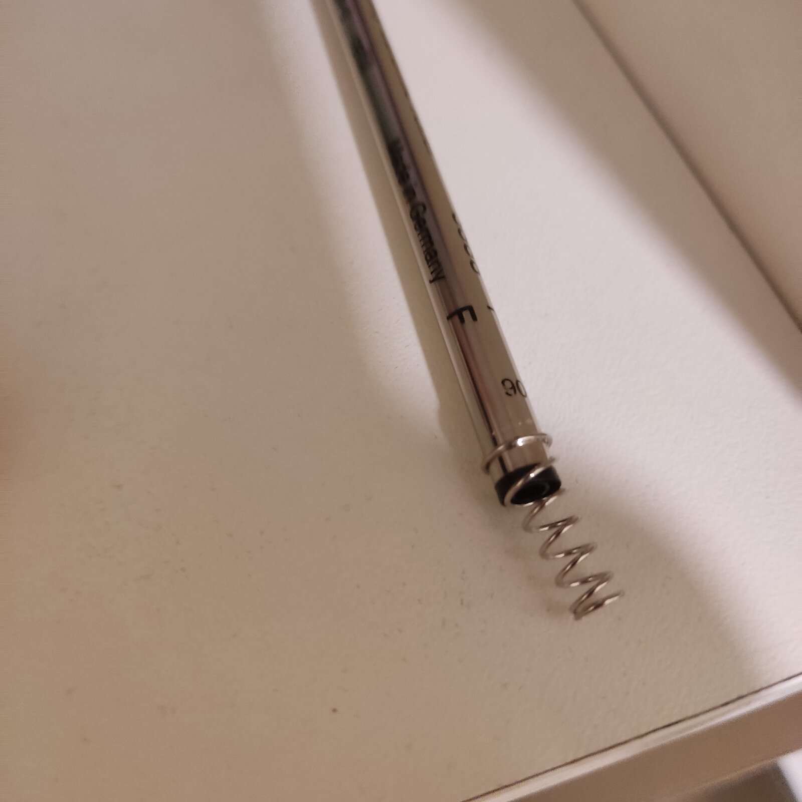

Hi,
I have a problem with the Jr. statesman rollerball pen kit from Dayacom (the postable version).
The spring and the Schmidt 5888 refill don't quite fit in together. I have to push the refill very hard into the spring and then tighten the end of the pen very hard, something that I suppose shouldn't happen.
I tried to cut the upper part of the spring, without much success. Springs are apparently very hard to cut!
I also tried to assemble the pen the opposite way without success as well.
What can I do to solve this issue? Thanks!

Looks like you have the spring upside down. I'm pretty sure it is not supposed to slip over the refill.
Tried that already. It won't go the opposite way. the spring is to wide on the opposite end.

Just as Mr Vic said, the spring does NOT go AROUND the refill.
The spring fits internally BETWEEN the end of the refill and the INTERNAL END of the metal finial cap.

The spring that you show in your picture above appears to be about the right length but not the right shape.
If you take it off the refill (as shown in the pic) it could work as it is, but I can't really tell for sure.
But make sure it goes BETWEEN the end of the refill and the metal finial cap INNER end surface. . It might just work like that.
There might be a little alteration in shape that you can do . . but be very careful in doing it.
The alteration I am thinking of is to twist one end a little narrower (to contact the end of the refill), and expand the other end a little bigger to contact the inner surface of the finial end. Making the upper end bigger will give it a little more stability when it becomes compressed by your assembling the refill-to-spring-to-finial-end. . Otherwise there might be a tendency for the spring to "buckle" and refuse to co-operate.

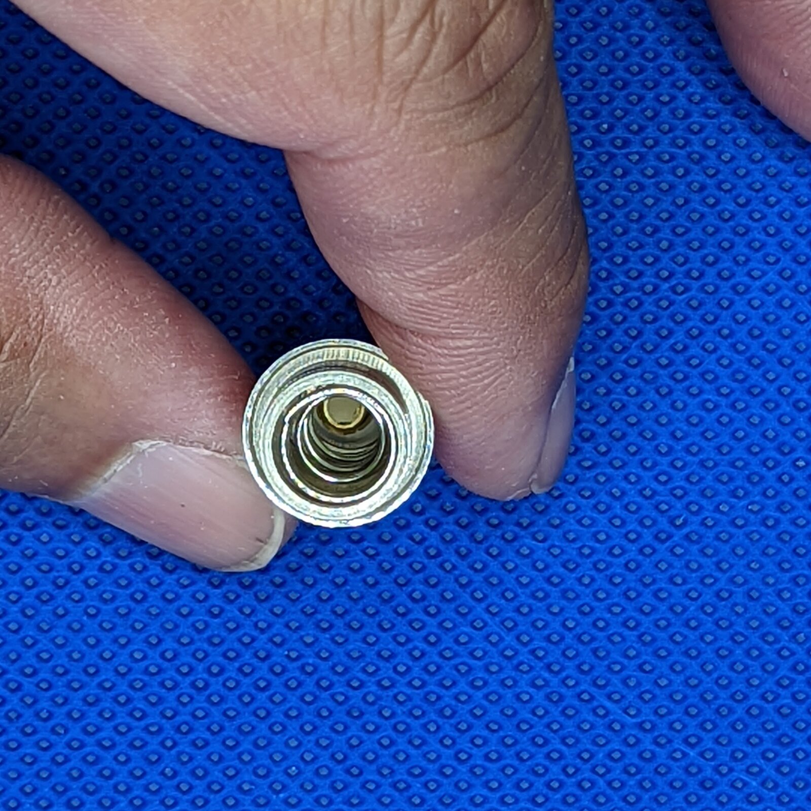

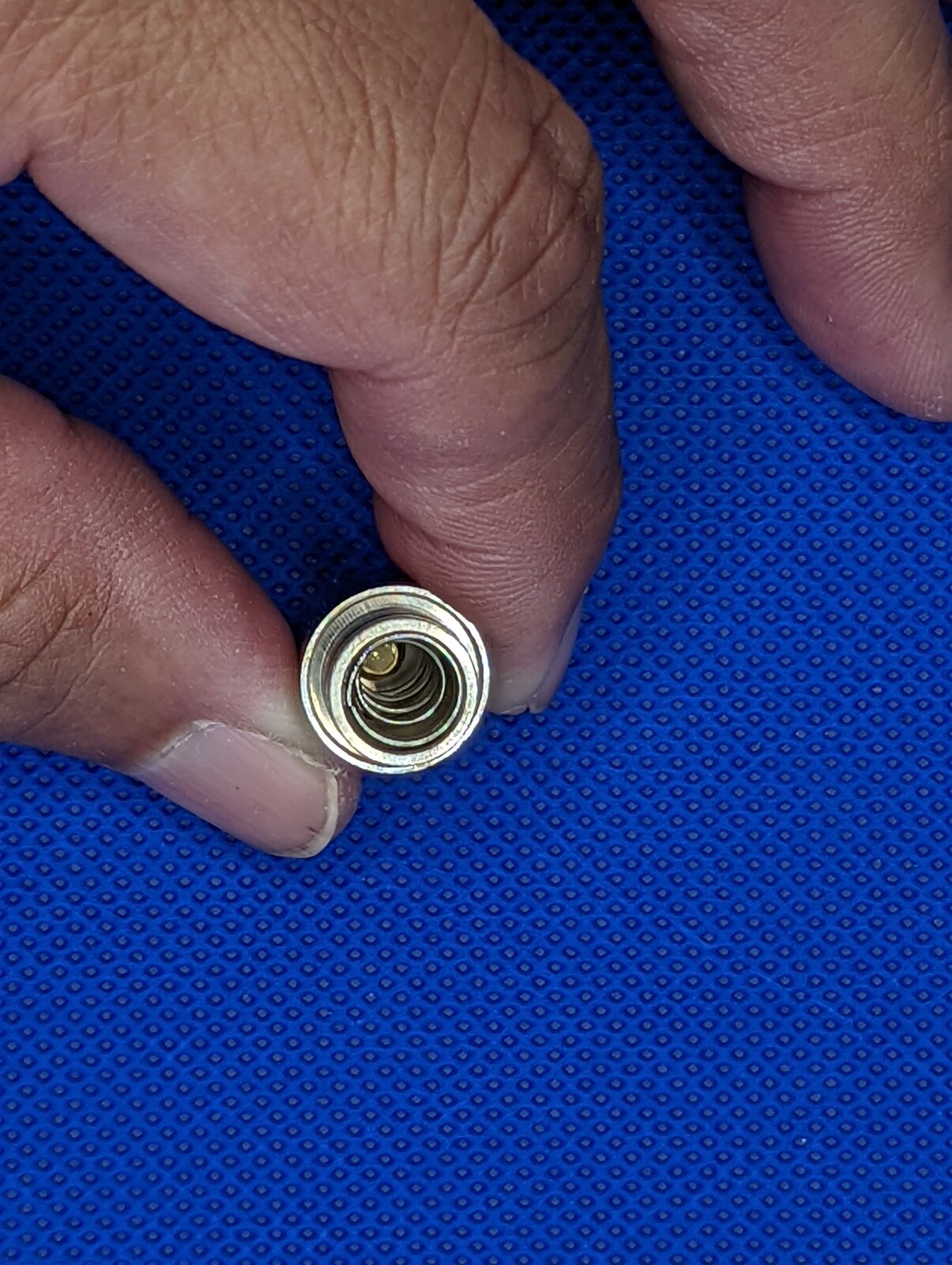

As everyone has said the spring never goes over the refill. The small end needs to fit against the top of the refill and the larger end goes in the cap. It needs to fit in just right so it bottoms out.
I have Jr Statesman postable and non postable kits I received last week and all the springs are glued in already. I snapped a few pictures so you can see what my new kits look like.

You have the correct spring. It needs to be inserted, fat end first. Because this takes some technique, I created a video demonstrating the procedure. YouTube has it as "unlisted", so you can see it if you follow this link:
