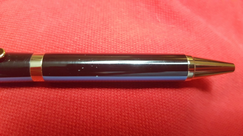

I am starting to get into turning acrylic pens. The problem I'm having is pitting. part of the pin blank when I'm finished sanding and buffing there are little pit marks on part of the pin tube. Any suggestions?
Sounds like maybe the blank is chipping off small hunks due to a dull tool or aggressive cut. Then during sanding these small chips don't get fully removed.
If you have a picture of this pitting it might help to identify the issue.

Here's a picture I hope you can see what I'm talking about.

I don't have a ton of experience by have made plenty of mistakes. If it were my pen it would be what Doug pointed out, chipping of the blank. Guessing that because pits are irregular shape (not casting bubbles) and kind of in a band around the pen.
I tend to get these if I change angle slightly while turning either as I shape the blank or move my hands. Things that help me is to "ride the bevel" of my Skew more as I get close to the final shape and move my body instead of my hands/arms as I move across the blank.
If you are using carbide (which I have less experience at) try more of a cutting angle and not a scraping angle. Some resin does not like carbide as well so lighter, angles cuts.
You'll get past that. I think it's a matter of touch. Use sharp quality tools. Slow and light pressure as you get to the end stage to turning the blank.
Hard to say.
I do know that rhino horn and other horns will pit like that.
Take VERY light cuts.
Also try to keep the cutting edge at or above the centerline of blank. This happens more with inlace acrylister vs AA. You can clean the blank well and fill the pit with a drop of medium to thick CA and let it dry. Skim with A sharp tool and re-sand and polish.
What he said ^
Ed of Exotics has an excellent video on turning acrylics on YouTube
In my very limited experience, all of the above advice is spot on. The type of acrylic and tool used may be helpful for more precise advice. As many have said, when I get those pits it is typically too aggressive of a cut...I'm not very patient and want to see the finished pen too quickly!
If when you turn you hear what sounds like ripping and getting covered in tiny chips or flakes instead of long ribbons of plastic you are too aggressive, using dull tools, presenting the tool wrong and stuff that isn't coming to mind. :rolleyes: When you get it right the barrel will be smooth requiring very little sanding and the shavings will be like fine ribbons or hair. Practice with inexpensive blanks turning, them to nothing, that you don't care to make a pen from.
Only living across Indy from WoodTurningz I started out on Inlace Acrylester. Glad I had a face shield on. First few I thought ripping the corners off in a rain of shrapnel was the way it was supposed to work. Then watched some of Captain Eddie's videos on sharpening, read some things on here about turning IA and now love it, normally turning the entire thing from square to finished with a sharp Skew. Though I can now use carbide to finish (just because the guys at WoodTurningz said not to try using carbide on it). Beautiful shine.
