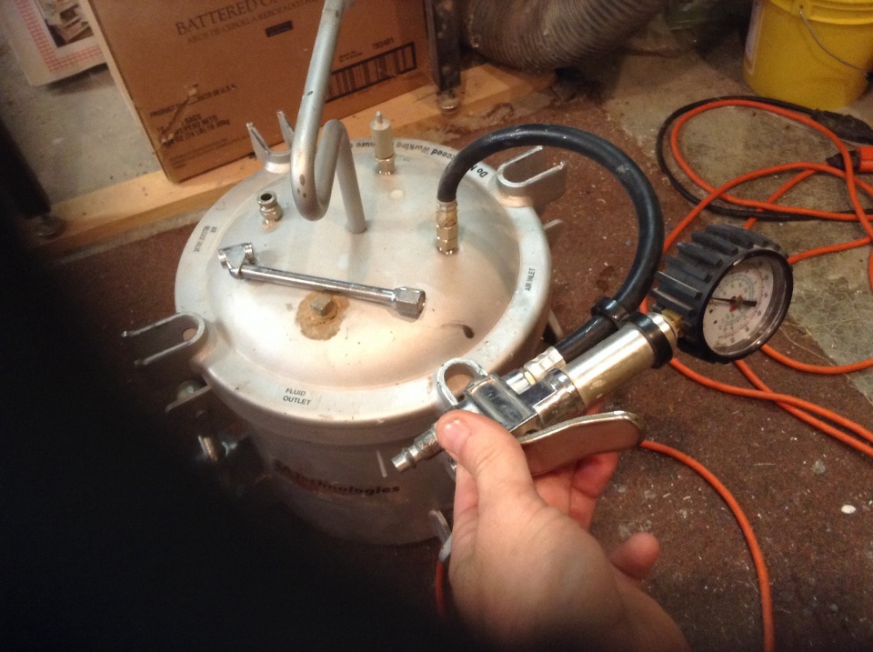

At harbor freight you can by a tire filling attachment for $8. It has a trigger, a guage and a hose with a long metal piece on the end that you stick on the tire valve. You remove that tire piece off the end so you just have the hose, guage and trigger. That hose is already the right thread size on the end to fit your lid so just teflon tape and screw it in. Put a 50 cent quick connect on the other end, done. Now you just uncouple your airhose it wont leak, the trigger is a valve. You can use the trigger to remove the air from the pot too. Cheap fast easy.
Here, i took a photo. Its so simple, the pot conversion is $9 total, the tire filler guage, quick connect and a plug. Been using this system on all my pots for years. I set the tire filler piece i removed on the lid, it was on the end of the hose. Every piece that came with the pot except the pressure valve is in the trash can. Less parts is less chance for leaks. Attach air hose, squeeze trigger, guage tells the pressure, pop off the hose or not doesnt matter. After done squeeze trigger will release the air too.
