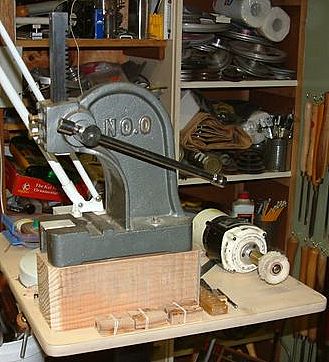

Bearing Press 1 Ton located at eye height alongside the lathe. Fitted an Aluminium block on the lower part with thin Corian top and bottom. Works great for me.
Immediately behind it is avariable speed driven small Buff.
Regards Peter. I agree with Ed.

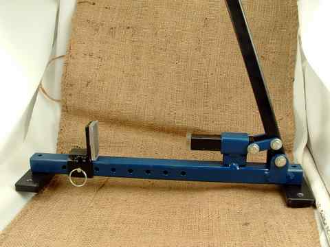

Here is the one Paul Huffman made for me about 3 years ago, It's been used , used and then used with no problems
